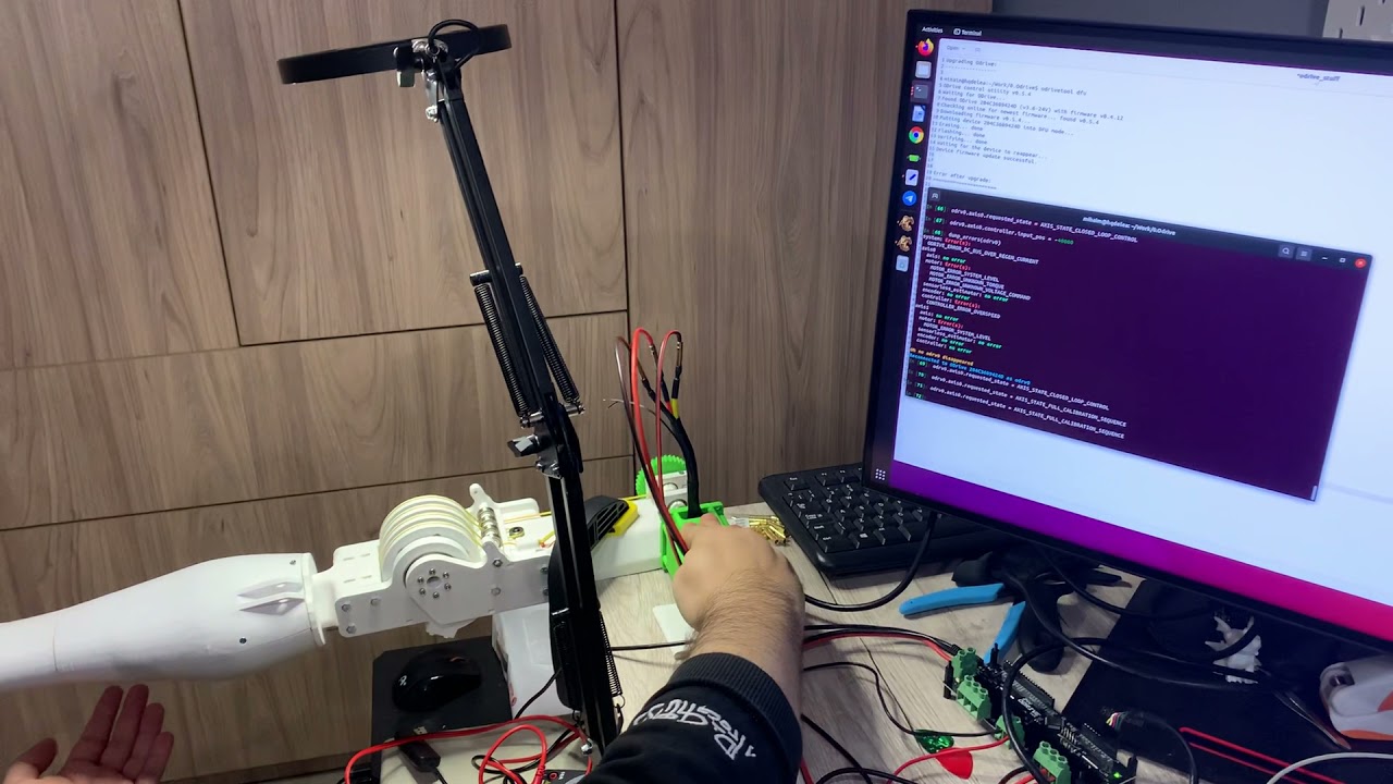

i have a project with odrive moving a robot arm . Everything looks great . However i have a problem .
After i attach some load to the robotic arm ( like 100 grams or so ) calibration sequence runs ok . and after that moving the arm to a position works for 1 second or 2 seconds and exists AXIS_STATE_CLOSED_LOOP_CONTROL
Any idea what might be wrong ?

If you are using incremental encoders, you need to run the calibration WITHOUT load attached. If the calibration has a load, it will not calibrate properly.
If this is a problem for you, then you need to set up index search or use absolute encoders.
I don’t think it’s doable to reconnect the robot arm after each calibration.
i made a video with the behaviour:
The overspeed error may be just that - have you checked that the controller.config.vel_limit is set high enough for the movement you are trying?
Also, are you using any ferrite rings for the motor? If not, then noise from the motor cable can cause spurious encoder counts that could trigger the overspeed error, and it can also cause spurious regen current errors.
What are your brake resistor settings?
You could set it up to allow a small amount of regen current, but set the overvoltage ramp mode on the brake resistor to clamp just above your power supply voltage - this should be more robust to spurious errors caused by noise.
First, towen’s recommendations are all good.
Then you’ll have to use the Index pin or an absolute encoder instead.
I think you’ll be fine once you get your settings correct. My arm looks substantially heavier and I can calibrate at the shoulder.
