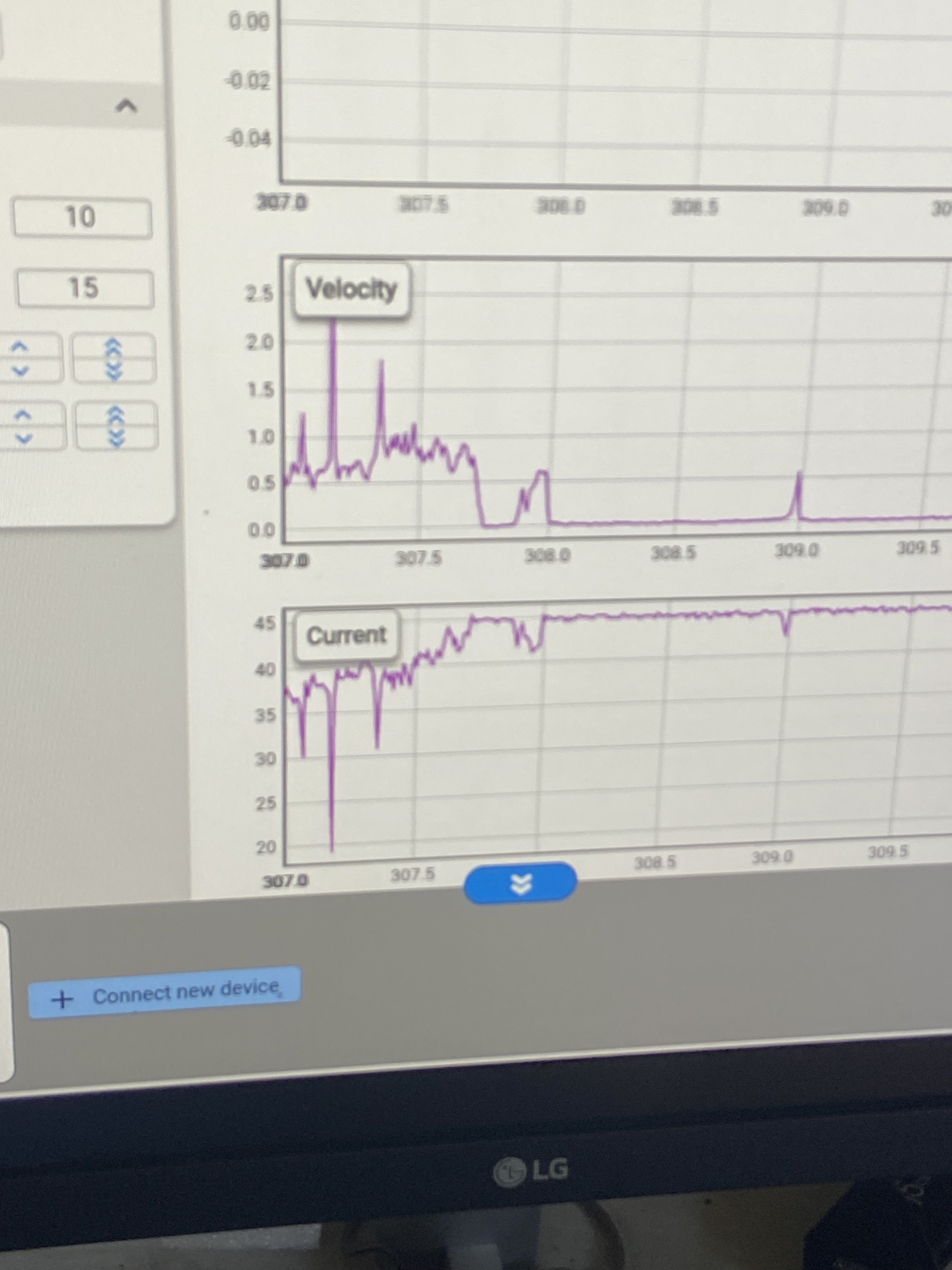

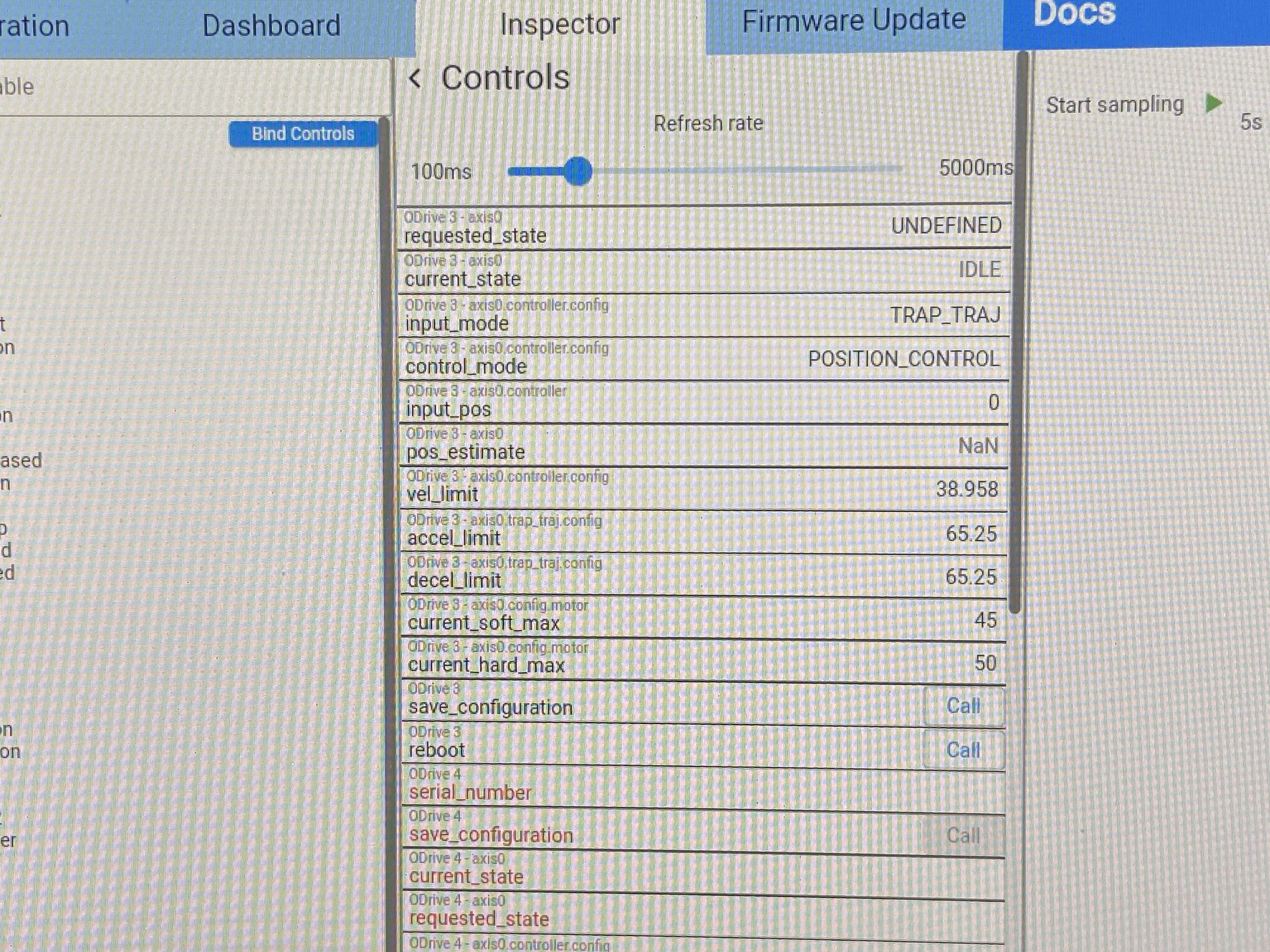

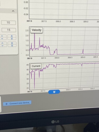

When I am controlling motor from inspector, I can key in 45a as a soft max. And I get the associated torque from that value.
But when I save the configuration and operate the motor using the the custom controller we developed, Odrive GUI caps the current at 20a and my torque suffers.

Hello Solomon. Thank you for your attention. I believe I gotten a little closer to the truth. Its actually a power cycle that causes the current limit to revert. It doesnt have anything to do with my CAN micro controller

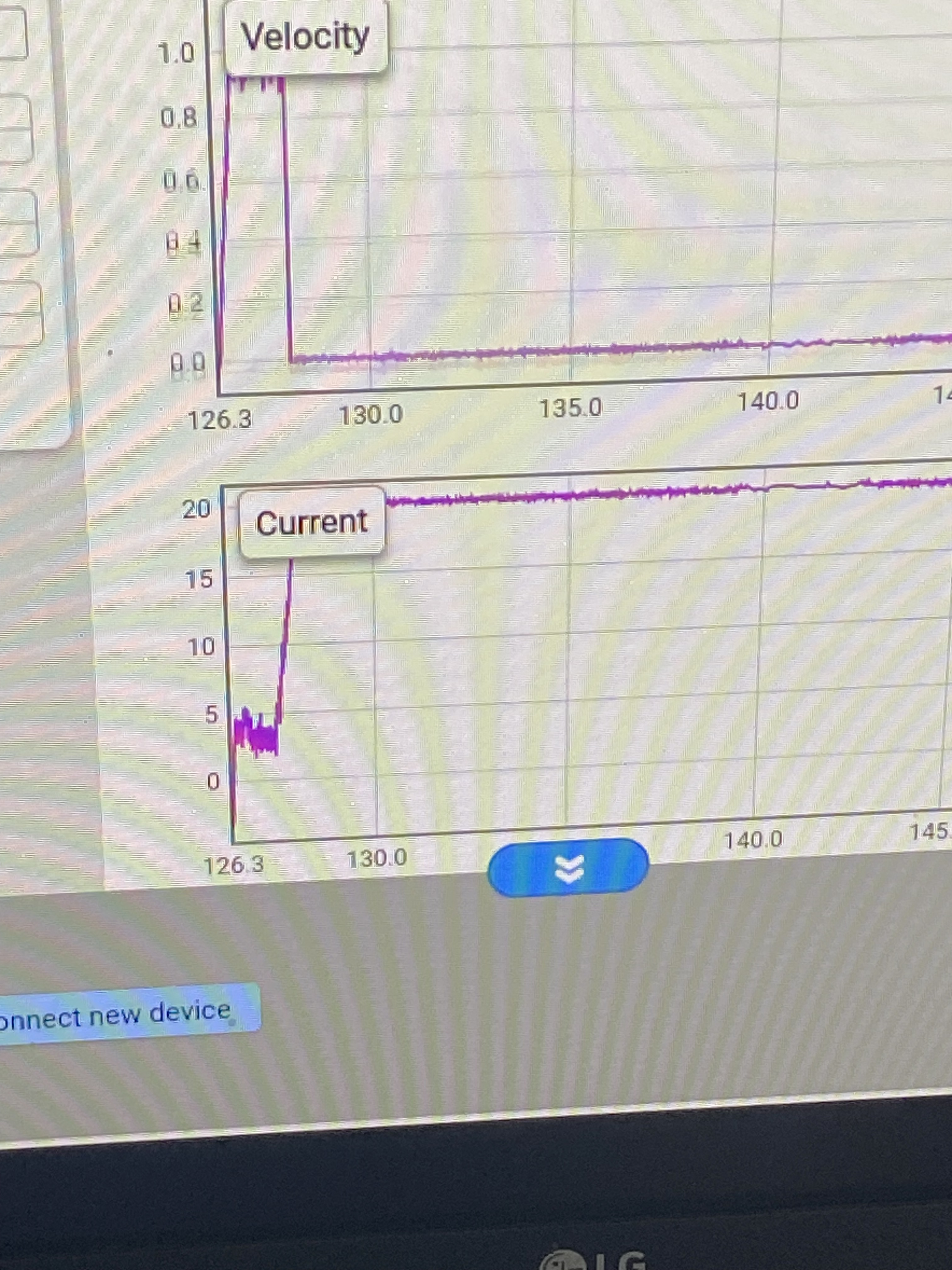

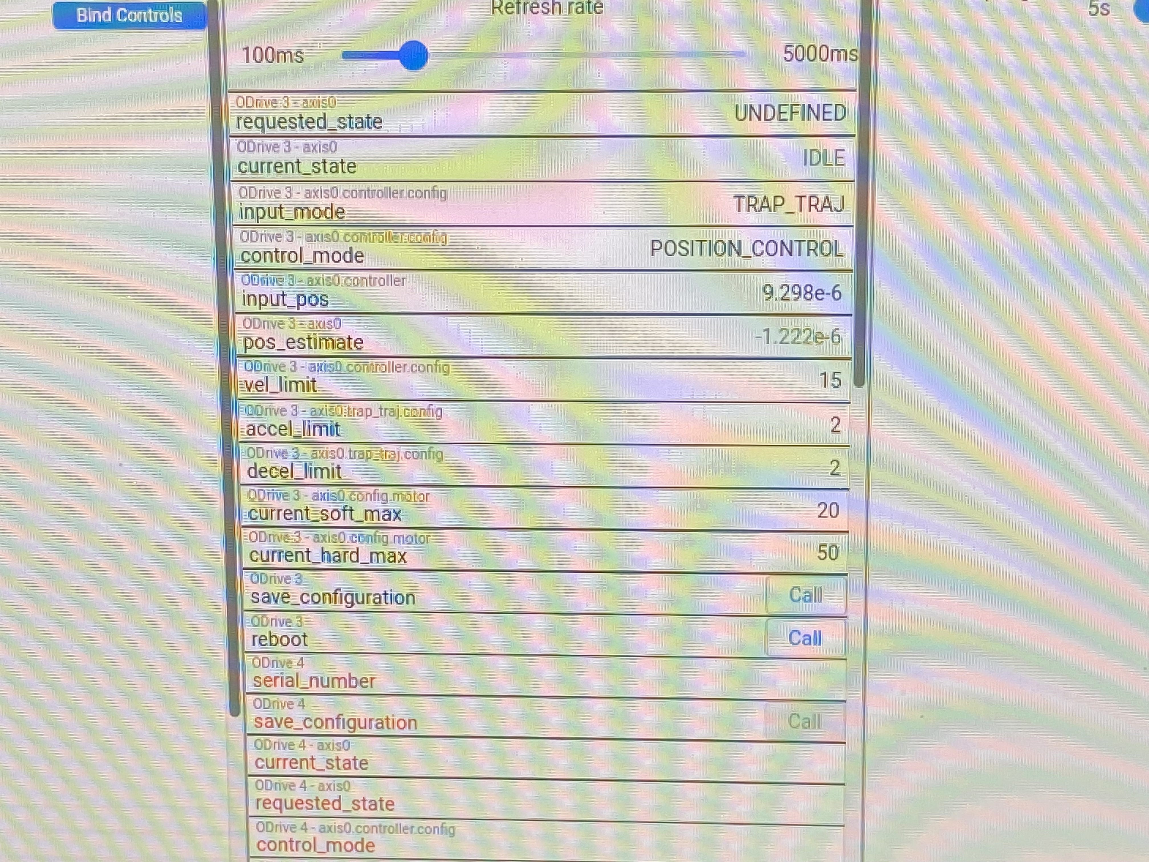

But yes you are correct in your understanding. I set the current limit to 45 amps. Save configuration. Go to position control to visually observe the current draw which is 45a and plenty of torque.
Save once again(or not), cycle power and reconnect and in inspector I see that the soft has auto-adjusted to 20amps. I go i to position control to once again get a visual and it is indeed drawing 20amps

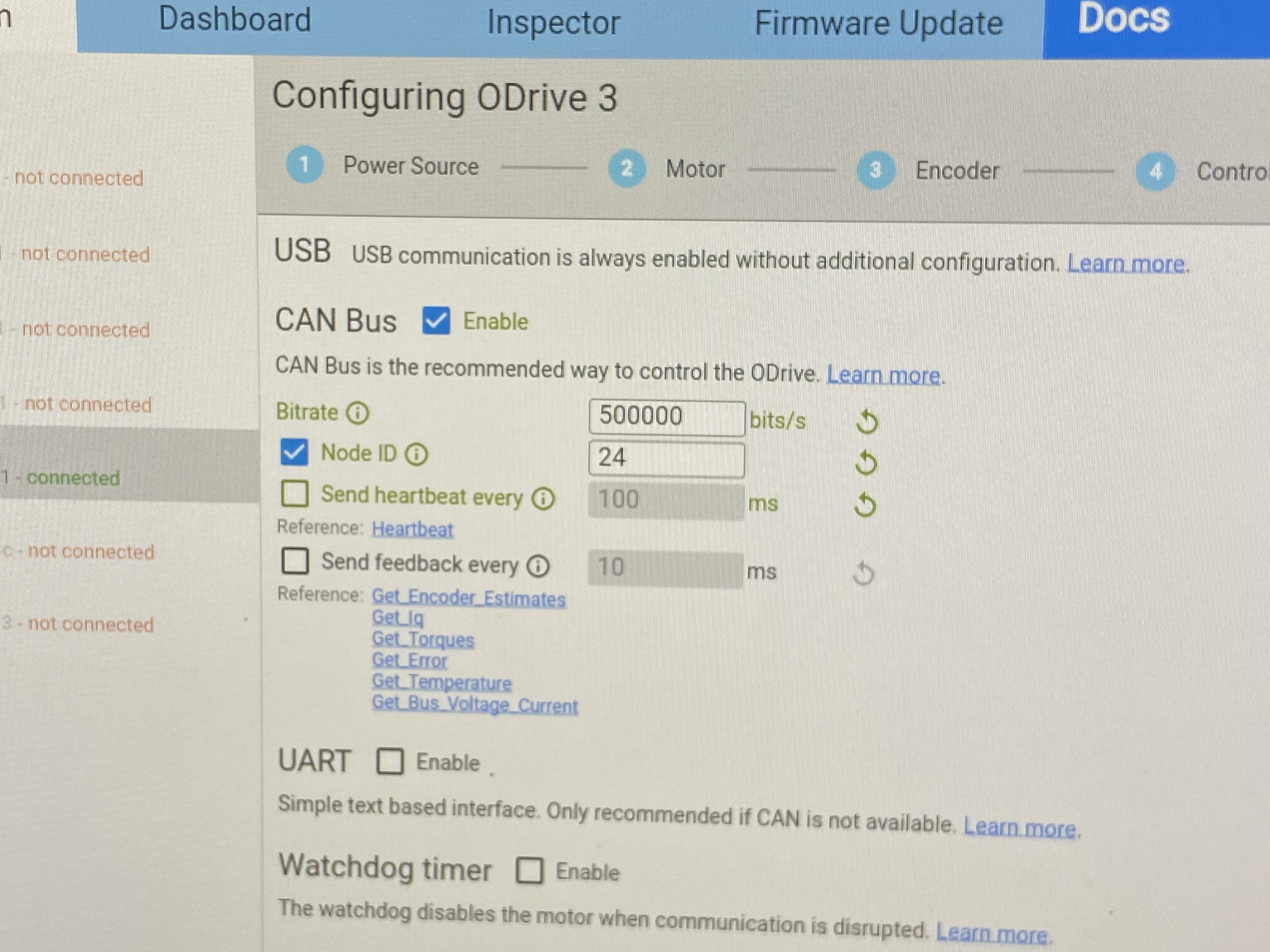

I am trap_traj input mode and position control control mode with CAN bus microcontroller
The motor is a 5065bldc, power supply is 24vdc 1000w, AMT212B-v-od encoder
That’s quite weird. Could you let me know your S1’s serial number, and what firmware version it’s on? You can see that in the bottom left by clicking on the ODrive device:
One other thing – when you run save configuration, the ODrive must be in idle – if it’s in closed loop control, the configuration will not be saved. Saving the configuration will actually cause the ODrive to reboot (and disconnect/reconnect), which is a good way to know that the save worked.

Interesting, can’t see anything that explicitly points to the issue you’re having. Could you try seeing if you can replicate the issue after a firmware update and re-running the configuration steps?
Something you can try first, very simply, is just:
  • Start with the ODrive only connected over USB, not over power
  • Open ODrivetool
  • Query odrv0.axis0.config.motor.current_soft_max (should be 20)
  • Set odrv0.axis0.config.motor.current_soft_max = 45
  • Query odrv0.axis0.config.motor.current_soft_max (should be 45 now)
  • Run odrv0.save_configuration() (ODrive should disconnect/reconnect, you’ll see the LED on the ODrive turn to orange and then back to blue)
  • Query odrv0.axis0.config.motor.current_soft_max again, and we can see if it’s 20 or 45.
Shoo wee looks like that worked!! It saved and held across a reconnect. And then I disconnected, cycled power, and operated with the micro controller. Then powered down, reconnected to odrivetool and checked and it stayed at the keyed in current limits.
Thank you so much!
Oh great to hear! If you think you know what the issue was originally, would be super good to know that for the future, but no worries if this is a mystery issue as long as it doesn’t come up again :slight_smile:
Well I am def not the guy who could work that out… But it is consistent whatever it is.
