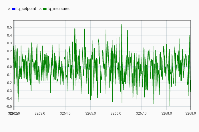

The current limit violation looks like this:
Since the last time I posted, I’ve tweaked the PID loop a bit. I noticed on the Odrive website GUI graph that current would spike to 15 A from only a bit of torque applied by hand. I tweaked the PID loop and got it to only spike to 2 A with this same torque applied.
At higher speeds, the ODrives do not produce the current limit violation error anymore, however, when climbing rocky terrain it still produces the error.

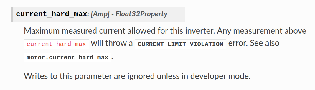

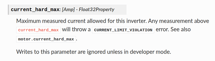

Hey solomondg, I would like to re-open this old topic as my team is still encountering the current_limit_violation error. We have tuned the velocity PID to where the motor controller has become decently reliable.
We had attempted setting current_hard_max to infinity, and still encounter the error. Looks like there is a current_hard_max for the inverter that also throws the current_limit_violation error. Pretty sure this is what we are actually hitting. We are unable to change this value without the firmware set to developer mode. We also set the encoder bandwidth to something higher, and still encountered the issue.
Regarding the low resolution hall sensor, we really only need to move forward, backward, and skid-steer with velocity control, and adding a separate external encoder will require a change on the wheel mounting design (Which we can do if it is absolutely necessary).
Additionally, I have greatly reduced the current_slew_rate from default 10,000 to 50 and this has not helped either.
Wondering if we need to change the FOC controller gains to relax the current spikes?
https://docs.odriverobotics.com/v/latest/fibre_types/com_odriverobotics_ODrive.html#ODrive.FieldOrientedController
Also I noticed decently large current spikes while the ODrive is in closed_loop_control mode with velocity and positional gains set to zero, not sure what is causing this.
Can you run odrivetool backup-config config.json and post the resulting config.json here?
This is just gaussian noise in the S1’s current sense – it looks worse than it is because of the lower sample rate in the GUI. Looks pretty nominal/typical to me.

Hey @solomondg wondering if you could provide patched ODrive S1 firmware with developer mode enabled? Or at least a singular developer value changed. The team is working on mounting the new encoder, and working on your config suggestions, however I am very worried about time constraints.
I would like the team to attempt to set the developer-locked inverter current_hard_max (default 70 A I believe) to a greater value. I believe this is what is tripping the current limit violation errors as I have gotten this error with the user accessible current_hard_max set to infinity. There are very quick current spikes on the inverter side, that I believe the odrive should ignore. The specific value is inverterconfig.current_hard_max.
It would be very nice to have this as a last resort workaround if the team cannot fix the issue using the solutions we previously discussed.
If we cannot fix the issue, we may have to move away from using ODrives. Reliability for our rover drive system is a top priority this year.
Thank you.
https://docs.odriverobotics.com/v/latest/fibre_types/com_odriverobotics_ODrive.html#ODrive.InverterConfig.current_hard_max
Hi! Lemme check this out and get back to you ASAP. Could you let me know your email as well?
I’ll email you the unlock instructions!
