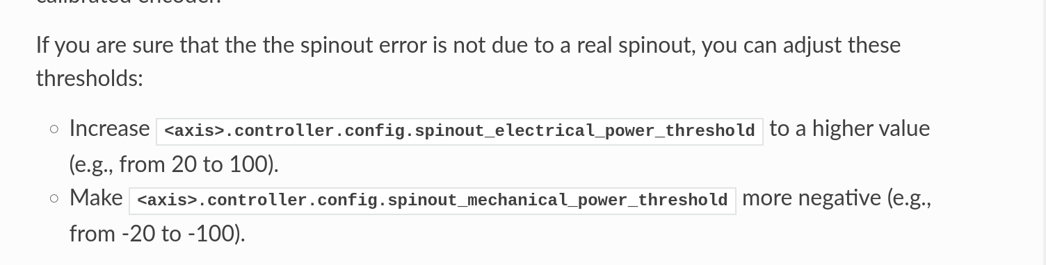

The spinout error is happening because of the rapid acceleration combined with the low resolution of hall sensors. You can see this article for more information: Controller — ODrive Documentation 0.6.11 documentation
I would recommend increasing the spinout thresholds:
You can additionally change to using trajectory control to better manage the acceleration and deceleration, which can help with both the spinout, overvoltage, and undervoltage errors.

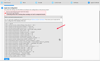

Additionally, regarding the overvoltage and undervoltage errors, those are difficult to diagnose in a vacuum. Can you please provide the following to me?
  1. Images of your wiring, especially from the power supply to the ODrive, as well as the ODrive to the motor and the ODrive to the brake resistor
  2. The configuration of your ODrive, either via a screenshot from the GUI python commands output, or by running odrivetool backup-config config.json and then pasting the config.json file here.
If you have ODrivetool, then the odrivetool backup-config config.json method is much more preferred.
