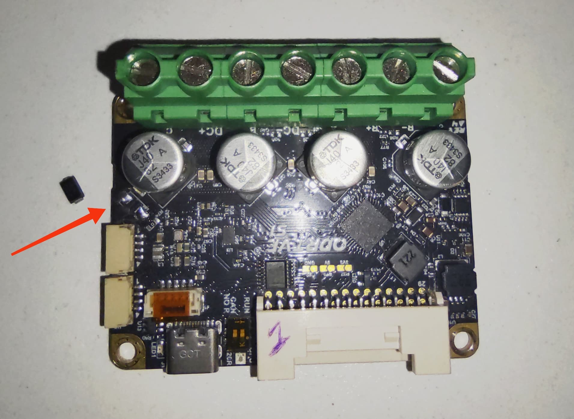

Could anyone help me identify the D8 diode on an ODrive S1? I believe it may be a Schottky rectifier, possibly the St STPS2L40, but I’d like to confirm before ordering a replacement.
I’m repairing my ODrive S1 after a reverse-polarity short circuit.
Visually, only the D8 diode appears to be damaged. I checked the MOSFETs, and none of them are shorted. After removing the burned diode, the ODrive powers on normally.
I haven’t tested it with a motor yet because I’d prefer to replace the diode first. Has anyone identified this component or experienced a similar failure? Any advice would be greatly appreciated.
