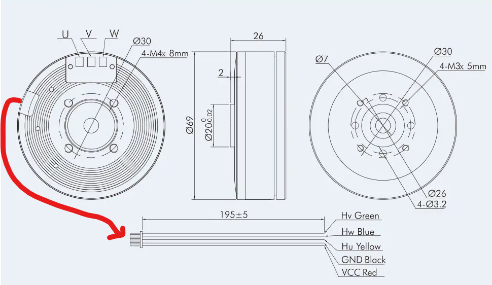

I am using ODrive S1 to control a CubeMars R60 motor (motor link: https://www.cubemars.com/product/r60-kv115-outrunner-torque-motor.html) in a pulley gear system.
Brief Overview of the System:
The system has two transmission stages. The first one is a pulley attached to the motor with a timing belt (transmission ratio 4.8). The second stage is a gear system with a transmission ratio of 5.625, so the total transmission ratio is 27. I am using a torque sensor to measure the torque at the output. I am using passthrough torque control in ODrive S1, not the ramped one (based on my application requirement). I am also using the enable pin to make the ODrive go into the active state.

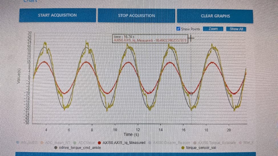

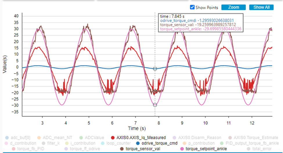

Problem Faced in Sinusoidal Torque Control:
Summary: The torque tracking is not symmetric in the sine sweep if a larger torque is commanded (it is symmetric in the lower torque case). Also, it produces jittery current values in one direction of the sine sweep, and at that time, the motor makes a weird R2D2-like sound. FYI, I calibrated the torque sensor, so I am sure it is working fine. Details below.

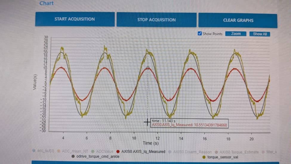

I commanded a lower torque, 0.75 Nm to the motor (20.25 Nm at output). The results are listed below:
#Color legends: Grey = Output commanded torque, Green = torque sensor value, Red = ODrive measured torque producing current (Iq).
Highest Peak:
Torque Deviation: 4.8% overshoot
Current value (10.55 A) matches the commanded motor torque (0.75 Nm) and torque constant (0.072) based current (10.42 A)
Lowest Peak:
Torque Deviation: 3.13% overshoot
Current value (10.49 A) matches the commanded motor torque (0.75 Nm) and torque constant (0.072) based current (10.42A)

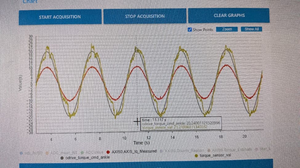

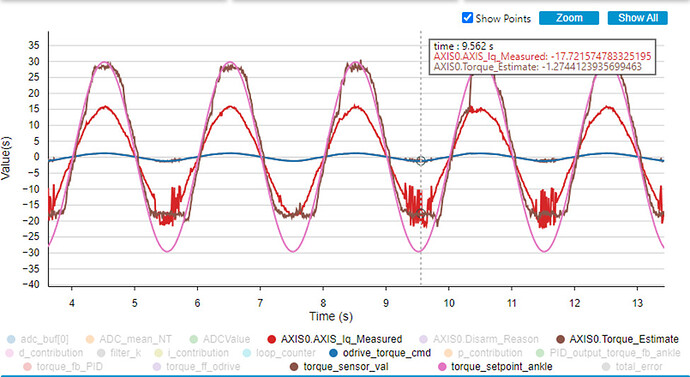

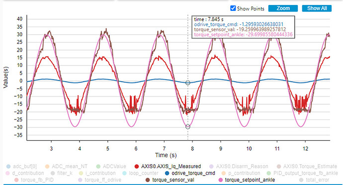

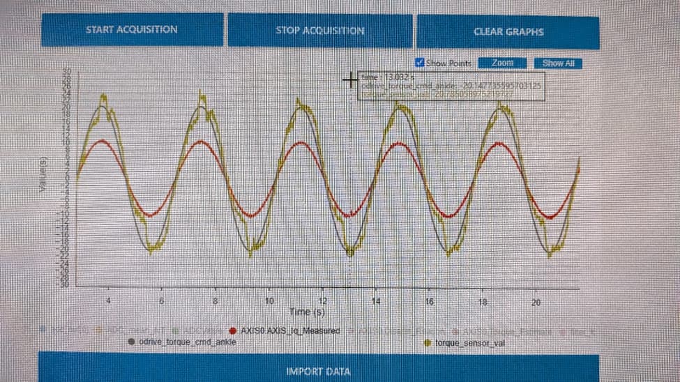

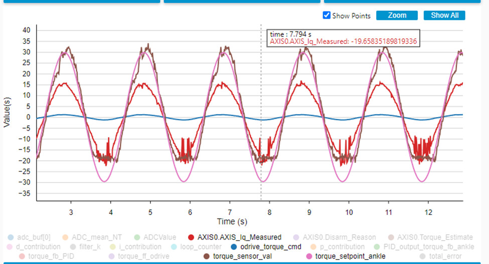

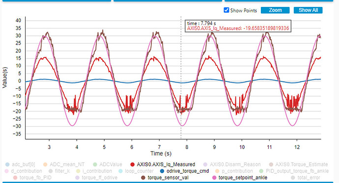

Then, I commanded a larger torque, 1.3 Nm to the motor (35.1 Nm at output). The results are listed below:
It creates jittery current values and weird motor sound at those jittery points.

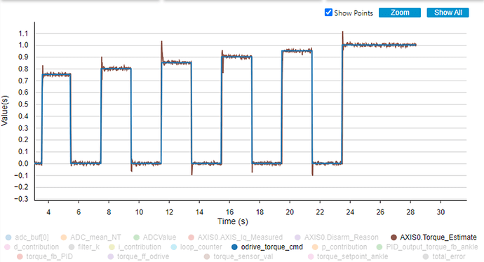

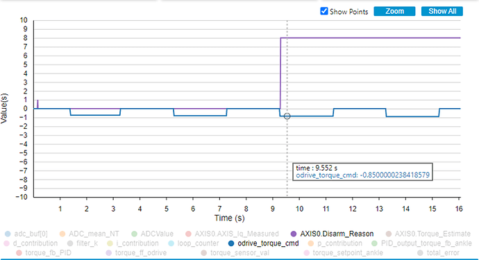

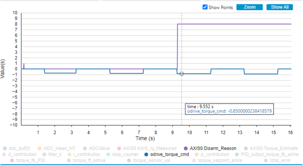

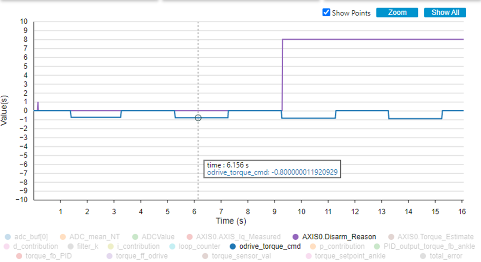

Problem Faced in Step Response Torque Control:

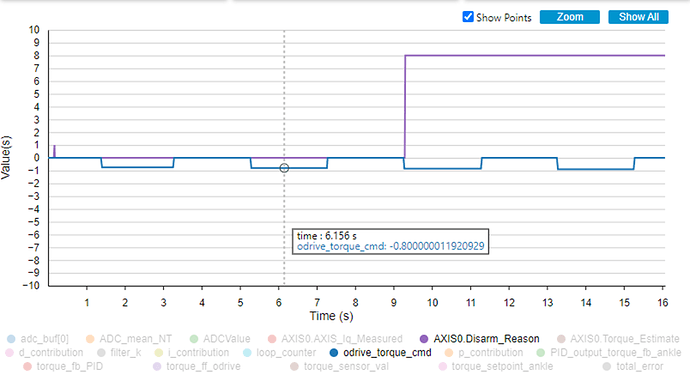

#Color legends: Blue = Output commanded torque step, Purple = ODrive error code (disarm reason).
If I command any negative step input beyond 0.8 Nm to the motor, ODrive shows error code 8 (missing encoder estimate error). The step torques start from 0.75Nm, then increase in the following sequence: -0.75–> -0.8–> -0.85–> -0.9 Nm.
No error at -0.8 Nm step input.
Error code 8 at -0.85 Nm step input at motor.
If the step torque command is on the (+)ve side, then this 0.8 Nm threshold does not produce error code 8.

Hi there!
Immediately upon reading this, I assume that you’re encountering torque-mode velocity limiting. When enable_torque_mode_vel_limit is set to True, then allowable torque will be reduced as the motor approaches vel_limit at a rate of vel_gain Nm/rev/s. See here: Controller — ODrive Documentation 0.6.11 documentation
However, the MISSING_ESTIMATE error is likely something else, which we should look into. Can you please make sure you’re running firmware v0.6.11 (or newer), and send the value of axis0.detailed_disarm_reason after you get this error?

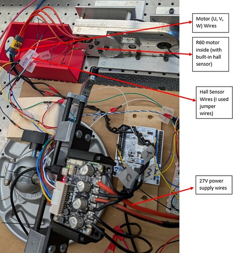

  • Can you share some pictures of your wiring and encoder mounting?

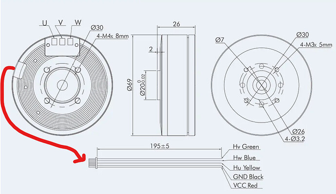

  • Enocoder: I am using the hall sensor encoder built inside the R60 motor.
  • Motor: CubeMars R60 (https://www.cubemars.com/product/r60-kv115-outrunner-torque-motor.html),

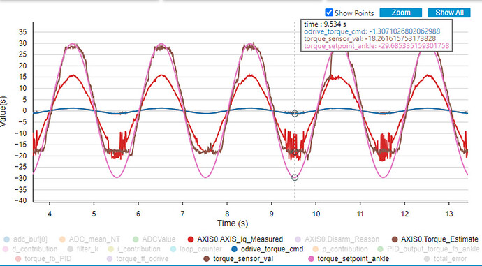

Also, when you were running the torque sine waves before, was this at near zero speed? Or was this at some medium-high speed?
Hello,
  • When I was running the torque sine waves, this was at near zero speed.

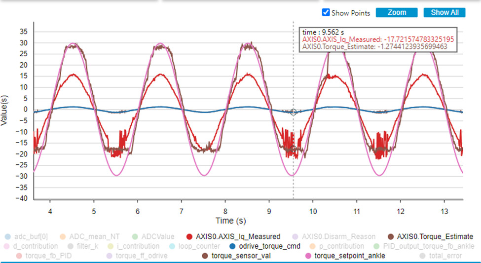

  • After I commanded “odrv0.axis0.controller.config.enable_torque_mode_vel_limit = False”, I commanded a larger torque, 1.3 Nm to the motor (35.1 Nm at output). The results are listed below.
It creates jittery current values and weird motor sound at those jittery points. Also, the output torque is 18.26 Nm (measured by the torque sensor), which is lower than the output torque setpoint, 29.68 Nm.
But the ODrive is thinking it is outputting the correct torque value based on the current (17.7 A) and the torque constant (0.072 Nm/A). The jittery current values are oscillating on both sides of the correct current value.
So, “odrv0.axis0.controller.config.enable_torque_mode_vel_limit = False” produced the same result as before.

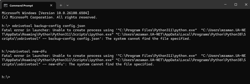

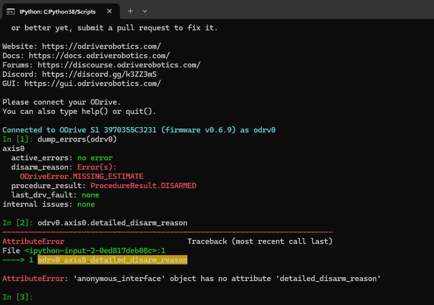

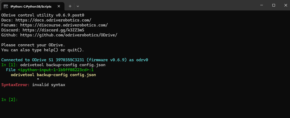

  • Regarding odrive backup, I tried to use the necessary command, but it showed invalid syntax error.
I also tried in the windows cmd, did not work either.
But I know odrivetool is working, because I can see the Vbus.

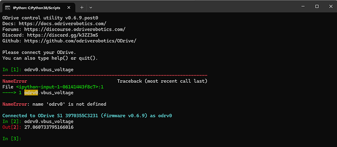

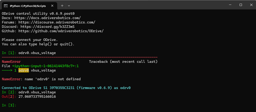

  • I was using firmware v0.6.9.post0, I tried to upgrade to firmware v0.6.11 using “windows cmd>pip install odrive==0.6.11.dev0” (could not find 0.6.11), but the torque asymmetry and the “missing encoder estimate error” at commanded step input remained the same.
picture shows Odrive 0.6.11.dev0 and disarm reason for the error when step torque command is given. I tried the “axis0.detailed_disarm_reason”, but it did not work, so used “dump_errors” instead.

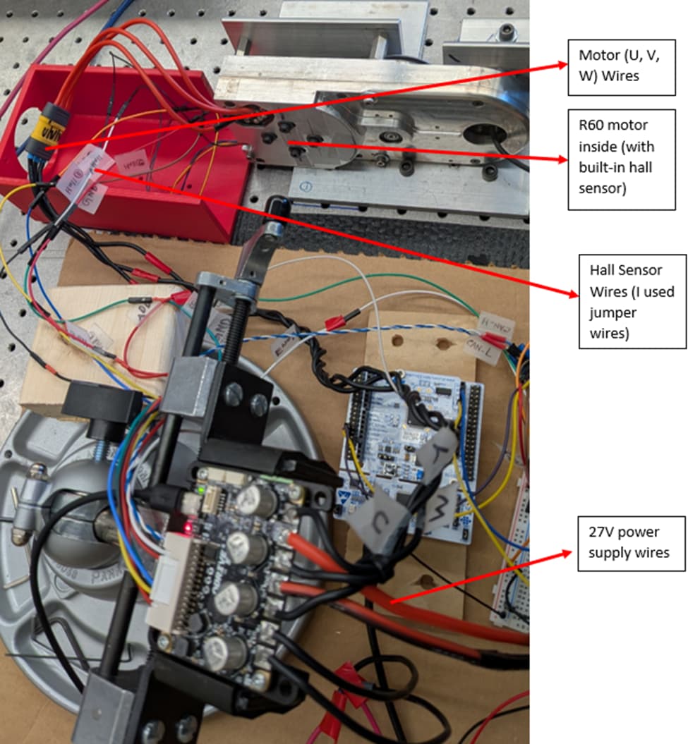

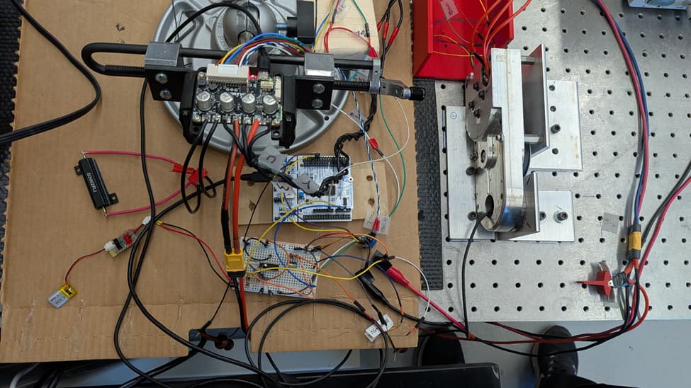

  • Pictures of wiring: please see below.
R60 motor encoder wiring
If I use another 3rd party encoder (e.g. AMS AS5047P), will that solve the issue? Or, the problem has nothing to do with it?
This needs to be run at the command line, not inside ODrivetool. It looks like there’s some issue in your Python path – you can check out the Python installation instructions here.
v0.6.9.post0 and 0.6.11.dev0 are the ODrivetool versions. But yes, your S1 is running v0.6.9, I would definitely recommend upgrading to v0.6.11.
I’m thinking though that your missing estimate error may be related to wiring – those jumper wires can be unreliable, if the encoder lines drop out even for a few hundred microseconds, it can cause this error.

I’m not sure, definitely would need to see that config.json to tell. You could maybe try running this inside ODrivetool:
from odrive.legacy_config import backup_config_ui
backup_config_ui(odrv0, "config.json")
If you don’t know where the file is being written to, you can check with:
import os
print(os.getcwd())

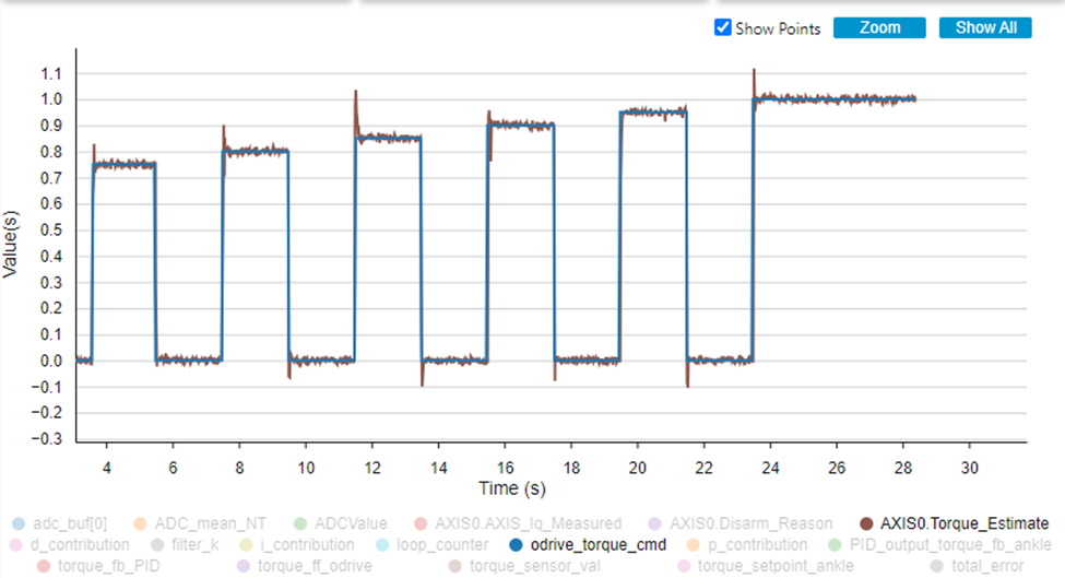

Hello, this is an update to the issues I was facing with ODrive.

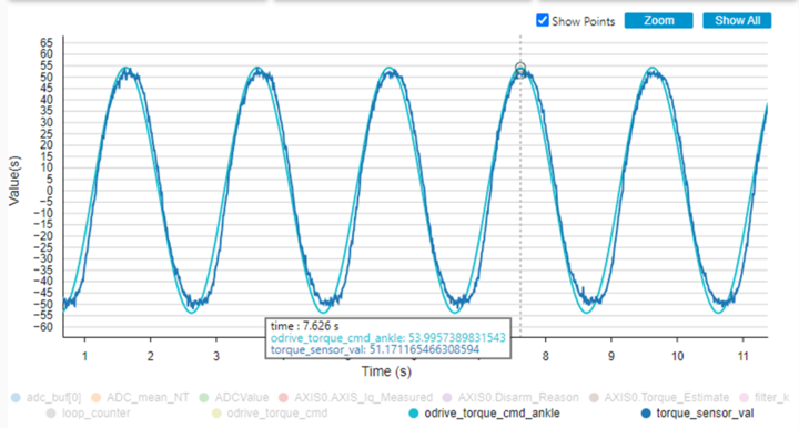

I was having problems with the motor Hall sensor operations with ODrive—basically the commanded and measured motor torques were not matching. The sinusoidal torque response showed asymmetric behavior.
So, after that, I used an SPI encoder integrated with ODrive (AS5047P) to measure the motor rotation and send out ODrive torque commands. That actually solved the asymmetry problem, and I am going to stick to this encoder approach. So, the motor Hall sensors were to blame for this behavior. The below image shows commanded vs measured torque.
Thanks to Mr Solomon for his patience and effort to solve this problem. Please let me know how I can close this thread as solved.
Very glad to hear the issue was fixed! That plot looks great :slight_smile: please let me know if there’s any other way I can help!
