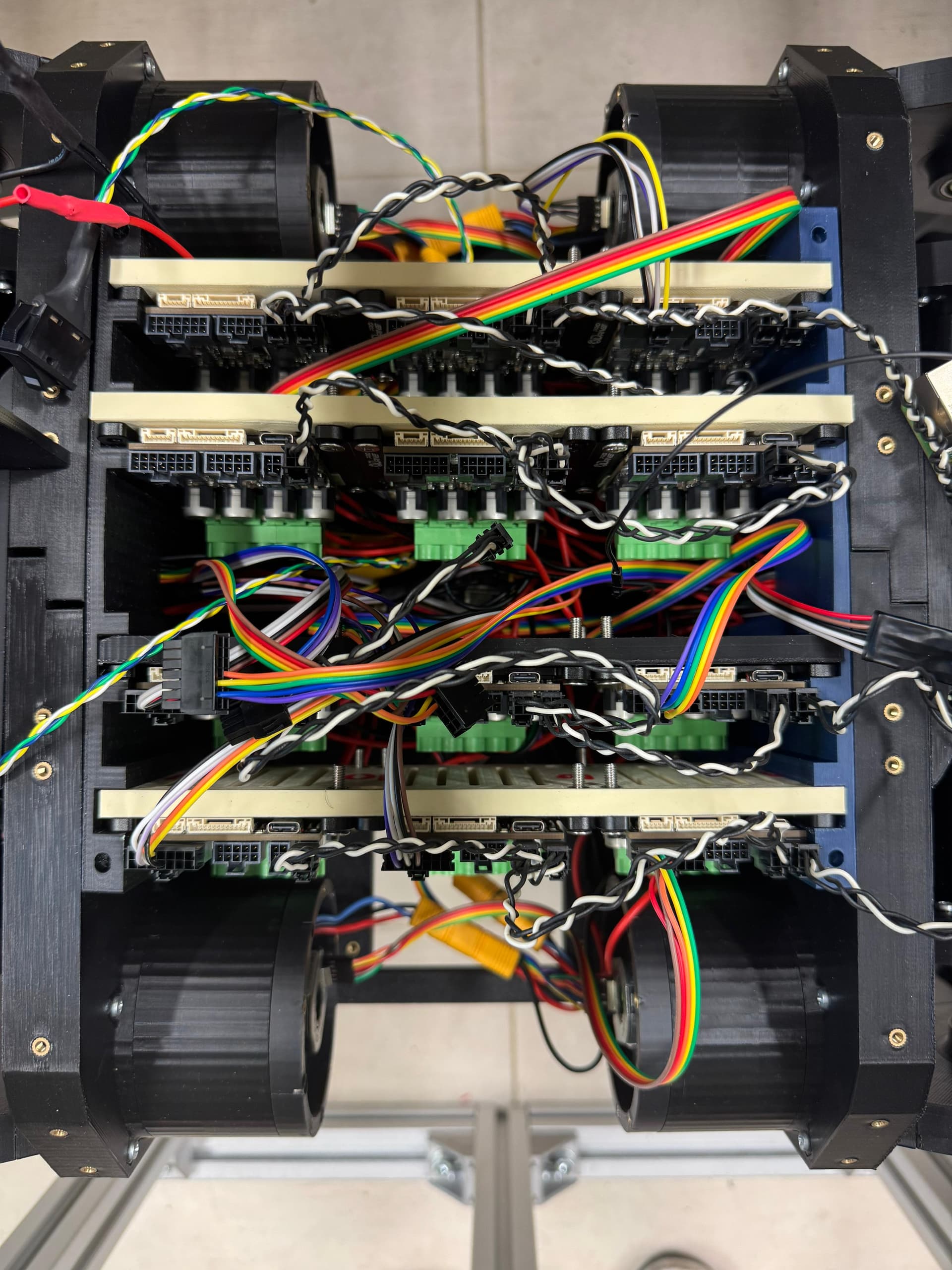

Hello @Wetmelon,
I got the same exact issue with my ODrive Pro (firmware version 0.6.11-1).
I was calibrating my motors, and then sent the ODrives to closed loop control.
Everything was working well, until suddenly the Odrive with node id 4 was only lighting up green without blinking in closed loop control.
I tried to reboot it but it would not turn on anymore, both with CAN and GUI.
I noticed that the STM32 is heating up really quickly once I give any form of power to the ODrive. The ODrive LED is also not turning on.
I was working with a 20V, 5Ah battery as power source, my regen current limit is -5A. and my max forward current is 20A.
There was no movement on any of the motors as I hadn’t finished the calibration yet (I am working with 12 ODrives).
I am also using a power distributor for the ODrives (see link here)
You can also see a picture of my ODrives set up below
Any help would be much appreciated.
