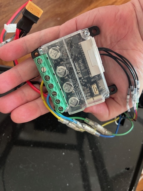

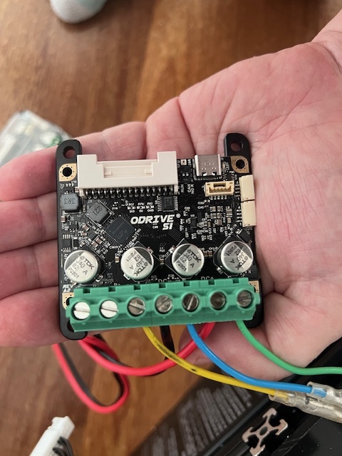

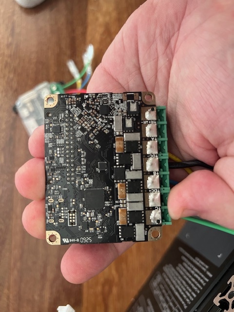

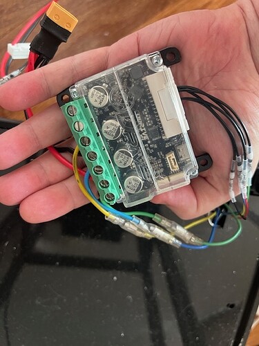

Hi! What specific motor are you using? As well, what’s your calibration current and voltage (config.motor.calibration_current and config.motor.resistance_calib_max_voltage, if using ODrivetool). As well, could you post some pictures of the top and bottom of the board?
We use a BLDC motor (a wheel from HOVER-1 hoverboard)
We do not use ODrivetool.
calibration_current = 10.0
Se the entire Python script attached. Also attaching pictures.
Please note that we bought two S1s and the other one works perfectly.
