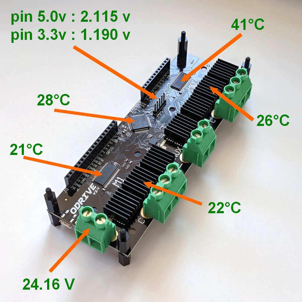

I ordered and received 2 odrives cards recently; one card works fine, but the other only worked for a week and now turns off as soon as I plug it in. I removed all the cables, but I have the same problem. I tested it with the same power supply (6s lipo) as with the card which works correctly. Do you have any idea on this problem?

When you say โ€˜it turns off as soon as I plug it inโ€™ do you mean: you see the green light come on and then go off?
Or it doesnโ€™t light at all?
the green diode (PWR) lights up and goes out 2 or 3 seconds later
Does the CPU on the board get hot? Can you measure the 5V and 3.3V lines?
Hello,
I took some measures
Laurent
