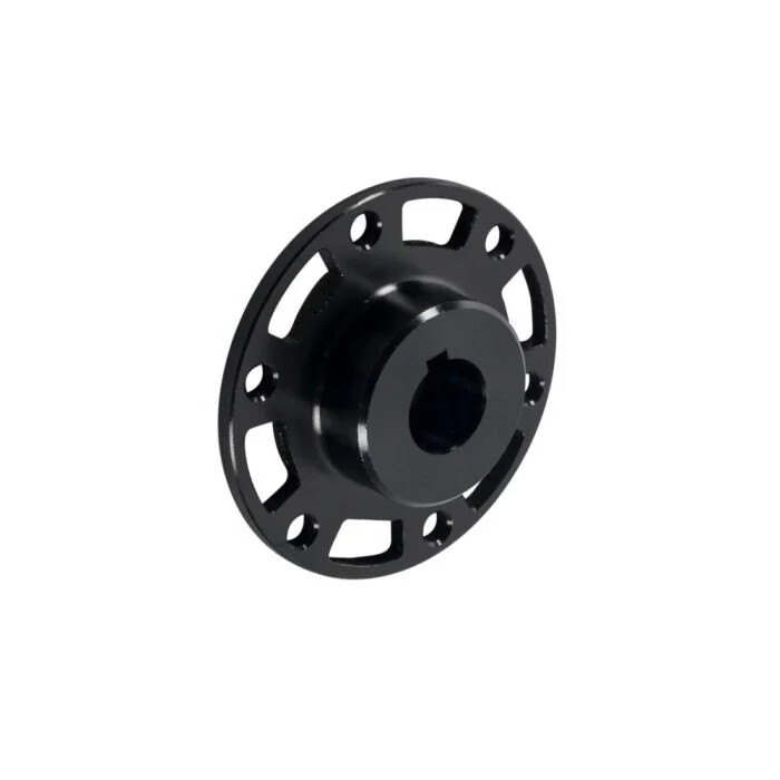

I just got the M8325s motor, excited to hook it up. But, … and I can see in the picture now it has this tiny little pin sticking out. I guess I have to now buy a shaft to screw to the body of this, and one that will allow that tiny pin to pass? What is the part I am looking for called that will accomplish this? I have a few motor coupler adapters lying around but they are “female” i.e. intended to mount onto a shaft not to BE a shaft. My current motor has a 10mm shaft so if I want to use that same coupler, I guess I need a 10mm shaft.
The motor’s designed for a flange mount, the pin is just for centering whatever output hub / pulley / gear / etc. You could likely 3D print a pretty decent hub to some 10mm shaft stock, something like this, maybe with a setscrew:
Right, I dont need a hole, I need a shaft :wink: with this I will need to cut and hone a 10mm shaft nub, attach this to the motor the shaft nub to this, the coupler to the shaft nub and that to my driven shaft. Messy. Is anyone aware of a flange mounted shaft? The motor should probably come with that. Not sure how anyone can use the little pin. Sure its for centering but unless you have a precision ground hole the size of this pin it wont do anything but be in the way? I did find one flanged threaded shaft but it is solid - can the little nub be ground off or otherwise easily removed? I thought I was pushing the easy button by buying this motor - I saw the pictures but just didnt look very closely. My bad.
For temporary I can just print the flange /shaft thing im looking for. But mostly what I see are like the oicture you posted - female flanged shaft adapters. Is 31mm diameter mounting holes a standard? That also sounds a bit like like unobtanium.
Shaft goes in the hole! Face mount outputs are pretty common for higher torque outputs in robotics, a lot of times you’d see a pulley or gear machined / printed to mount directly on the motor to bypass needing a shaft entirely, a basic example is how James Bruton does it in his video here.
Doesn’t need to be precise – just moreso than the screw holes – fairly trivial to drill a 3mm hole with +/- 0.25mm tolerances, but locating screw holes frequently leads to a bit looser tolerances.
You can definitely hit it with a dremel, it’s just aluminum. Though I’d definitely say that if you want a shaft, just printing an adapter may be the best move – a 3D print can definitely take full torque of the motor. You could also just hand drill an off-the-shelf adapter, making a simple 3D printed insert to locate it against the centering pin.
