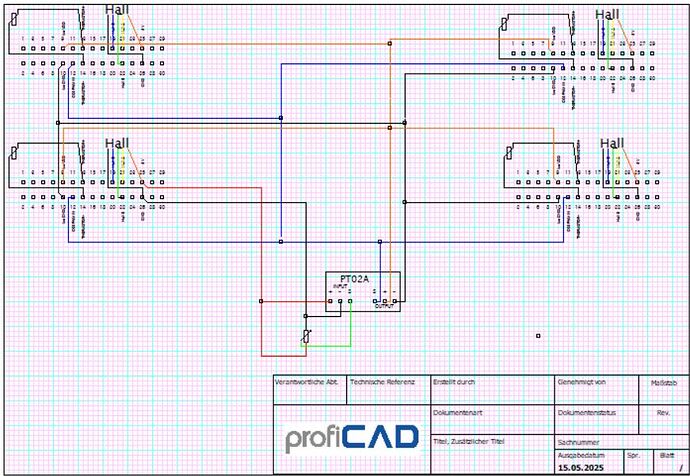

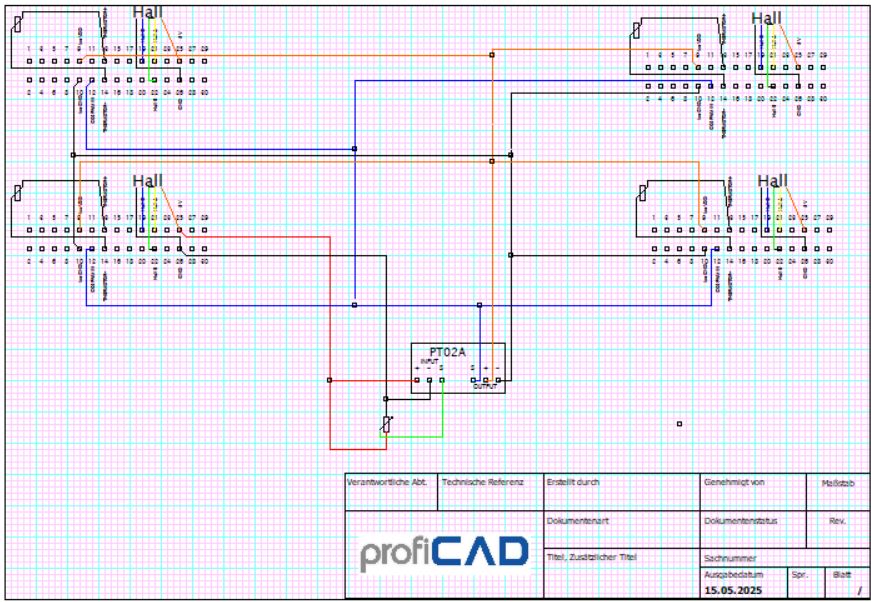

I want to control 4 S1 with a potentiometer. Is it sensible to connect the 5V supply from all 4 S1? Or is it enough if I take the 5V from one S1 to the potentiometer?
Unfortunately, I was not able to upload the schematic.
Uploading: Schaltplan 4 S1.jpg…
That’s definitely not advisable, that’ll cause a massive ground loop since the analog inputs aren’t isolated, and could cause damage to your S1s. However, if you use a “servo tester” board (similar to this or this), which outputs R/C PWM (1-2ms pulse widths), you could connect it the PWM IN pin on all the S1s (as well as ISO VDD and ISO GND), which is isolated.
my circuit diagram looks like this.
Could it work like this
Multifunction signal converter module PT01A
