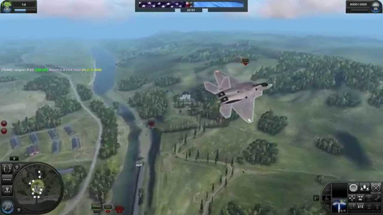

This can achieve leading interception instead of pure pursuit homing; this is very popular in missile guidance.
Check this video for a demo.
Note that you will have to convert the computed lateral acceleration into wheel velocity/acceleration using basic kinematic and dynamic knowledge.
