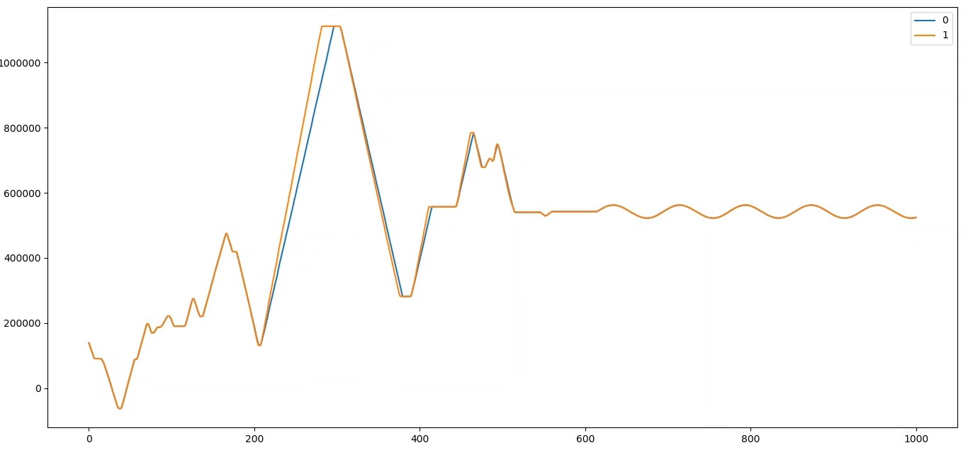

I am currently editing my Mill conversion Part 5 video and thought I’d put a little update on here.
Wow, again these ODrives are cool and very accurate. I have the Y-Axis up and running on batteries that re continuously charged by a 50W solar panel (not at night obviously ;-). The D5065 Motor runs well with the AMT102 encoder now I have the system re-tuned on batteries, where I can achieve a velocity limit of 350k :smiley:
I have very little backlash on the whole drive system and can accurately repeat table movement shown using a co-axial dial indicator (ignoring the 0.01mm per graticule, I can’t accurately test the distance with this).
I think the system will have to be tweaked more, although very happy with the current performance.
The next step is to connect an Arduino, write a sketch and machine out the X-Axis items.

From the tests in the video, I will be using the Arduino to control end stops, backlash compensation and G-Code control, so the ODrive has a nice time just looking after the precision motor control.
I have tested the whole table crashing into the back at various speeds with the motor current set to 20A (more than adequate with 4:1 drive reduction) with no damage to anything or belts slipping, where the ODrive just jumps out of Closed Loop Control as expected. Very happy with that :smiley:.
