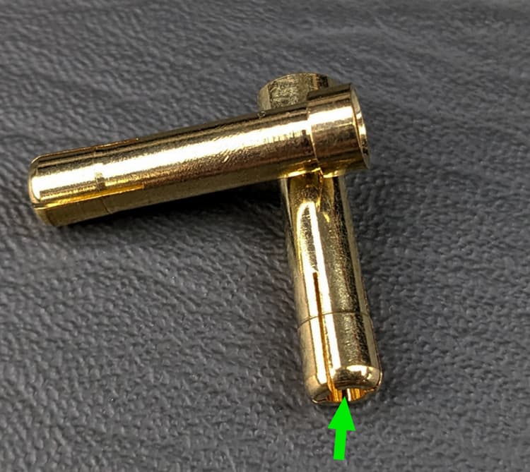

Could severe bending of the motor cables cause a change like this in the phase resistance? One of our team members was a bit harsh on the wiring during reassembly. Is there any way to identify if that could be the issue, or fix it if it is?
My biggest guess is contact resistance with the bullet connectors. Sometimes the “fingers” on the plug side can get bent inwards a bit, I sometimes find I have to wedge a screwdriver in there to unbend them, where the green arrow is:

If you have a LCR meter, that may be a good next step – a per-phase (pair) inductance measurement will tell you if it’s a bullet connector or a winding is smoked/broken. Disassembly will definitely be pretty tricky, I’d grab a new one at that point.
Actually, quick followup – the 39mohm figure is phase-neutral. If you solve for A/B/C phases given your three measurements, you get a phase-neutral resistance of around 39-45mohm for B and C, but 15.4mohm for A, which is much lower than expected. I’d try repeating the CC power supply test, but if it still gives a significantly lower A-B/A-C vs B-C resistance measurement, I’d interpret this as a sign that phase A is smoked, unfortunately.
