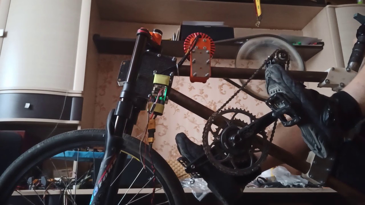

My thought is the best way to use Odrive for something would be see if you can replace the chain with a hybrid-electric drive system where the pedals turn a generator and use a hub motor on the rear, and you eliminate all the complexity involved in trying to get power to the rear wheel in a way the pedal feel does not react to the suspension travel.
Well, I already did just that :slight_smile:
Just not odrive but Vesc, odrive is an overkill for that actually. Got 85% efficiency out of the system, too!
I’m pretty proud of it, especially after reading how some companies failed to create a decently effective and pleasant to pedal generator after working on this for years, ehehe.
Maybe they minded the system ‘freewheeling’ too much, IDK. (don’t mind the backwards pedalling - I just happen to like it :))
It works on principles of using duty cycle control mode - as you overrun the motor in power stroke, it resists, but stops resisting on ‘dead spots’. The system is very pleasant to pedal and amounts to 100% automatic transmission, no need to change gears or set load at all, just push harder and the motor will resist harder.

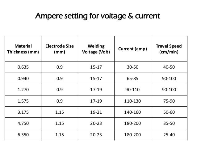

What is the wall thickness on that pipe, you might be within the range of reasonable currents for welding with an ODrive with some inductors on the output…

As for welding with a controller - lol, now that is out of the box thinking! I think it should work indeed - it is just 1.2mm.
However, getting a welding apparatus is not that hard… but don’t skils either and I have cromoly that require gas shielding and my no-weld construction is also ‘self-jigging’ - making a jig for welding from plastic is not exactly a smart idea, it will at the very least melt, or catch fire!
I’m making composite lugs vacuum molded over 3d printed madrels, preliminiarly tests are very encouranging. Plus, I can do that in my living room. Welding in my living room goes one step beyond what even I consider crazy :slight_smile: Maybe eventually I’ll get myself a proper shop, but not now.
