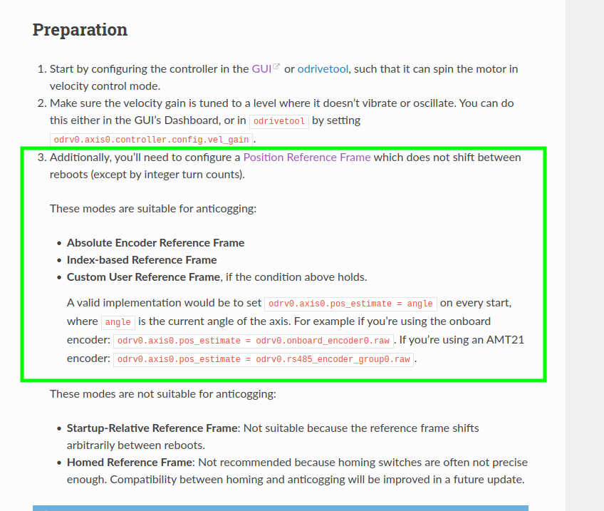

I am having an issue where I cannot get the anticogging calibration to run without throwing a missing estimate error and disarming the motor. I have tried changing various parameters such as encoder bandwidth, and gains but the problem persists.

Hi! You need to set up a position reference frame:
Typically with an absolute encoder like the OA1, the absolute encoder reference frame is the best choice.
