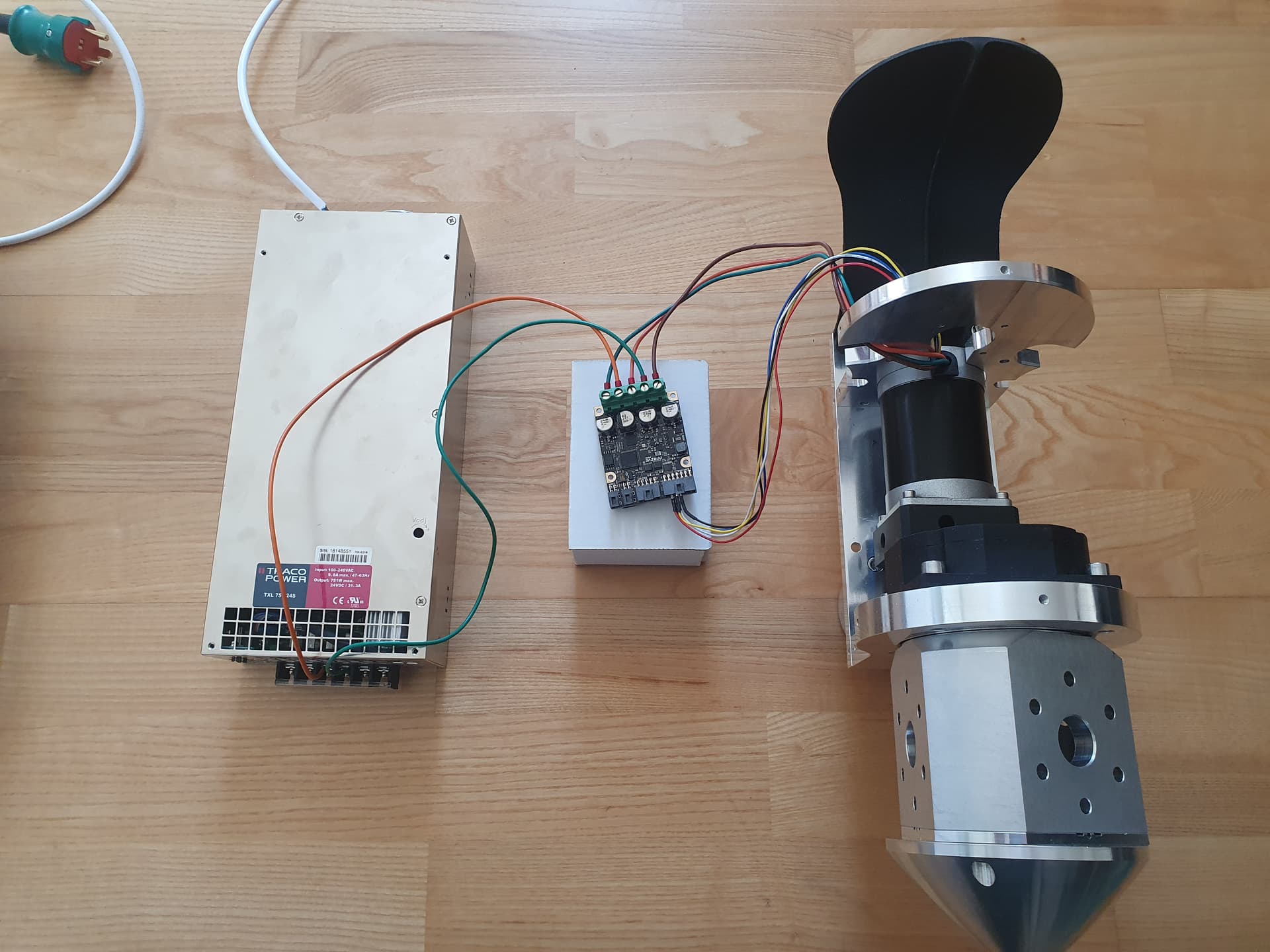

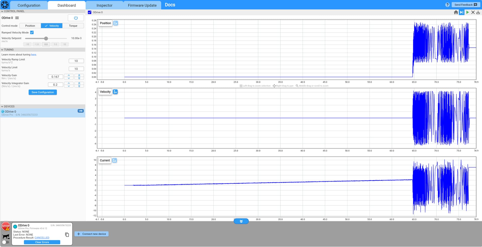

Good news, between changing the pole pairs to 4, and disconnecting the motor I got it spinning after the calibration. However the motion is incredibly janky, even at 0.01 velocity setpoint (see image):
Great to hear it’s working! I definitely have some ideas for how to improve this.
At a baseline, I’d start with integrator gain at zero, and velocity gain at some much smaller number (maybe 0.01). Step velocity setpoints up to 10, and back to zero, each time increasing the velocity gain until you get vibration like you have there. At that point, set the velocity gain in half. Then, do the same thing with the integrator gain, keeping the velocity gain you just found.
