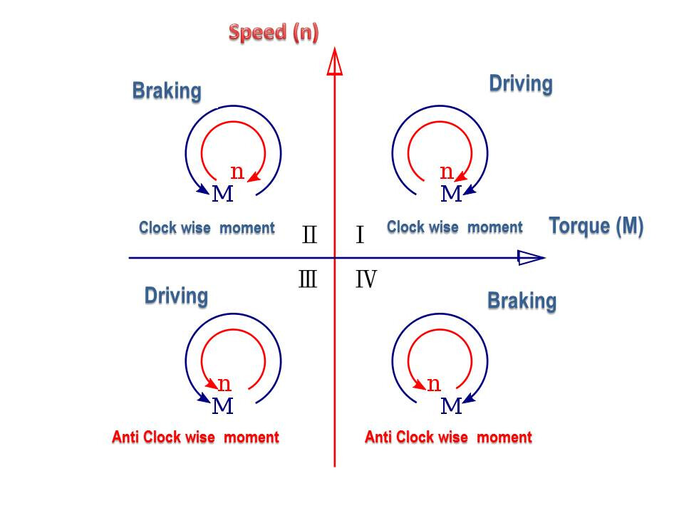

Quick diagram of the motoring/generating thing – all ODrives are what’s called a “four quadrant” drive, which means that it’s able to seamlessly command both positive and negative torque no matter the motor rotation direction.
Any operation in quadrants I and III (e.g. torque sign == motor velocity sign, aka acceleration/motoring/driving) will result in power being drawn from the bus, and any operation in quadrants II and IV (torque sign opposite of motor velocity sign, aka braking) will result in power being regenerated to the bus.

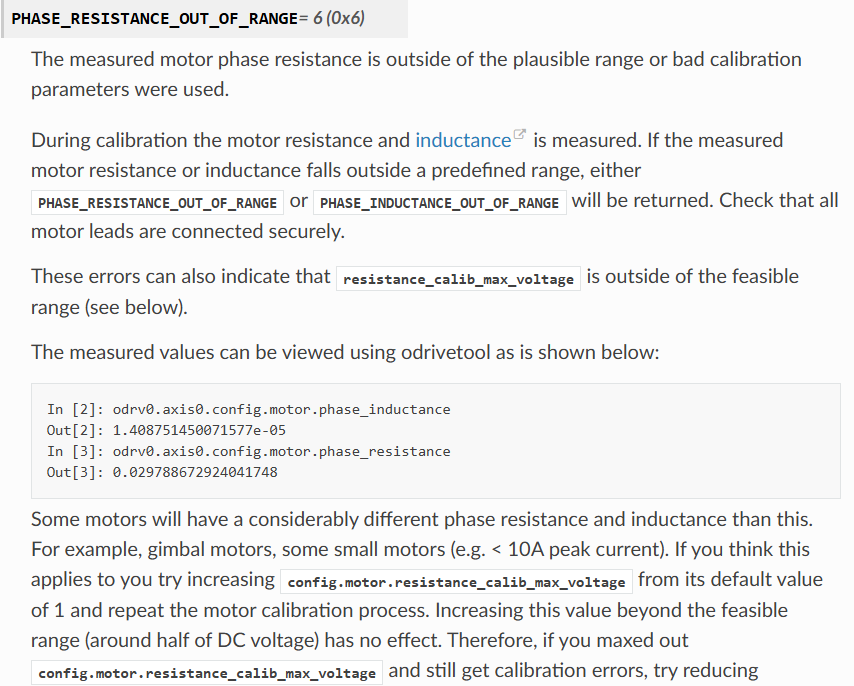

With respect to the GUI, when I was first bringing up the motor, it kept giving this error message!
image|622x499
Well that’s the first time I ever saw the word “plausible” in an error message, and I eventually determined that I was trying to be too careful and put too low a voltage on the board (supposedly the board will work down to 9 or 8V (?) but somewhere in the GUI instructions it said “be sure you’ve put at least 12V on the board” and doing that made the error message go away and calibration proceeded politely from there. But it illustrates that there are a lot of behind the curtain checks that are being done in the GUI/odrive software to make operation safe and friendly, and those sometimes kick in and prevent the operation we think we’re seeking from proceeding - like maybe it sees the rotor not responding as expected to the forcing function that it calibrated for, and thinks that’s implausible :grinning:
