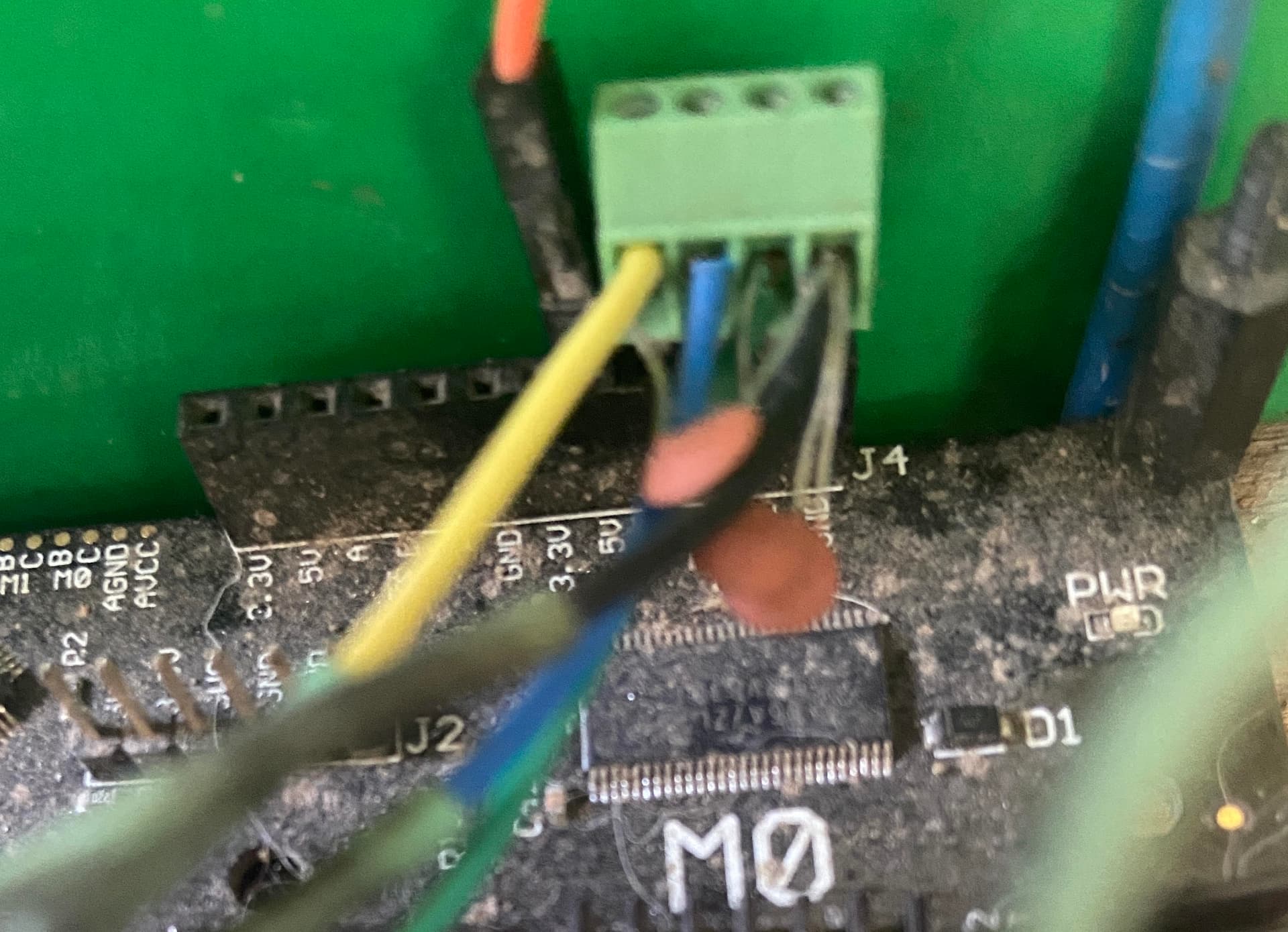

Here is a quick solderless solution that I came up with and hope it can help someone!
Here is how I solved the problem without soldering:
I placed wires and capacitors within some screw terminals.
