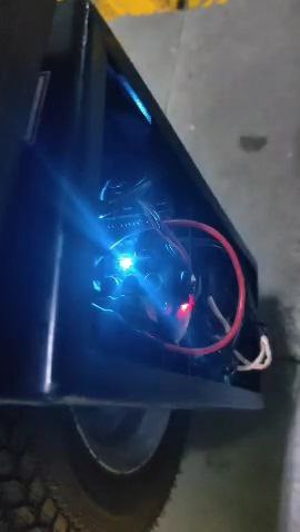

we are using an o-drive pro, when powerup, the SYSTEM_LEVEL error occurs while entering the closed_loop, and it couldn’t get cleared while the clear error or reboot comment passed via CAN protocol and getting into CLOSED_LOOP_CONROL for further operation.
If startup_closed_loop_control is enabled, the SYSTEM_LEVEL error occurs, but it reboots instantly.
note: powerup through a battery of 54V 45AH.Totally 8 O-drives are powered at same time and error occurs at random drives.
Please suggest how to proceed ahead.

Can you please share your configuration? You can run odrivetool backup-config config.json in ODrivetool and paste the resulting config.json here.
Thanks for replying! I will attach the .json file below.
Got error in both sensored and sensorless mode.
For sensorless- 8318 motor,
