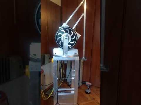

I did some tests for the Z encoder 2500 changing the starting position and motor_dir and that’s what behavior I was able to detect:
  1. .encoder_offset =-6263, .motor_dir = -1 looks like that it can’t find z pulse
    https://youtu.be/urRpeb1Ho8I
  2. .encoder_offset =-6263, .motor_dir = 1 there are several stable motor positions per round (not by z pulse)
    https://youtu.be/2NyKRk6UsS0
  3. .encoder_offset =-6263, .motor_dir = 1 in some positions there is that strange behavior. I tried to damp the oscillations with my hand
    https://youtu.be/qBpkqKWuDM0
Settings:
Motor - N5065
.calibration_current = 10.0f,
.current_lim = 10.0f,
.use_index =true,
.index_found = false,
.manually_calibrated = true,
.encoder_cpr = (2500 * 4),
I understand that you may have many other things to do, but may I suggest to send this assembly (encoder,N5065 and Odrive) to you for verification ?
I will not disassemble this assembly so you could see this behavior.
Also i want to send the E6B2CWZ6C encoder with which ODrive does not work either (I ordered 3 such encoders, i checked all of them, and I wan’t to know - the problem is in them or in ODrive).
I can pay some money for checking and setting up.
Anyway, I’m going to order the new version 3.5 and I do not need version 3.4, but I need to be sure that these errors will not be in the new version.
Because this behavior with a large motor and current of 40 A can be dangerous.
It looks to me like the correct setting is motor_dir = -1, but something has changed (a phase wire is plugged in differently, some mechanical coupling has shifted, etc). Can you run the encoder calibration again?

Hello.
I’ve tested the Odrive 3.5 with the Z index encoder OMRON 2500 cpr and motor N5065.
Strange behavior repeats.
startup_motor_calibration - is ok
startup_encoder_index_search - is ok
But if after startup send
odrv0.axis0.requested_state = AXIS_STATE_CLOSED_LOOP_CONTROL
then there is uncontrolled N5065 rotation
And after this odrv0.axis0.error returns code 49
Here is the video

I did as you wrote but there is some strange behavior to me.
If i change the start position of the motor when Odrive is switched on, the motor CLOSED_LOOP is fixed not to the Z index position.
But if in JSON set "startup_encoder_index_search": true then why after found z index motor is shifted and does not remain in the position Z index?
Does this mean that I can’t change the starting position of the motor despite the fact that every time there is a search for z index?
Here is the video
On the video i did folowing
  1. the motor is on in the position in which I calibrated the encoder with index signal. Therefore when i switched on everything is fine and CLOSED_LOOP retains Z index position.
  2. I changed the initial position of the motor and turned on the Odrive - the motor has shifted relative to the Z index and CLOSED_LOOP retains NON Z index position
Here is json

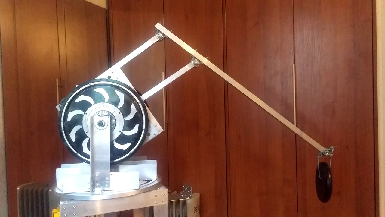

I hope the situation with the home position to become clear. The length of the shoulders of my manipulator is about 80 cm and encoder resolution is 17500 (7:1 => 2500*7) so it will be difficult for me to make such a home switch that will allow accurately starts from calibrating position.
I also want to ask your advice about a very important problem that I am trying to solve.
In short - how to make a smooth stop/start of the motor? May be you need to add a maximum speed and acceleration limit to command odrive.SetPosition
The motor stops and starts very sharply. This becomes clearly visible on a powerful motor.
Here in this video is shown as motor 1500 W with current 30 A moves by commands smth like this
    odrive.SetPosition(0, 3000);
    delay(500);

  1. One of solutions is to brake in this way:
    odrive.SetPosition(0, 4500);
    delay(5);
    odrive.SetPosition(0, 4600);
    delay(5);
    odrive.SetPosition(0, 4800);
    delay(5);
    odrive.SetPosition(0, 5000);
    If we started from position 1000 and want to stop at position 5000 then this method works.
    But in order to work correctly, you need to know the speed of the motor at the time of start braking.
    Also if the motor lifts the load, then for the correct choice of the braking interval, you need to know the weight of the load.
    Otherwise you will not get a smooth braking/starting.
  2. Another solution is getting the position by CTRL_MODE_VELOCITY_CONTROL.
    In this case, ODrive is controlled by speed commands, the encoder position is monitored, and the speed is changed.
    For some reason during the tests the torque on the motor is much less than when controlled via CTRL_MODE_POSITION_CONTROL

Let me show you the picture of my manipulator.
Shoulders very long, the resolution of the encoder 17500.
It will be very difficult to make such a Home switch that the initial position is always exactly the same. Therefore i can’t Mount the encoder in such a way that the index pulse occurs exactly at the intended home position

Hello. Here is the one of first tests of manipulator and the 2,5 kg load test.
calibration current = 10 A, current limit = 40 A, pos_gain = 100, vel_limit = 20000
It was hard to find the starting point so I made the starting platform.
It seems that inertia strongly affects the stopping at a predetermined position.
I believe that inertia can be reduced by a smooth stop.
