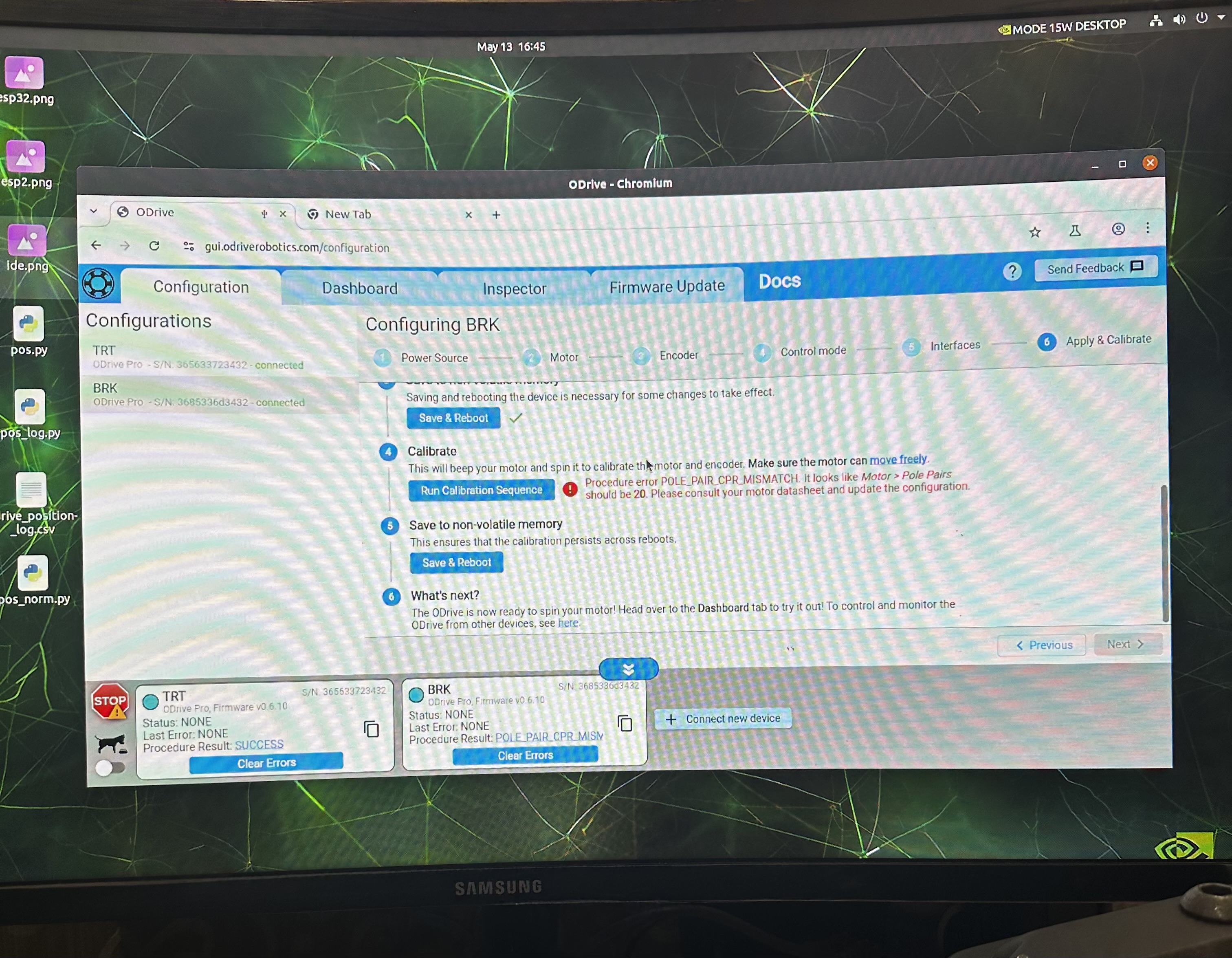

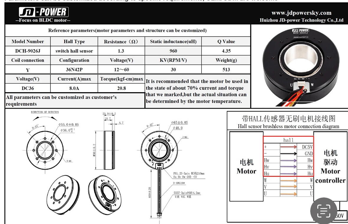

I am using an odrive pro to control the motor below:

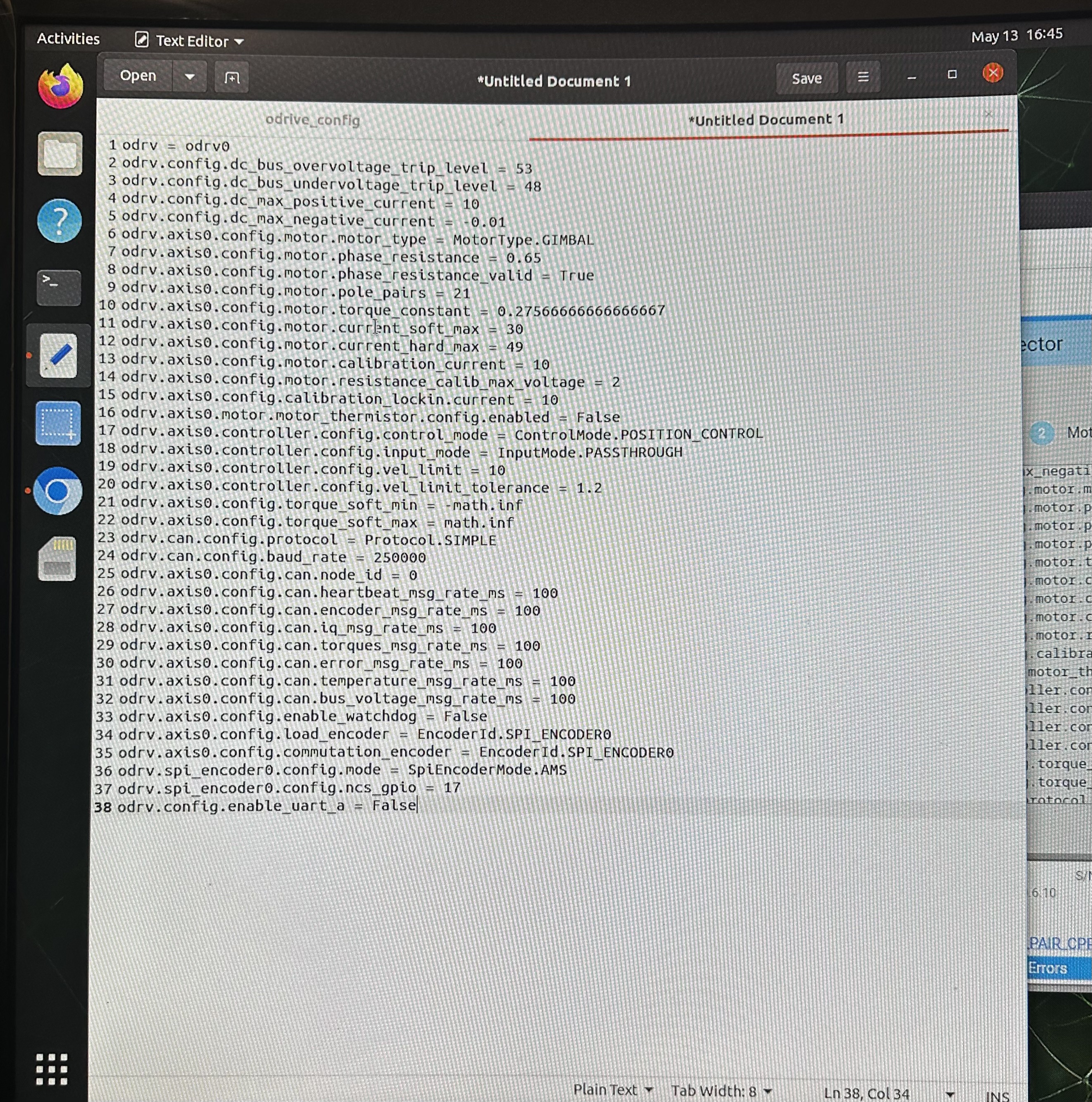

I get pole pair mismatch error for the following configuration:

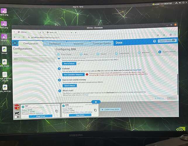

Error Output:
I am using an AS5047p SPI encoder, while calibrating the motor rotates before giving the error.
Could you please help in setting up the right configuration for position control?
Thanks…
Hi - let’s please keep this in one thread so that things can stay organized.
Can you show how your SPI encoder is mounted over the motor’s shaft magnet? I’m guessing you have some error or misalignment there that’s causing this issue.
Also note that your motor is rated for 8A max, but you set the motor’s current limit to 30A. I’d recommend reducing that to 8A, as well as the calibration current and calibration lock-in current.
