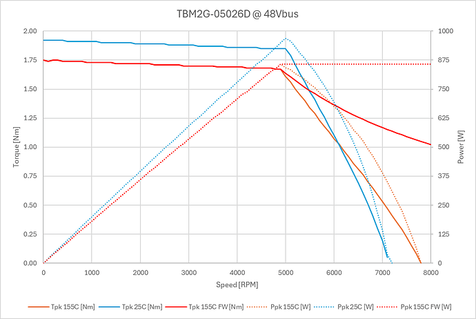

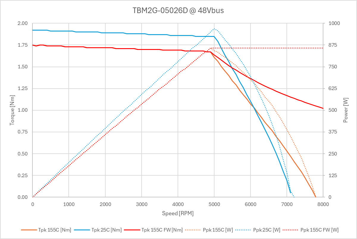

For example, these curves were provided for 25C and 155C:
I also added a theoretical curve at 155C with Field Weakening enabled. (I understand it won’t match perfectly to a flat power line, but I was just trying to show the potential.)

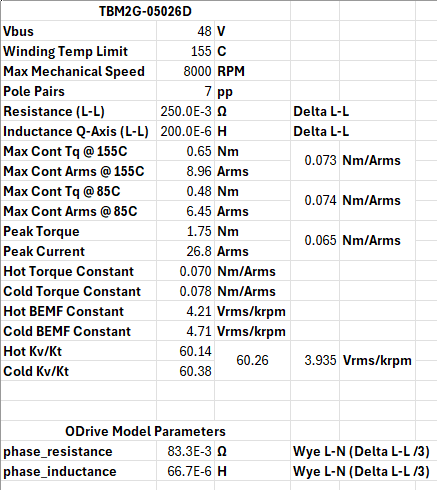

For example on what I have for motor parameters right now:
This is what was provided by the manufacturer in their public datasheet (along with some of my calcs). Like I mentioned though, I should be able to get whatever additional information is needed from them.

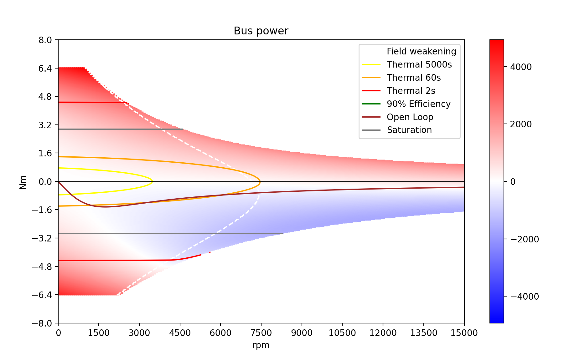

With a very quick plot from Eelco’s great pypowertrain, it definitely looks like this motor can field weaken okay-ish (please ignore the thermal numbers, I made up values for those and are definitely inaccurate).
I think the biggest thing here is – how much torque do you actually need at 8000 RPM? And at what duty cycle (e.g. how much at continuous, how much at peak, etc)? I am definitely concerned about the amount of Id current needed – these are some strong magnets, and the motor’s current limit is pretty low.
