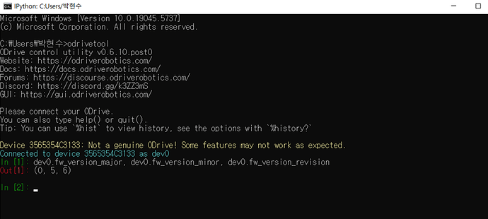

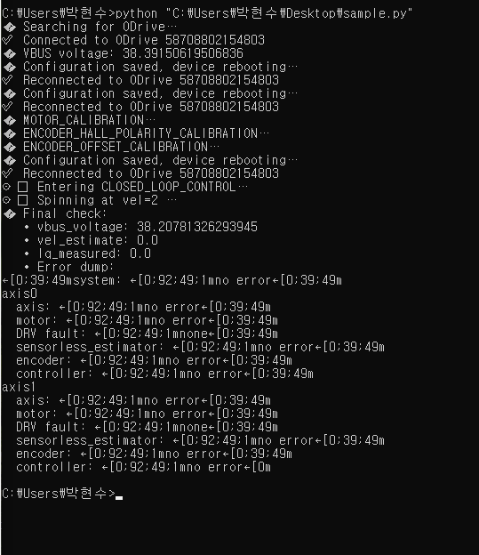

Thank you for your information. As you advised, I ran it by referring to the site data and found the following error phenomenon.
In this case, I wonder if it’s a firmware problem.
For your information, I executed it with the code below.
#!/usr/bin/env python3
import time
import odrive
from odrive.enums import AxisState, MotorType, EncoderMode, ControlMode
from odrive.utils import dump_errors

You need to run HALL_PHASE_CALIBRATION instead of ENCODER_OFFSET_CALIBRATION when using hall sensors.
After you put it in CLOSED_LOOP_CONTROL and assign the input_vel, I’d recommend running dump_errors(odrv0) then.
