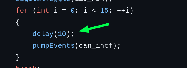

That did not seem to solve my issue, unfortunately. I’m fairly confident I have correctly diagnosed the issue, similar functions like while(odrv16_user_data.last_heartbeat.Axis_State != ODriveAxisState::AXIS_STATE_CLOSED_LOOP_CONTROL) will also loop forever.
@LucasHorsman I think you may be inadvertently replicating the issue we just fixed. Can you try removing the delay(10) here, and instead running pumpEvents() for at least 100ms? Maybe more like 150 to be safe:
e.g.
uint32_t t_start = millis()
const uint32_t t_poll_duration = 150;
while (millis() < t_start + t_poll_duration) {
    pumpEvents(can_intf);
See this commit message for more detail: Fix hang while waiting for CAN heartbeat on multi-ODrive systems · odriverobotics/ODriveArduino@5b65c50 · GitHub

I’m curious, how does running for 150ms pumpEvents help make this code work?
The Teensy has an internal buffer of 16 CAN messages – once more than 16 messages are received, any new ones are dropped. If you have two ODrives, each sending a handful of feedback messages at 100Hz, and then the heartbeat at 10Hz, the feedback messages will fill the buffer very rapidly, and the heartbeat messages will be dropped.
pumpEvents just processes all queued messages in the Teensy’s buffer, so by running it constantly for 150ms, you’re processing messages as they come in, and you’re guaranteed to have a heartbeat message within 150ms (technically it could be 101ms, but 150ms is safe in case there’s any messages that get dropped/retransmitted/etc).
While this is technically deterministic, if you’re running it with a delay, there’s the chance the teensy does catch the heartbeat messages in the first 16 messages since last running pumpEvents. Which is likely why it worked on your test bench. Sometimes even just the crystal oscillator frequencies being a little out of spec can be enough to nudge the clock between the ODrives and Teensy a bit out of phase so the Teensy will eventually catch a heartbeat message. Tricky bug for sure.

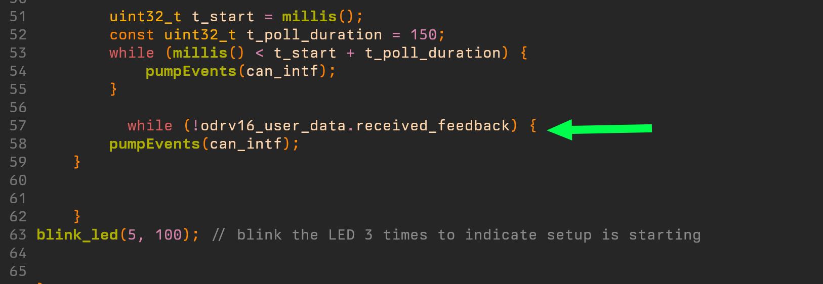

So to make sure I understand, the issue is solely here, that this while loop is never exited?

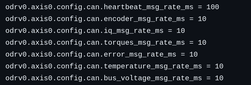

I’m curious if this could be a busload issue. I see you’re using 250Kbaud, and each of your two ODrives is outputting heartbeat at 10Hz and 6x feedback messages at 100Hz each:
Usually you want to keep CAN busload under 50% to prevent any chance of dropped or retransmitted messages – so that would be 125Kbit/s here.
Each CAN message is about 14 bytes, so per-ODrive, that’s 14 bytes * (6*100Hz + 1*10Hz) * 8 bits/byte = 68320 Kbit, between the two ODrives it’s 136640 Kbit/s, which is greater than the 50% baudrate target.
I’d recommend seeing what happens if you bump the baudrate up to 1Mbit/s, and/or disable the feedback messages you’re not using (iq_msg, torques_msg, error_msg, temperature_msg, bus_voltage_msg) on the ODrive.

The issue is that the odrives get setup in that function you point out perfectly fine, and then send feedback fine, until I request a position command. At this point, the odrives seem to stop sending feedback, verified by debugging the onFeedback and onHeartbeat callbacks. However I can continue sending commands to the odrives.
OK, so we have changed the baudrate already up to 1MB, I’m not sure how thats not reflected in the repo, but I am using 1M baud. I also tried decreasing message rates which didnt seem to do anything.
When using the USB-CAN adapter everything looks normal feedback wise, I just plugged it in where my transceiver was basically.
So when using the USB-CAN adapter, you can see that the ODrives keep sending feedback messages even after you send the position command, but the Teensy is no longer receiving any of the feedback messages?
As far as I can tell, yes that’s correct. It might be more accurate to say that the onReceive function stops being called. I haven’t hooked up an oscilloscope yet, so I can’t say certainly that the teensy is no longer receiving feedback messages.
