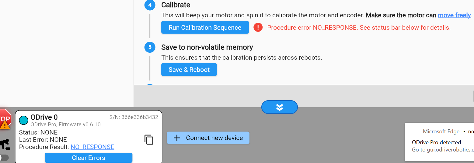

Hi, I’m trying to make work the AMS AS5048A encoder with the ODrive Pro and motor (link). When I run the calibration sequence, the motor moves a bit and then stop, giving the NO_RESPONSE error. I share my configuration and some photos of the connections:

When I run the calibration sequence, pos_rel stays in zero. I tried reading with a multimeter the voltage on the PWM output of the AS5048A and I get readings when i move the motor’s rotor, so I guess the magnet is properly mounted and aligned. n_errors continues to increase rapidly.
What could be the problem and how can I solve it? Thanks in advance!

Thank you as always for the really useful and comprehensive overview and information!!! Can’t express how much of a breath of fresh air it is.
Wiring looks great, no concerns there.
Can you try setting GPIO17 mode to DIGITAL? odrv0.config.gpio17_mode = GpioMode.DIGITAL (or equiv setting in GUI), then save_configuration()
If you’re also able to hook up an oscilloscope or logic analyzer to CLK/MISO/MOSI/CSn that would be quite helpful.
It’s been a while since I played with an AS5048, I have one somewhere and I’ll try replicating your setup.
General recommendation though – if you can swap this with an OA1, you’ll have a much nicer experience overall :slight_smile: the SPI can end up being a big issue when you’re actually running the motor, as it’s so sensitive to electromagnetic interferance.
Hi, thanks for the response. I tried setting the gpio17 to DIGITAL but no luck there. I don’t have an oscilloscope with me right now. We ordered a couple of OA1 for the future, but I would like to make this one work for now.
