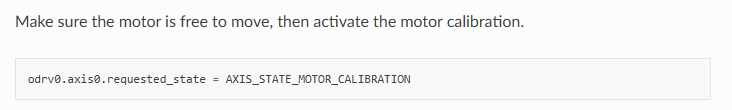

I’m going to run the hoverboard motor by referring to the site below. However, “odrv0.ax0.requested_state = AXIS_STATE_MOTOR_CALIBRATION” when this code is executed, the motor makes a sound and does not rotate, so there is no error as a result of checking the error. The site was checked and it says “Make sure the motor is free to move, then activate the motor calibration.”
What can I do to solve this problem?
Reference Site : Hoverboard motor and remote control setup guide — ODrive Documentation 0.5.6 documentation
What does dump_errors(odrv0) report? And where did you get this ODrive?
As far as I know, dump_errors(odrv0) is a command to check what kind of error occurred in ODrive. I got the ODrive board from the professor because of a school project, so I’m not sure of the exact source. However, after running “In [35]: odrv0.ax1.requested_state = AxisState.ENCODER_HALL_POLARITY_CALIBRATION”, “In [36]: odrv0.ax1.requested_state = AxisState.ENCODER_OFFSET_CALIBRATION”, it was confirmed that the motor operated and controlled the speed with closed loop.
Is the method I executed a normal one?

For best performance, you should run hall polarity, then hall phase, then encoder offset calibration. It should be properly calibrated after that.
