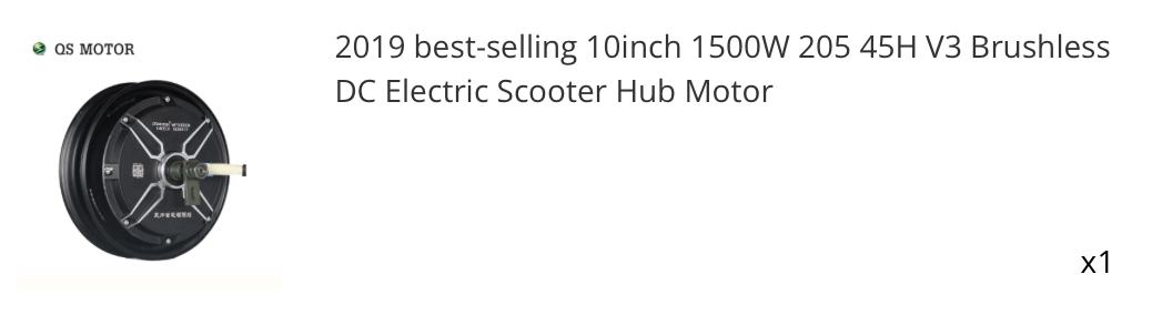

Currently I am in the process of converting a Vespa scooter to electric. I am using a FarDriver controller for the 10” 1.5kW hub motor with peaks of 3kW.
The battery pack is 52V and the max current is 50A. I would like more control over the motor and am thinking of using a Odrive Pro since, according to the specs, this should be compatible. I am sure I need to take care of some extra cooling but this is not a problem.
I can however not find any similar projects using the Odrive and was wondering if there is any reason for that?
