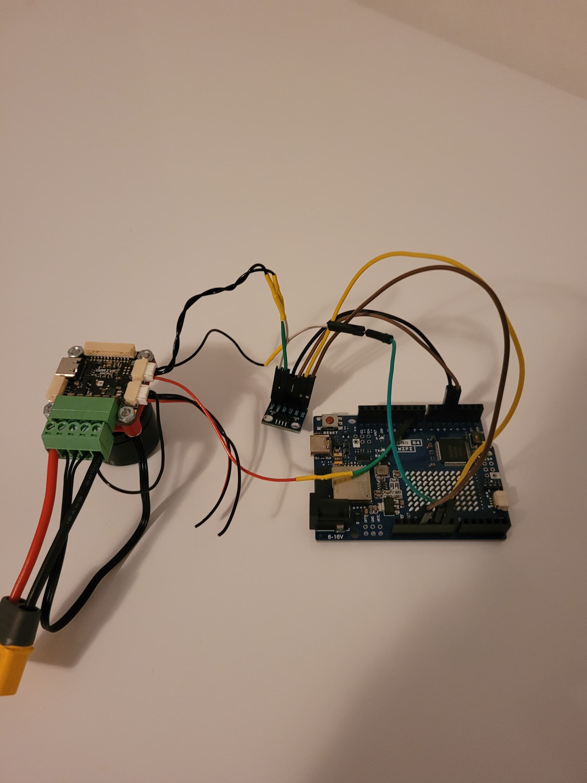

Hi, I’m trying to use the code from the manual, but whenever I run it, the code always gets stuck on “Waiting for ODrive…”.

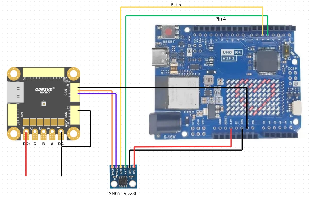

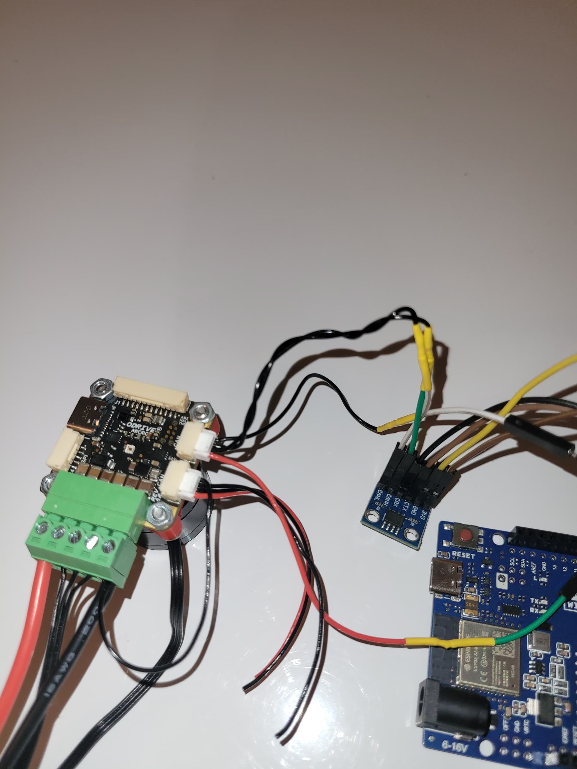

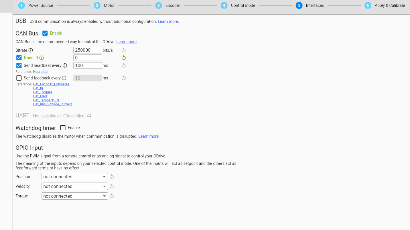

I’ve already tried everything listed in the troubleshooting guide for this problem, but nothing has helped. When I added a debug print statement inside the onCanMessage() function, it doesn’t output anything.I did the setup through the GUI and solder the 120 ohm jumper on the bottom of the board.

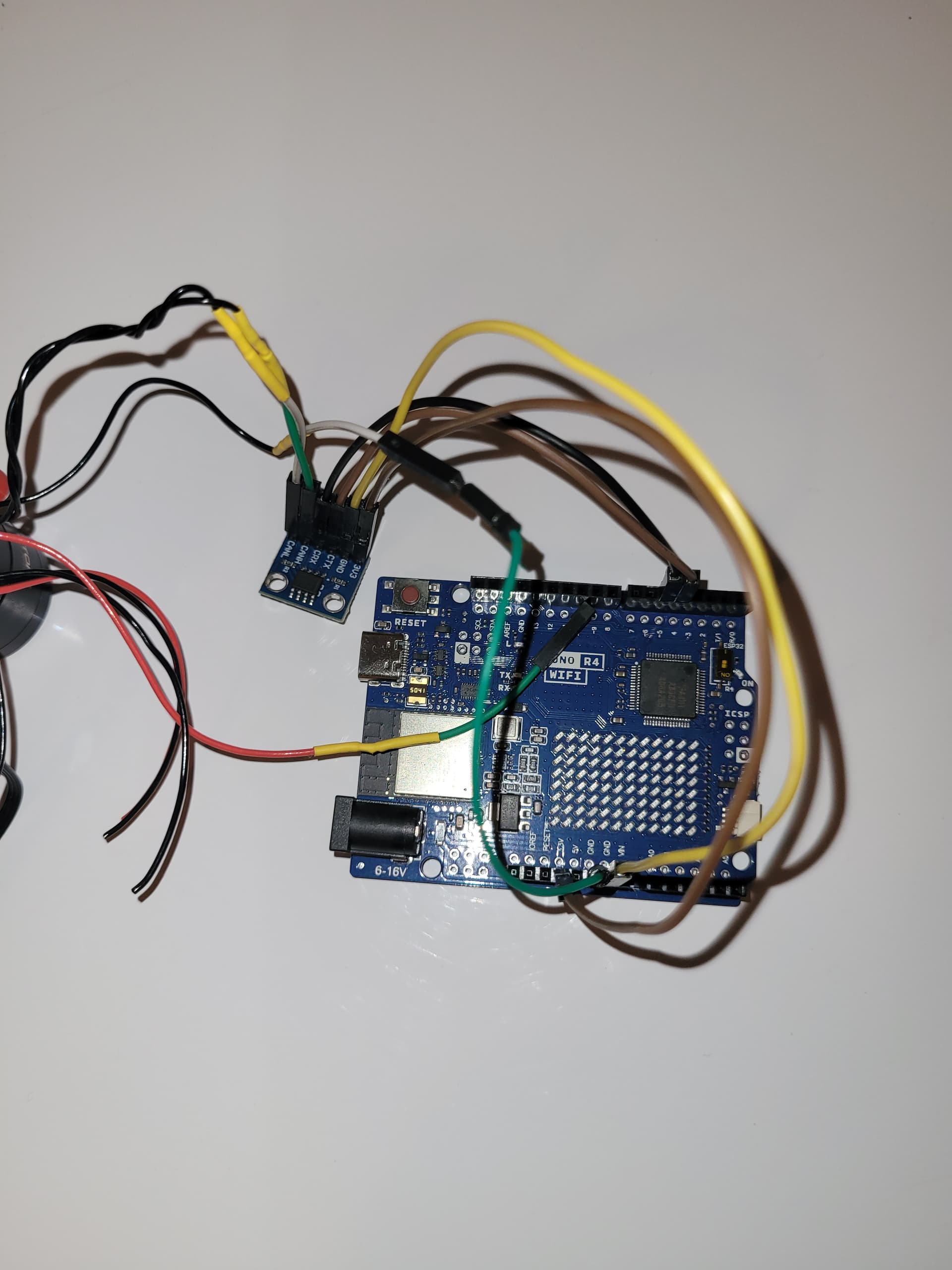

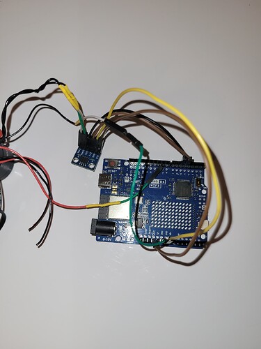

This is my wiring setup:

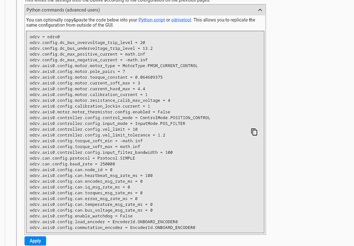

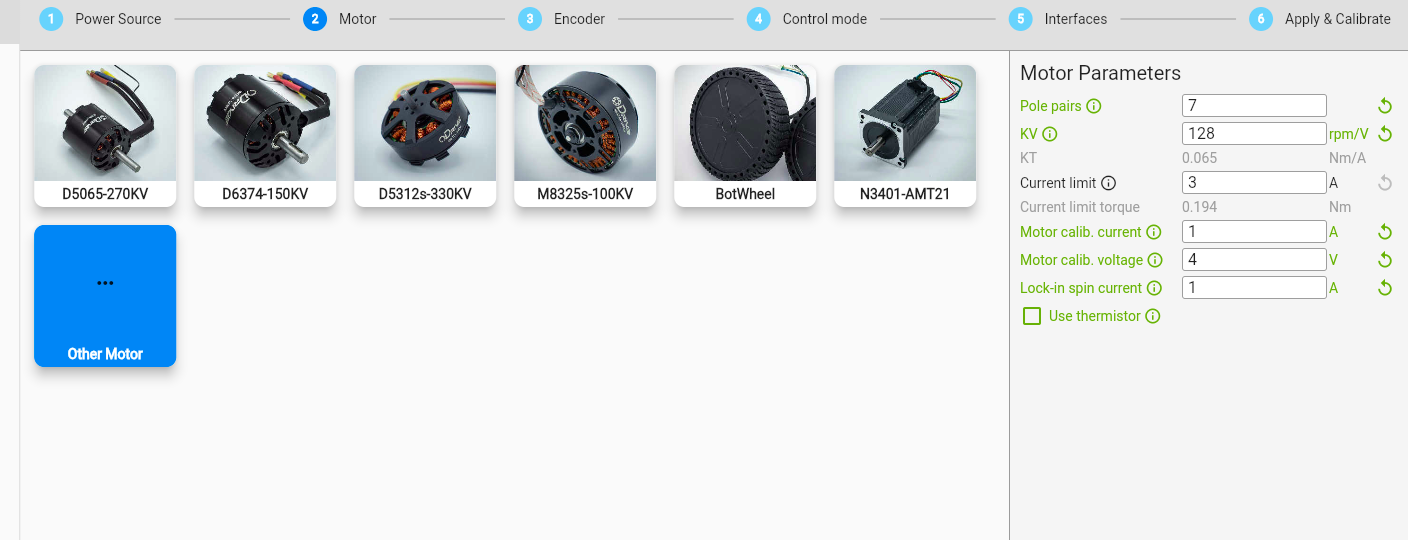

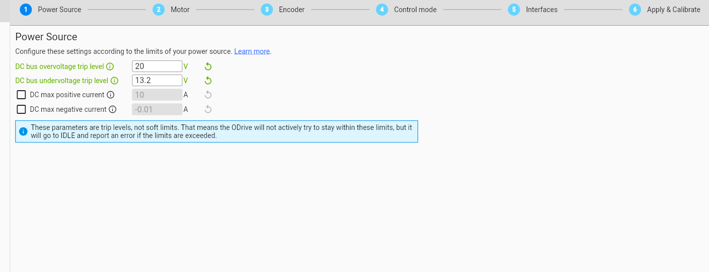

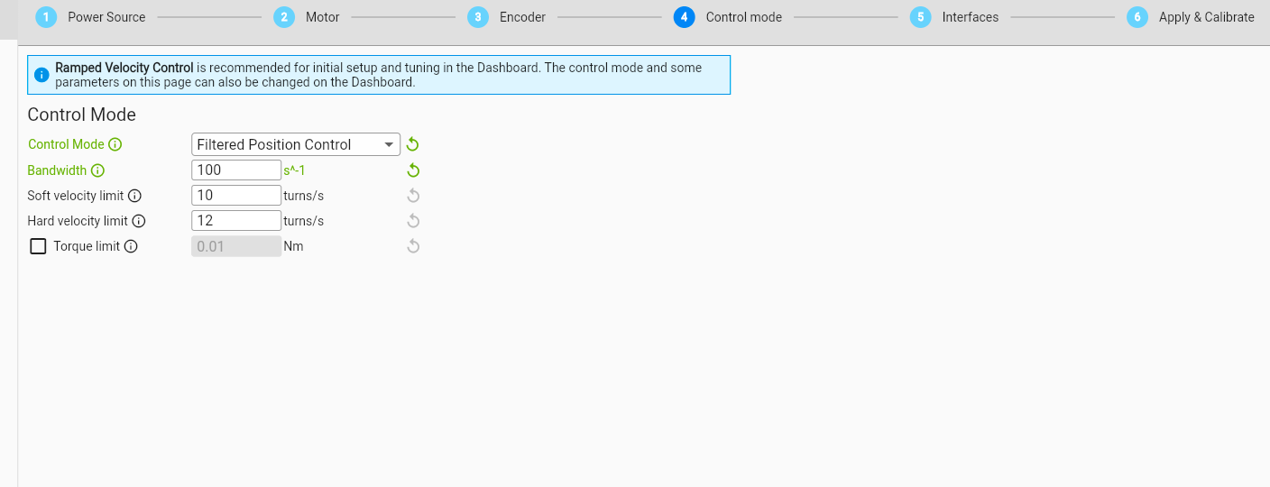

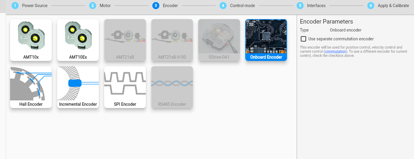

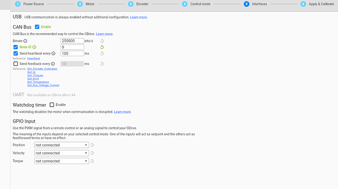

Could you post some screenshots of the GUI config as well as your Arduino code?

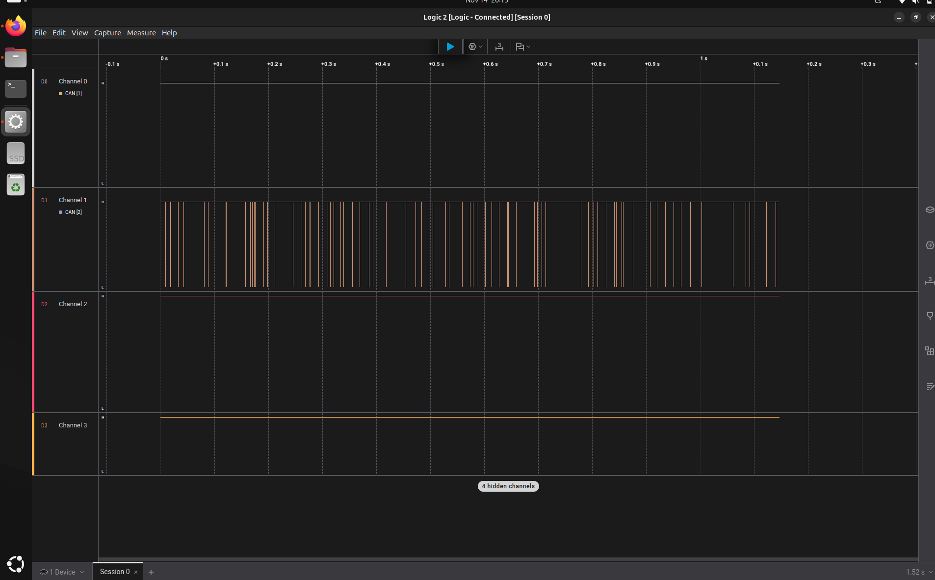

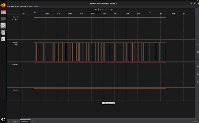

Hmm, well this all looks right. Would you mind sending a few pictures of your wiring? And do you have an oscilloscope or logic analyzer or anything like that?
this is what I get if I connect CANL and CANH from odrive to logic analyzer
