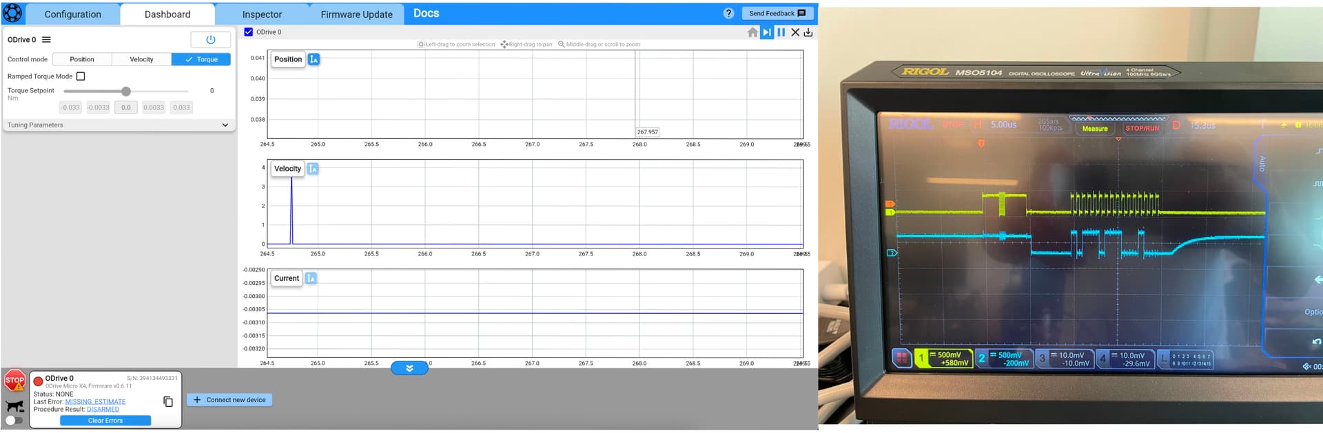

Hello - we are trying to get an AS5048a encoder working with the ODrive Micro; however, we’re bumping into several issues. We’re using an AS5048a Dev Board AS5048A-TS_EK_AB. MOSI is pulled high to 5V as per the ODrive docs.
The main issue is an intermittency issue - when viewing plots on the ODrive GUI, there are clearly points where data is missing. However, when viewing the MISO line on the scope, I can clearly see data.
This intermittency issue can be reproduced easily by physically disturbing the cabling in between the encoder and the ODrive Micro. We thought it might be a cabling related issue, but after testing numerous harnesses and reworking connections, it does not appear to be a component level or wiring issue with respect to the cabling. I have also tested changing up power sources.
I also scoped the V+ and GND lines to look for dips or bounces, but nothing seemed out of the ordinary,
Additionally, we observed that the ODrive Micro has some strange behavior that upon a power cycle or the above-described intermittency issue, it will reset the encoder position plot to 0. I was able to observe this behavior by: a) Setting the encoder position to a non-zero value as shown by the ODrive GUI, b) recording the scope readings, c) trigger a reset such that the encoder position shows 0 on the ODrive GUI despite not changing the physical position of the encoder, d) recording the scope readings. Before and after the position reset, the encoder readings on the scope looked characteristically the same, which makes me suspicious that the ODrive Micro is zeroing the reading for some random reason. Additionally, we put a scope on the PWM output of the encoder, and that value persisted between power cycles, intermittency, etc, which makes me believe the encoder readings are behaving as expected.

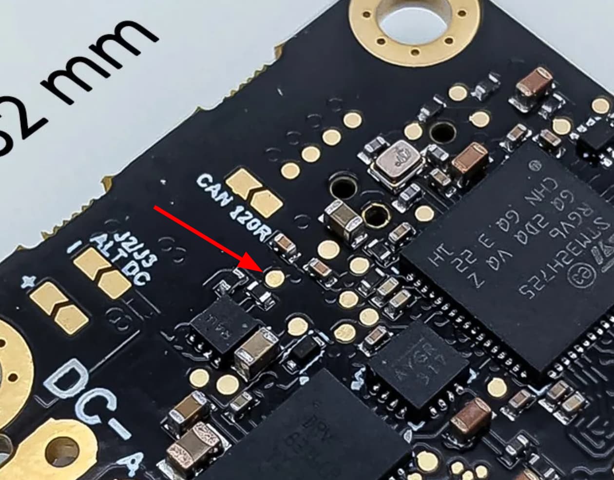

We ordered some MA702 and MA732 to test. I wanted to ask, these encoders are 3V3 and the ODrive Micro documentation says that these encoders are supported - but the SPI connector on board appears to be for a 5V encoder. Do I need to pull lines from the board, and if so could you advise where from the board to solder to for 3V3 SPI?
Hi there,
Yes, you’ll ideally need some sort of step-down regulator. Assuming you’re designing your own PCB, a simple LDO should work fine. If you’re referring to the MPS eval boards (e.g. this one), then you’ll ideally add an external 3.3V power source. However, you can derive power from the Micro’s 3.3V rail with some very careful soldering, from this test point:
That being said, it’ll likely be much easier to just have an external LDO powered from the Micro’s 5V rail to step down to the 3.3V the MA702/MA732 needs.

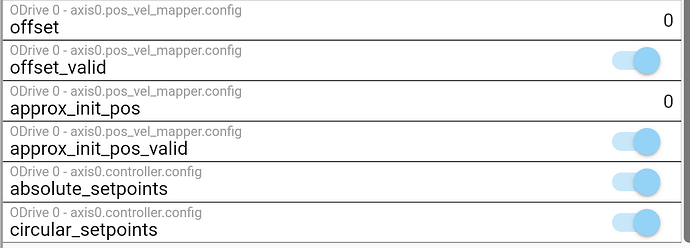

Thanks for the info - I was able to configure the settings you described. However, I found that this did not result in our desired behavior, which is preservation of the angle reading between power cycle of either the encoder or the ODrive board. Setting all the flags and values in the Absolute Encoder Reference Frame docs still resulted in a zero angle reading between ODrive power cycles.

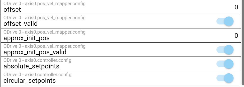

However, through some noodling, I found that setting the Absolute Encoder Reference Frame (circular) produced the desired power-cycle handling behavior. That being said, we would ideally like to have the angle tracking behavior not to be circular, so there’s a bit of a conundrum where we like the power-cycle handling behavior of the below depicted configuration, but it seems that there’s something deeper about the odrv0.axis0.controller.config.circular_setpoints flag.
Any advice would be greatly appreciated!
So just to confirm, in the picture you linked, if you disable circular setpoints and then reboot, the position will be initialized to zero on boot, no matter the motor/encoder angle?
Hello @solomondg
I just checked to reverify, and it seems that I must have done some sort of setups wrong when I sent my previous message. The behavior is good with circular_setpoints unset, so our issue is resolved. Sorry for the confusion!
