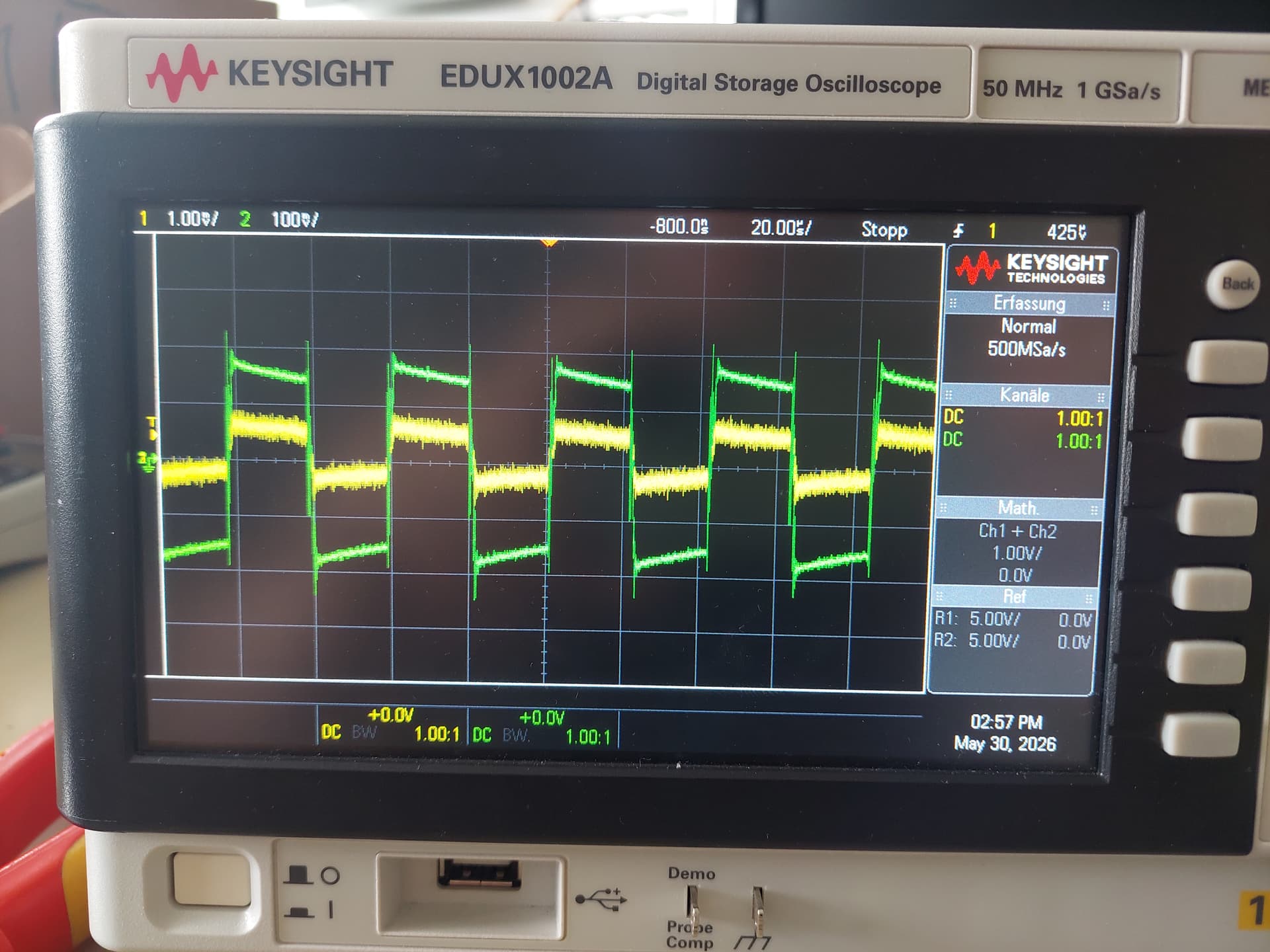

  • CAN Analyser V8.0 sees no messages
  • Arduino Nano with MCP2515 module (code from the official guide) also sees no messages
  • Line resistance between CAN-Hi and CAN-Lo: 60 Ω
  • Oscilloscope shows small square-wave signals when the ODrive Pro is alone on the bus; the internal termination resistor is enabled
  • Arduino Nano sending messages in 10 ms intervals with ODrive baud rate set to auto — ODrive does not detect the baud rate
  • CAN Analyser V8.0 does receive the Arduino Nano messages when all three devices (MCP2515, ODrive, CAN Analyser) are on the bus together

Hi! Apologies for the delay in my response.
That CAN waveform looks super sketchy, definitely looks like the motor switching noise AC coupling into CAN, which makes me think it’s a grounding issue. Would you mind sending a few pictures of how everything’s wired up?

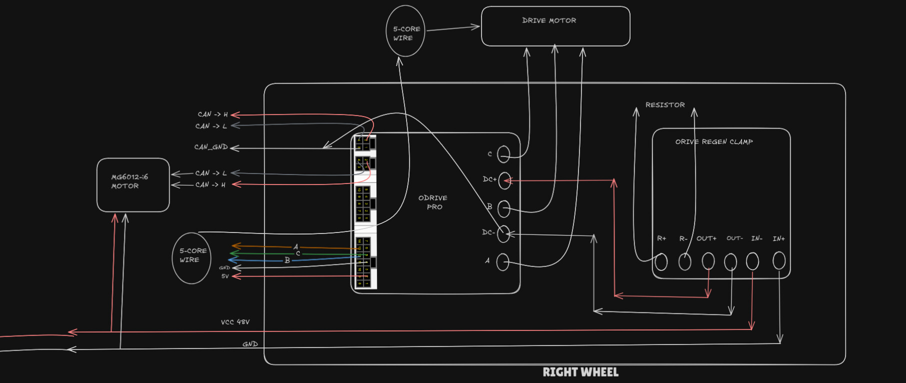

Our CAN wiring was as follows:
  • CANH connected to the controller CANH.
  • CANL connected to the controller CANL.
  • CAN_GND connected to the DC- terminal (48 V negative).
  • The Raspberry Pi side uses an isolated CAN receiver, and its CAN_GND is also referenced to the same DC- terminal.

Hi! What’s the measured resistance between CANH and CANL? And would you mind sharing some pictures of your wiring? And are you powering the board just over USB, or from the DC+ input? By default, the Pro requires power over DC+/DC- for the CAN circuitry to come online.
It’s pretty hard to kill the transceiver on a Pro – likely this is just a wiring or configuration issue.

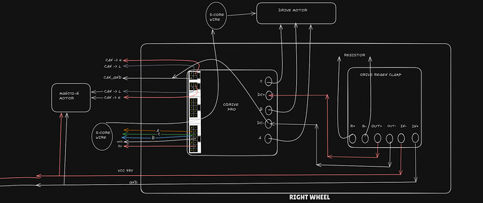

We are using three ODrive Pro controllers on a 3-wheel vehicle: one for the drive wheels and one for steering. Initially, we tested each wheel and ODrive individually, and all of them were working correctly over CAN.
The issue appeared only when all three ODrives were powered and connected together on the vehicle. In that configuration, only one ODrive continued sending heartbeats visible on candump can0 , while the other two stopped responding and did not transmit any heartbeat messages. At that point, we started suspecting possible damage to the CAN transceiver or another hardware component.
Unfortunately, we lost a total of four boards during our troubleshooting. In the first occurrence, the front and left wheel ODrives stopped responding on CAN. In the second occurrence, the left and right wheel ODrives stopped responding. This repeated behavior is what led us to suspect a hardware-related issue rather than a simple configuration problem.
I will also share pictures of the wiring setup. The boards were powered through the DC+ and DC− inputs, not only via USB.
And front odrive as node ID:0,left as node ID:2,right as node ID:4
Hi! Thanks for all the details, and apologies for the delay in my response.
Just to confirm, each ODrive had a tie between CAN_GND and DC-? If CAN_GND is connected between each ODrive, there should only be a single tie for the overall system between CAN_GND and DC- – this sets the GND reference of the CAN bus, so typically you’d do it at your power distribution terminal / busbar / battery.
All that being said, I’m generally pretty surprised any of this could’ve killed the CAN transceiver. Was anything on the bus damaged? Would you mind (while the ODrive is powered and connected over CAN) measuring the voltage between these two pads? It should be 5V

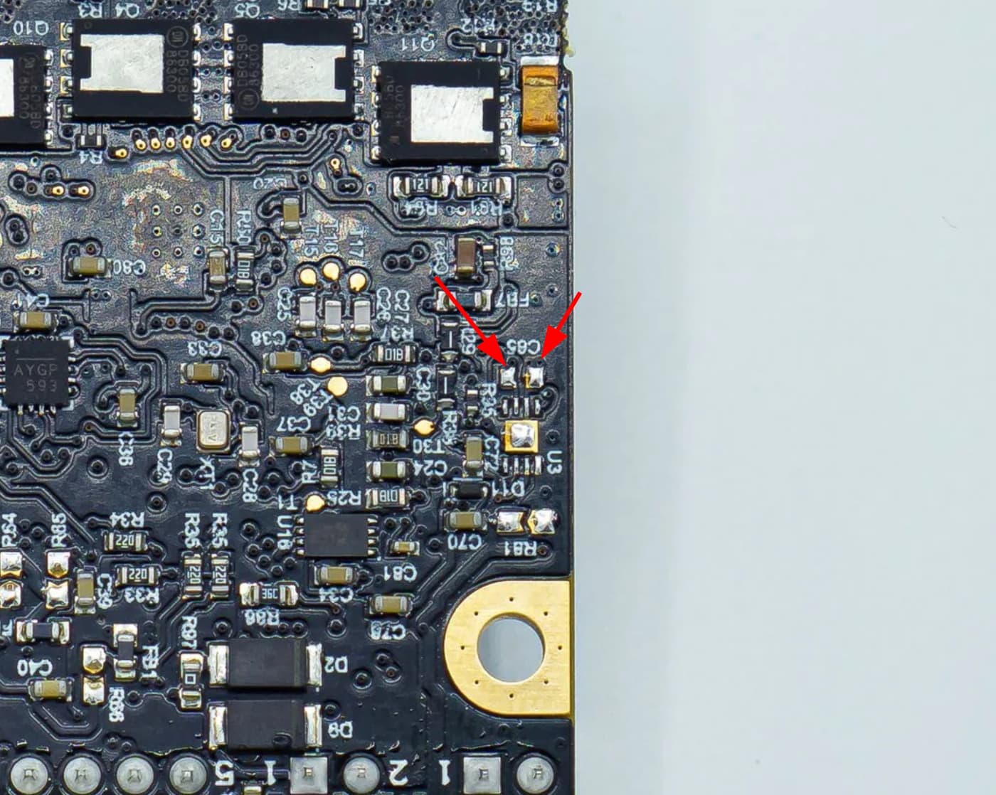

5 V pad measurement: reads 5.0 V with the board powered and CAN connected.
Also, with the CAN cable unplugged, the board’s CANH/CANL pins self-bias to
~2.2–2.3 V — so the isolated supply and the transceiver’s bus side are alive.
So on this board: MCU alive, isolated 5 V rail alive, transceiver bus side
alive, yet nothing crosses the isolation barrier in either direction. It looks
like the digital TXD/RXD path across the isolator is dead.

Hi! Thanks for all the information.
Generally while this would go against our what we recommend for wiring, I’m still a bit surprised this caused issues. Would be happy to send a replacement or two – could you shoot us an email at info@odriverobotics.com, referencing this forum thread?

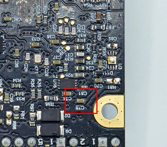

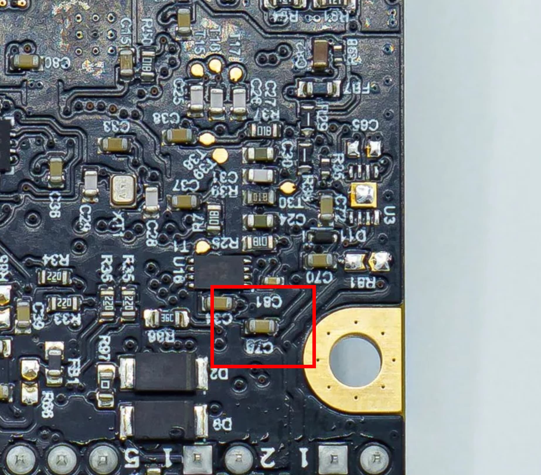

You definitely shouldn’t need anything fancy – just CANH/CANL/CAN_GND in a standard (twisted-pair for CANH/CANL) cable should be just fine.
One ask – would you mind checking the voltage across this capacitor (C78), with the board powered from DC-/DC+ and the tie from DC- to CAN_GND active? Should be about 5V:
