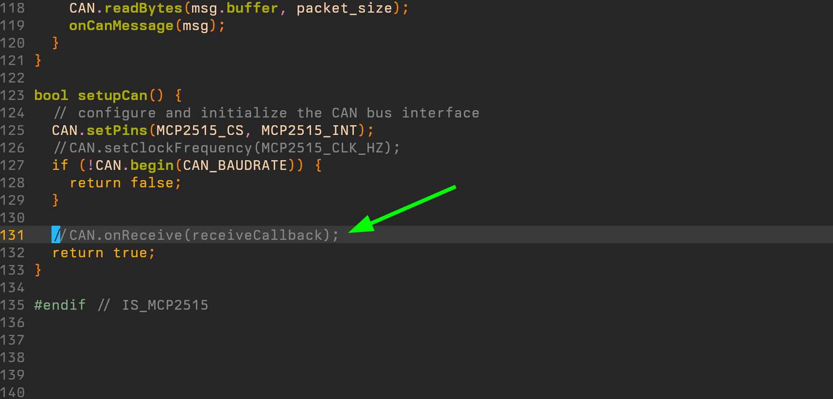

Hello ! I am experiencing the same problem with a ODrive S1 Can Interface. The only messages I receive have ID’s 9 and 1, so the cyclic ones.
odrv0.request(vbus, 1000) get no response
odrv0.setState(ODriveAxisState::AXIS_STATE_CLOSED_LOOP_CONTROL); neither
odrv0.getEndpoint() neither…
I’m searching but for now no idea what is the problem.
Hi! I would definitely double check that the node ID and baudrate are set, and not left at the default. Could you both run odrivetool backup-config config.json and paste the resulting config.json contents here? That’ll let me see the whole parameter tree.
Cc @jb803
Hi, thanks for your reply. In the Odrive GUI the node id is set (to 0 ) and baudrate too.
I have to add that the sinewave test motion works. So messages are passing through,one way (for the position control) and the other (for heartbeats and others cyclic messages). Even set state manage to power on and off the motor, it’s just it can’t get any response.
I will send you the JSON file you asked as soon as possible.
Thanks
Adrien
Interesting! So specifically everything’s working except for the request and getEndpoint messages? Can you post your overall Arduino code?
Well my understanding is more that ODrive doesn’t send messages except the cyclic ones. In fact for instance it seems that my function setVelocityLimit works (without acknowledgment response) but getVelocityLimit doesn’t.
Here is the code : it’s the sineWave example slightly modified for ESP32S3 with MCP2515 with additional functions home made in order to test those problems.

bool setupCan() {
  // configure and initialize the CAN bus interface
  CAN.setPins(MCP2515_CS, MCP2515_INT);
  //CAN.setClockFrequency(MCP2515_CLK_HZ);
  if (!CAN.begin(CAN_BAUDRATE)) {
    return false;
  //CAN.onReceive(receiveCallback);
  return true;

Two issues:
  1. I think your endpoint IDs are wrong. I would definitely double check your endpoints against the flat_endpoints.json matching your ODrive and firmware version.
From your code:
static constexpr uint16_t EP_VEL_LIMIT        = 213;
static constexpr uint16_t EP_CURRENT_SOFT_MAX = 215;
But on an S1 running 0.6.11 firmware, axis0.controller.config.vel_limit is endpoint ID 374 and axis0.config.motor.current_soft_max is endpoint ID 305. Endpoint IDs 213 and 215 actually correspond to axis0.current_state and axis0.pos_estimate. I’d make sure you’re using the correct file from here: ODrive Releases
  1. Here’s the main issue – this line is commented out :slight_smile:
As a result, the received messages are never getting routed to your code, which explains why you can send but not receive. Try uncommenting that line and see if things work!
Wow I don’t remember why I commented this line. Thank you a lot for the quick answer, obviously it should be this, I will try it tonight.
Sorry to bother you with such a silly mistake.
I will verify and confirm this quickly.
No worries, glad I could help, and I hope that’s the issue! Let me know how it goes!
