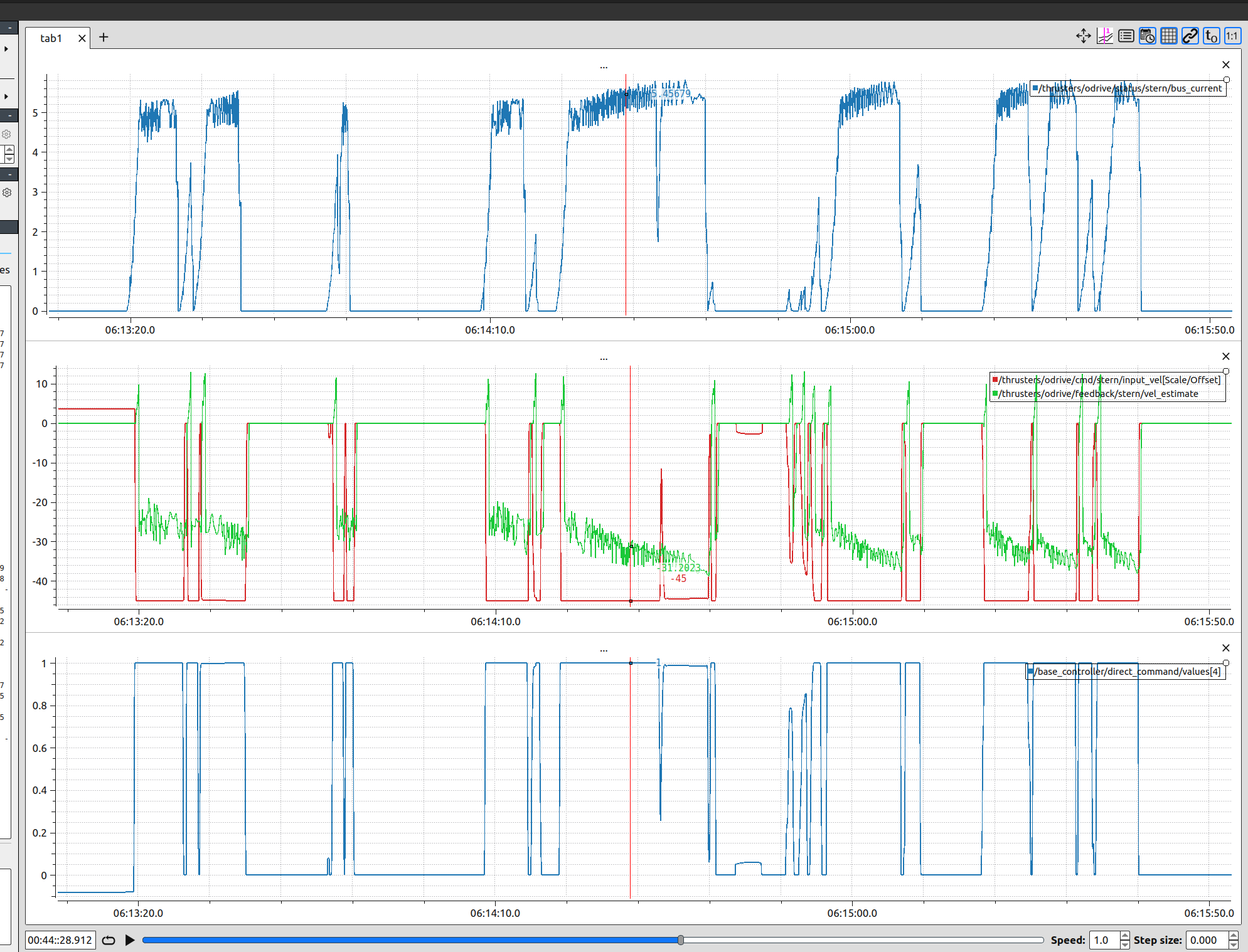

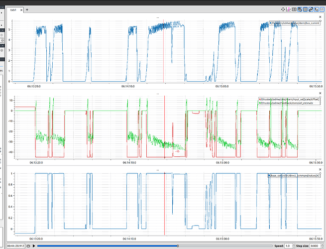

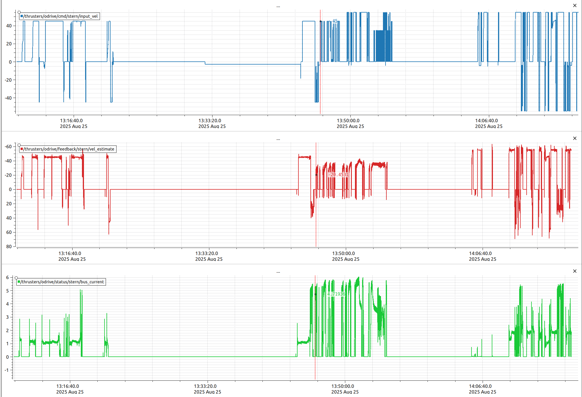

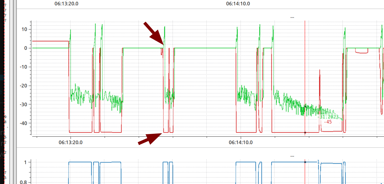

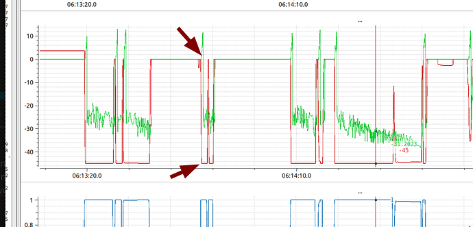

Odrive Pro motor giving feedback even though shaft is not moving
Configuration:
axis0.active_errors = 16777216

ODrive Pro module version: 0.6.10
Power supply input: 48V
Thruster configuration: T500 thruster from BlueRobotics with customized propeller
Firmware/driver: using refactored Odrive-github
  • Graph 1 → input command sent to ODrive
  • Graph 2 → feedback signal from ODrive
  • Graph 3 → bus_current feedback from ODrive
As seen in the attached screenshot, when we send certain command inputs to the controller, we observe that the feedback signal reports some nonzero value, even though the motor shaft itself is not moving. At the same time, we also notice a spike in bus current.
This issue has happened multiple times, especially after giving a reverse velocity command. It only occurs occasionally and does not appear to be limited to any particular input velocity range.
Could you please help us identify the possible root cause of this issue?
Hi! You’re running in sensorless control, correct? Sensorless doesn’t support low speeds (usually under 1-2V * motor KV, so here it would be 100-300 RPM or so) or changing directions. To switch to negative thrust, you would have to set the axis to idle, change the sign of axis0.config.sensorless_ramp.vel, then put the axis back in closed loop control.
As you can see below, we are operating well beyond the minimum speeds required. the values you see here are in rad/s. I’ll check on the negative thrust implementation once again but it never gave us issues with 24V configuration.
You can see from observations that sometimes it is able to reach command velocity and sometimes not. And the motor current remains high. And again, in all these cases, even though from feedback I can see that there is some velocity output, the propeller attached to the shaft was not rotating.
For reference, I’m sharing the configuration we have for 24V input,
Power supply input: 24V
