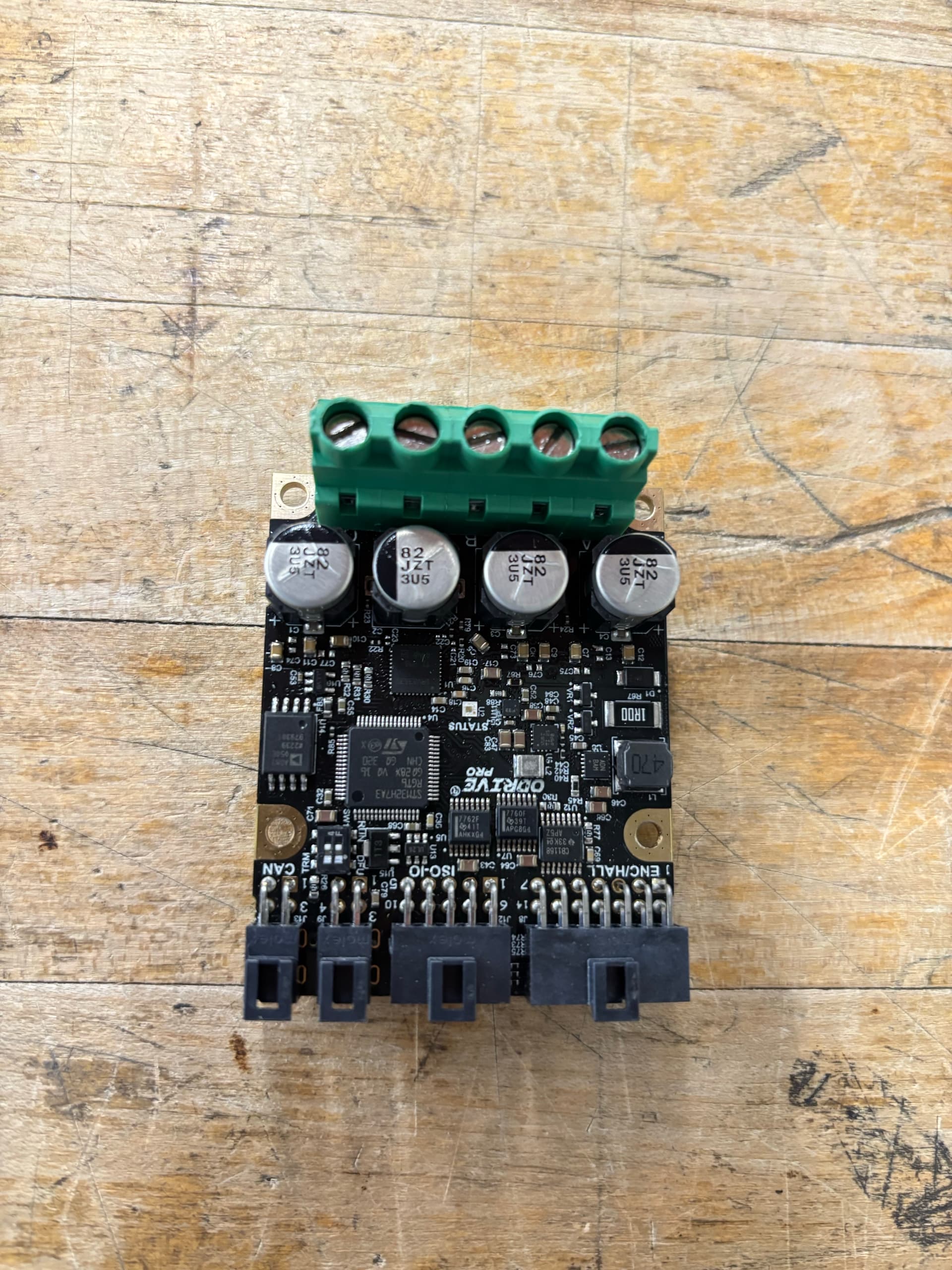

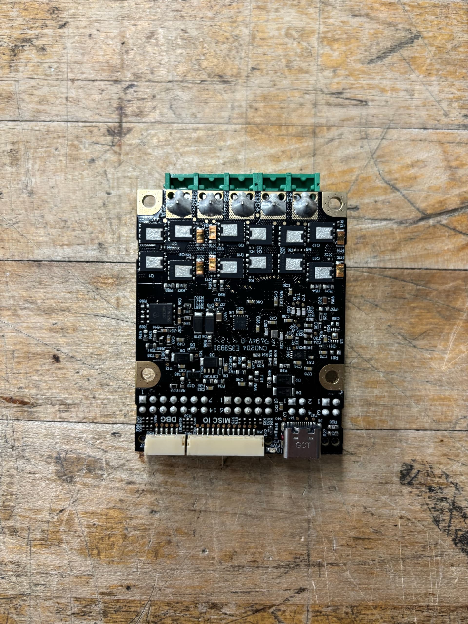

Hi! Thanks for reaching out, and for the detailed description. Not a known defect, it does sound like a possible hardware issue. Did the Pro have this issue out of the box, or did it happen after some use? Could you send some pictures of the top/bottom of the board?
Hi! Thanks for the reply. I’ve attached pictures of both the top and bottom of the board.
The ODrive Pro had been working correctly before the issue occurred. We were running it at 24 V with a velocity setpoint of 1 rev/s. We were performing tests, and at one point, when we started another test after modifying our ESP32 code, the DC_BUS_UNDER_VOLTAGE error appeared. We’re not entirely sure what caused it, as we didn’t make any intentional changes to the power supply or motor command that should have damaged the drive.
We were using a regen clamp with a 50 W, 2 Ω resistor. At the time the issue appeared, the drive was operating at only 24 V and 1 rev/s, so we wouldn’t expect these operating conditions to have caused a component to fail. There was no unusual smell, visible damage, or other obvious sign of a hardware failure.

Gotcha, thanks for the pictures!
I totally agree that your use case shouldn’t have had any risk whatsoever of failure.
Quick test – when powered over USB, and from ODrivetool or the GUI, what does vbus_voltage and axis0.motor.fet_thermistor.temperature show? The former should be 0-2V and the latter should be around your ambient room temperature plus board quiescent temperature rise – maybe 25-45 C. You can also repeat the test when powered from e.g. 24V.
That’ll help bisect a failing analog rail / ADC from just a blown bus voltage sense divider.
