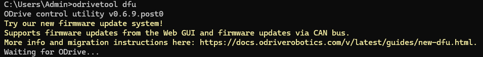

Hello,
I have problems triying to update the firmware to v0.5.6. I have Odrive v3.6-56V with ODriveTool v0.6.9
I put the switch in DFU mode, but the Odrivetool is waiting for the Odrive…
In the hardware administrator appears the Bootloader…
What’s wrong?
Try this? Legacy Firmware Update — ODrive Documentation 0.6.11 documentation
