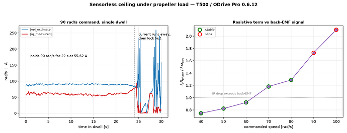

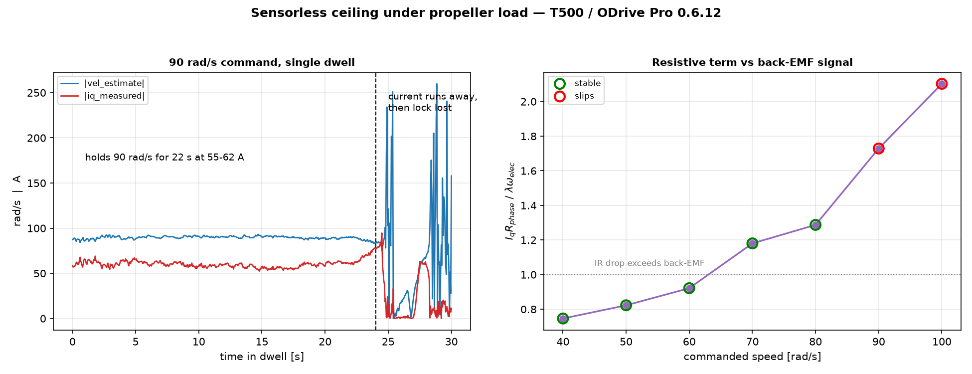

Graph 1 → the 90 rad/s dwell: 22 s holding the setpoint at 55-62 A, then iq runs
away to 78 A and commutation is lost. Graph 2 → the resistive term divided by the
back-EMF term at each level, green stable, red slipping.
Below 80 rad/s tracking is exact and steady. Above it the axis holds the setpoint
correctly for a while and then loses lock, and the time it survives shrinks as
speed rises — 22 s at 90 rad/s, 4 s at 100. After the loss, vel_estimate reports
speeds up to 157 rad/s at near-zero current, so the estimate stays plausible while
the shaft is not turning at anything like that.
What we think is happening: a propeller is a square-law load, so current grows as
omega^2 while the back-EMF the observer works from grows only as omega. The
resistive term therefore overtakes the back-EMF term linearly with speed. Using
the automatic flux linkage (2/3 * 0.04544 / 7 = 0.004328 Wb) and the calibrated
phase resistance of 0.0759 ohm:
cmd rad/s   Iq*R      lambda*w_elec   ratio    result
   40       0.90 V       1.21 V       0.75     stable
   60       1.67 V       1.82 V       0.92     stable
   80       3.09 V       2.40 V       1.29     stable
   90       3.96 V       2.41 V       1.64     slips
  100       6.15 V       2.93 V       2.10     slips
(The phase resistance above was calibrated before we raised calibration_current
to 40 A, so it may shift once we recalibrate; it is a common factor across all
the levels, so the ordering is unaffected.)
The boundary falls between 1.29 and 1.64 in every run. That would also explain the
delay before failure: there is no motor thermistor on this unit, phase_resistance
was calibrated cold, and at 50-80 A the windings heat quickly during the dwell, so
the resistance the observer is using drifts further from the true value the longer
it runs — fastest at the highest current, which is the order we see the failures in.
Could you please advise whether this ratio is the right thing to be designing
against, and what the practical ceiling on it is for reliable sensorless operation?

Could you please advise whether this ratio is the right thing to be designing against, and what the practical ceiling on it is for reliable sensorless operation?
Not quite. The observer subtracts I*R using the configured phase_resistance, so the resistive term itself is fine as long as R is accurate – with a good R, a ratio of 2+ works. What affects things is the error in that subtraction (R drifting with temperature, plus any inverter voltage drop that the observer doesn’t see); the ratio is just how much that error gets amplified. Also, 90 rad/s should be 2.73V of back-EMF, not 2.41 – that point is ~1.45.
For a square-law load that works out to roughly the same tolerable R error at every speed: at sensorless_observer_gain = 200, lock is lost once the true (hot) resistance is ~40-50% above the stored value, i.e. around 100°C of winding rise from wherever you calibrated. So the sweep is really measuring how fast the copper heats (I²R), which is why survival time shrinks with current rather than there being a hard speed boundary.
That’s a lot of heating for 22s though, so worth confirming directly: run MOTOR_CALIBRATION immediately after a 90 rad/s failure and compare to cold. Every 4% on R is about 10°C. If it comes back under +20% or so, this isn’t the mechanism.
Things that can buy you margin:
  • sensorless_observer_gain = 100. Doesn’t change the heating, but the tolerable R error goes to roughly +65%.
  • Calibrate hot (right after a run) at 40A. Erring high on R is safe and erring low is not – the inverter drop looks like an extra ~15-20% of R at 50A, so a slightly high value actually cancels it. You can also just increase the configured phase_resistance by 20-30%. Even better, if you have an LCR meter, it would be good to get a source-of-truth measurement from that, both at cold and at hot.
A few questions:
  • How long between the 90 rad/s failure and the 100 rad/s run? The 4s only fits the picture if the winding was still hot.
  • What did the 40A calibration give vs 0.0759?
