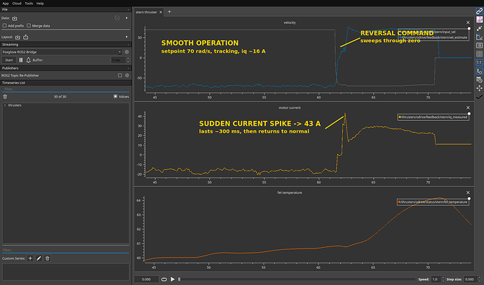

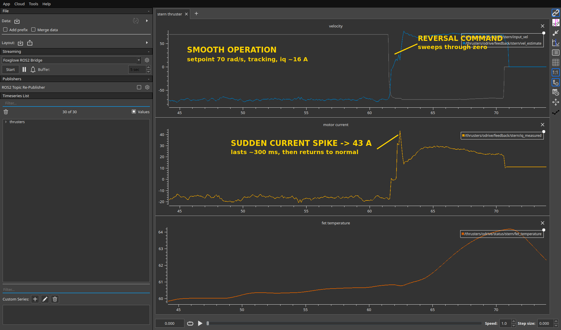

Sudden motor current spike on deceleration or reversal, sensorless T500 (ODrive Pro 0.6.10)

Graph 1 → velocity setpoint and vel_estimate
Graph 2 → iq_measured (motor current)
Graph 3 → fet_temperature
As seen in the attached screenshot, during steady operation the motor current stays around 15 to 20 A and tracking is good. Whenever the velocity command decelerates or reverses, the motor current suddenly spikes to current_soft_max (43.5 A) for a few hundred milliseconds. Most of the time it recovers on its own, but sometimes the drive disarms with CURRENT_LIMIT_VIOLATION and the thruster stops mid operation.
We tried lowering dc_max_negative_current to -26 A and running motor calibration on the unit (measured phase resistance 0.080 ohm against the configured 0.0735). That eliminated the CURRENT_LIMIT_VIOLATION trips on a bench reproduction, but the braking energy now trips DC_BUS_OVER_VOLTAGE instead (max_regen_current = 0, pack rests near 49 V against the 51 V trip level).
Could you please help us identify the possible root cause of this issue?
Hi there,
The spike itself is generally expected behavior – in velocity mode the ODrive applies whatever torque is needed to track the setpoint, including actively braking, so a step decel or reversal will command straight to current_soft_max. With input_mode = 1 (passthrough) your configured vel_ramp_rate isn’t used – I’d switch to input_mode = 2 (VEL_RAMP) so decels are rate-limited. You can keep streaming Set_Input_Vel at 30-50Hz as normal.
Recalibrating is what actually fixed the CURRENT_LIMIT_VIOLATION trips – that error means the measured current overshot current_hard_max, and a stale phase resistance can definitely do that (dc_max_negative_current doesn’t affect that error). Worth also verifying torque_constant, since manufacturers frequently spec kv wrong and the sensorless estimator is sensitive to it. You can do a quick bench characterization if you spin the prop out of the water to a known RPM (maybe around 1/2 to 3/4 of max free speed), and calculate kv = RPM / (sqrt(3) * v_current_control_integral_q) (then torque_constant = 8.27/kv).
For the overvoltage: max_regen_current isn’t applicable to the Pro, it’s only for ODrives with a brake resistor stage. What you want is axis0.config.I_bus_soft_min – set it to the charge current your pack/BMS will actually accept, and the ODrive will limit braking torque to stay within that rather than tripping errors. Keep dc_max_negative_current a bit beyond it as the hard protection.
As a general note though, sensorless is not meant for direction reversals; if it works then that’s great, but it’s absolutely not guaranteed to work. For direction changes, I’d recommend putting the axis in IDLE, waiting a few seconds, then inverting the sign of axis0.config.sensorless_ramp.vel, then re-entering closed loop.
