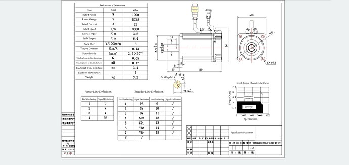

Hi, Thanks for your reply.
Here’s the motor:
The peak torque is 3x rated torque, confirmed by the manufacturer. Similar motors are sold by stepper motor online https://www.omc-stepperonline.com/dsy-series-1000w-rs485-dc-servo-motor-24-70vdc-3-20nm-3000rpm-17-bit-incremental-encoder-ip65-dsy-rs1000l2a2-m17s , Leadshine, and many others. The peak torque is always indicated as 3x rated (9.6).

The motor manufacturer did not provide the KV. I calculated it as 3000 rpm / 48V = 62.5 KV

The rated speed of the motor (3000 RPM) is typically the speed the motor can achieve at the rated torque of 3.2Nm.
If we take their back-emf constant of 8V/1000RPM, that gives us a KV of 125 RPM/V. However, if we take their rated torque @ rated current, that gives us a KV of 8.27/(3.2/25) = 64 RPM/V. Definitely some discrepancies here :slight_smile:
If we assume instead that’s V_rms and A_rms then that’s 88 KV from the back-emf constant, and 91KV from the rated speed/torque – that lines up a bit better. Plus, that matches if we assume their stated torque constant is in Nm/A_rms instead of Nm/A_pk (which the ODrive uses) – 0.13 Nm / (sqrt(2) A) = 0.09 Nm/A == 90KV (convert from rms to peak voltages by multiplying by sqrt(2).
So I’d generally say that the actual KV is going to be about 90 RPM/V, and actual torque constant around 0.091 Nm/A. That means for a peak torque of 9.6Nm, you’ll need about 105A.

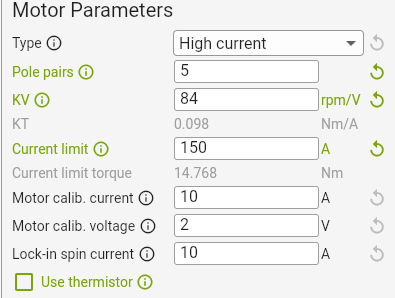

I followed the suggested procedure and plotted the resutls below. I selected a KV of 84 rpm/V.
I updated the KV in the configurator (84 KV; resulting in KT = 0.098 Nm/A):
Using the position control dashboard, a torque of 9.5 Nm was measured (with the current still limited to 100 amps). This is a very strong result: [(9.5 - 0.098*100)/9.5] x 100 = 3% error. I’m not concerned about this error - perhaps I could reduce it by adjusting the KV but for now I’m very happy with the result.
The only topic outstanding is the Torque Control Mode: When I switch to torque control mode and go go the torque control dashboard and enter 9.5 Nm, I expect the output torque to be 9.5 Nm and the motor current to be 100 amps (just like in Position Control Dashboard), but the output is about 8.2. This seems to be closely aligned with the “effective_torque_setpoint” (8.33) but I do not know why because I do not have a torque limit enabled in the configuration. Can you share guidance on how to yield torque output that is equal to (100%) of the input_torque?
Lastly, though I don’t think it was needed I did recalibrate using 25A calibration current, 4V calibration voltage (needed to raise it from 2V), and 25 A lock-in spin current. Results are below. I did check the output torques again after the recalibration and they remained 9.5 Nm via Position Control Dashboard and 8.2 Nm via Torque Control Dashboard with 9.5 Nm torque input.
enable_torque_mode_vel_limit uses vel_gain to limit the torque. At high torques it can be limited even at zero speed, see: Controller — ODrive Documentation 0.6.10 documentation
You can disable enable_torque_mode_vel_limit, or you can tune your vel_gain.

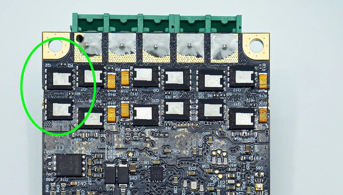

I have attempted two full power diconnect/reboots and the issue persists so I beleive this indicates damage to the driver or FETs. I ordered two new Odrive Pros #12689.
In the meantime, is there any troubleshooting I can do and/or can I replace the driver or FETs? I have a hot air rework station, etc. Thanks!
Huh, that’s not great. This is with 12S LiPo + Pro on a heatspreader, with the green thermal interface material?
Hi, This was with a 14s and an Odrive Pro with the enclosure and fan; thermal interface material installed between fan and enclosure. The fan was running because I lowered the threshold to ensure it was on. The battery was charged to 55V. The Odrive was cold. I believe the failure occurred when the rotor was stopped suddenly during a collision.
Oh interesting. Specifically, wanted to check if the green thermal material was installed between the Pro and the enclosure:
That being said, could you tell me a bit more about the collision? Approximately what speed was the motor operating at, and was the ODrive actively driving it? If so, about what current was going through the motor?
No, that wasn’t where I placed the thermal pad. Thanks for letting me know the correct placement; I’ll be sure to assemble it there in the future. That might have contributed to the issue, but I don’t think so, since the ODrive was cold, started and ran for less than a second, and then experienced a collision and failure. I don’t believe there was enough time for any significant heat buildup or dissipation.

FETs are FDMS86300DC, gate driver is DRV8353S. Your DRV fault indicates a gate drive fault on the high-side FETs on phase A, which would be Q1 and Q2:
That being said, happy to replace this under warranty – this is the sort of failure that I very very rarely see on an ODrive Pro (the field failure rate is effectively zero), and would be interested in getting the unit back for diagnostics.
Could you let me know where the thermal pad was placed? A picture of the pad residue on the Pro (when disassembled from the enclosure) would definitely be helpful. My thinking is that even if the unit was cold, the thermal mass of the FETs is quite low, and a local hotspot created by the large current spike, combined with incorrect thermal pad placement, could lead to the FET getting real hot and desoldering or damaging itself.
I’m embarrassed to admit it, but as I mentioned yesterday I installed the thermal pad between the aluminum enclosure and the fan sink. I thought it was to facilitate heat transfer from the enclosure to the fan sink. In retrospect in makes sense for it to be in contact with the FETs, but I’ve never used thermal pads/paste. I did not find assembly instructions for the fan and enclosure and looking at the CAD from a bad angle reinforced my incorrect assumption that the pad was between the enclosure and fan sink.
