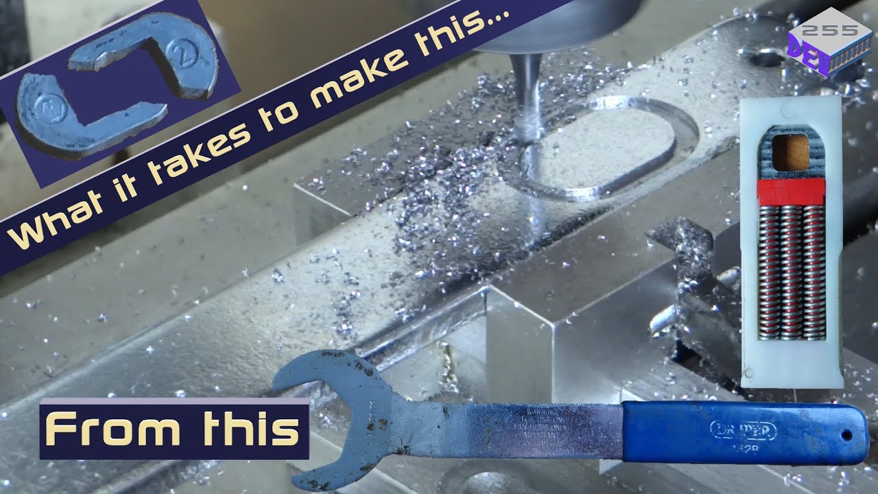

I have now successfully tested out my programming skills by machining out this part.
The Arduino Mega 2560 now accepts standard G-Code to churn out parts. Now all I need is an Z Axis and a spindle motor fitted, where I have the pulleys and am currently 3D CAD’ding the Z-Axis and Spindle components. I’m going with a 1:1 ratio on the spindle motor and may even add a small flywheel to the spindle shaft as a torque reservoir, hmmm…
With the G-Code, admittedly, I have only programmed G00, G01, G02 and G03, although 02 & 03 are the hardest to achieve, where I had to get my head back in to trigonometry and work out arc radians, feed speeds at different radii and all manor of other calculations and conundrums to make it all work, including maintaining backlash control, hence the time taken to get to this point.
Hope you like the latest video.
P.S. I used lubricant on this one @Jerry.Atrick :wink:
