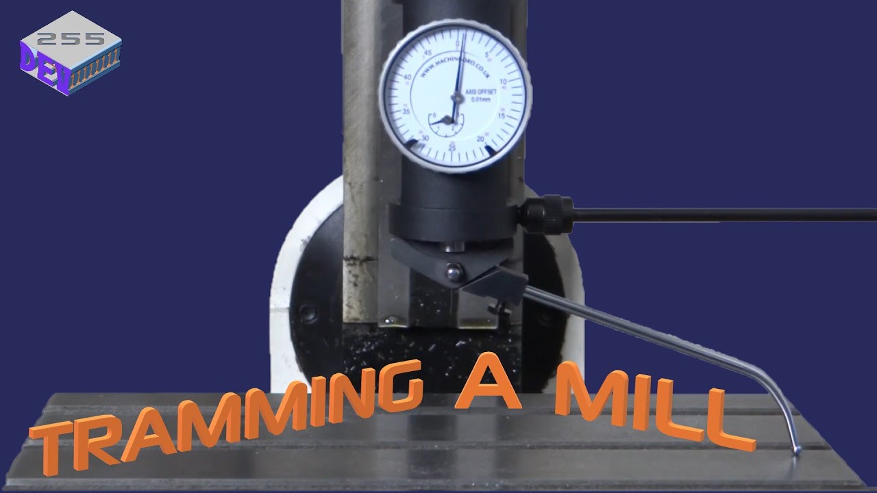

What did you do to calibrate out the backlash btw? From your test patterns you seem to have done it perfectly. Have you implemented that as part of the arduino code?
Also, how did you get your mill so well trammed? Mine’s as wonky as a witch’s beach hut compared to that.

I have a set value for both X and Y Axes where the backlash has a boolean value on each axis for whether it’s in or out and whenever there is a change of direction it takes out the backlash first at 300000 cps then carries on with the cut at required feed speed, it even works well with both tables locked (I accidentally found out) as there is lots of torque in the drive unit (maybe too much), but that could be of benefit (apart from increased wear) to keep the table solid on some parts. There is also a zero function that works well. Everything is controlled with the Arduino Mega 2560 and there is plenty of room for extra code. Also, the code is getting more like G-Code every time I tweak something, so there is GlobalMove function that runs all the movement and this is similar to G0, LineMill that controls all Axes, interpolating movement to reach a target position at the same time, while controlling feed speed. Then CircleMill controls CW/CCW direction, tool size, internal/external feature, arc length, feed speed, etc. So it’s all very busy :dizzy_face:.
I just ordered the X1-105 Long Table for the X-Axis also so I’ll have 460mm x 145mm of usable milling area.
Here is my tramming explanation video: -
