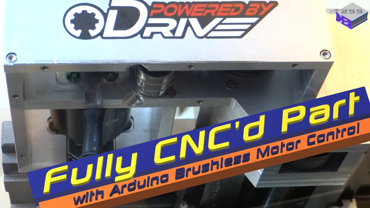

Hi all,
I am still here and plugging away at the CNC machine and other projects.
Well done to all those at ODrive and those that support them on here, this is a fantastic system that I can rely on for CNC work. Thank you.
Here is what it looks like now, with the new long table, where it’s proving to be very valuable, especially with all that time-saving.
Sorry @Jerry.Atrick I haven’t yet tried the tape and glue holding solution yet (I’m not that brave, but have been looking into slide clamps as this would probably work best with my long table.
Well here’s the latest video (hope you enjoy): -
Please feel free to comment and suggest anything you feel is missing or you liked.
Thank you,
Kind regards,
Neil.
