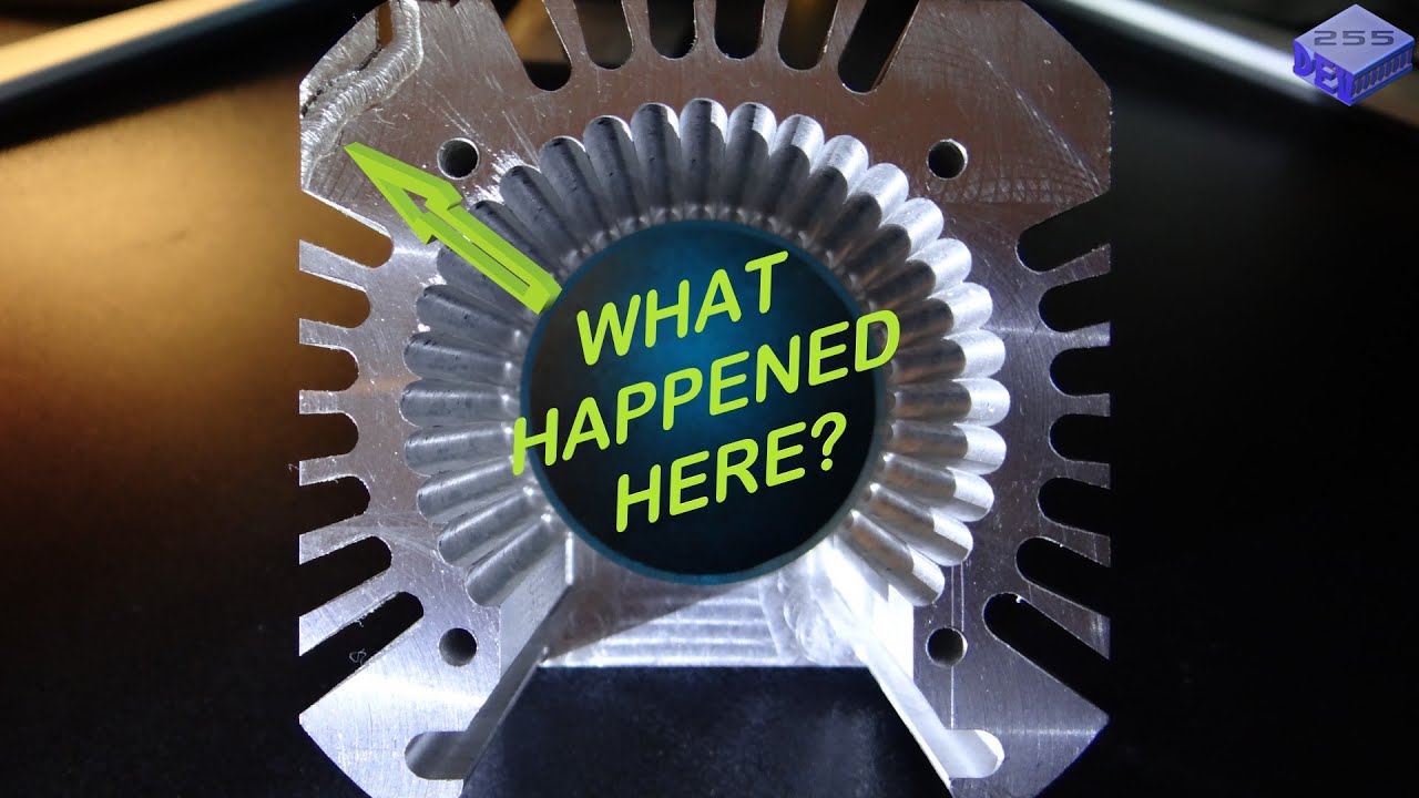

Hi All,
Just posting my latest video of the ODrives hard at work milling out this complex heatsink.
Yes this heatsink fits around the ODrive D5065 270KV motor and will hopefully keep it nice and cool as it will be used as the spindle motor. I’ve just finished all of the components for the spindle drive, so hope to get all those videos out before the event.
Happy ODriving,
Neil.

I haven’t been on for a while as I was at the Birmingham NEC (UK) Makers Central event with the ODrive mill churning out chips with a 40mm cutter on the new ODrive spindle. These motors are very impressive.
I’ve also put in automatic crash control, which is simply just monitoring the RPM of the spindle and when it drops below 10% of the requested speed (for the 40mm cutter) all the axes and spindle stop, even between GCode so that it doesn’t brake the cutter, this I demonstrated at the event 4 times and it didn’t break any cutters.
The % drop reduces depending on the cutter, where the GCode says which tool to use it adjusts accordingly, I’ll have to do a video on this. So 4% drop for 10mm, and 3 percent for 8mm, and so on, although smaller bits are difficult to get right.
I was thinking of having it slow down the feed speed and continue cutting.
The machine running at 4000RPM (5500 possible at 27.5V, tested at the event on a 30V 20A power supply) was capable of 50mm / min through .25mm of material with the 40mm shell mill. It really hit the acrylic windows with some force and could be heard in the noisy environment.
At the event the machine only consumed aroun 260W maximum with the 40mm cutter where I could demonstrate why the ODrive and brushless motors is a good option for solar powered milling at home.
