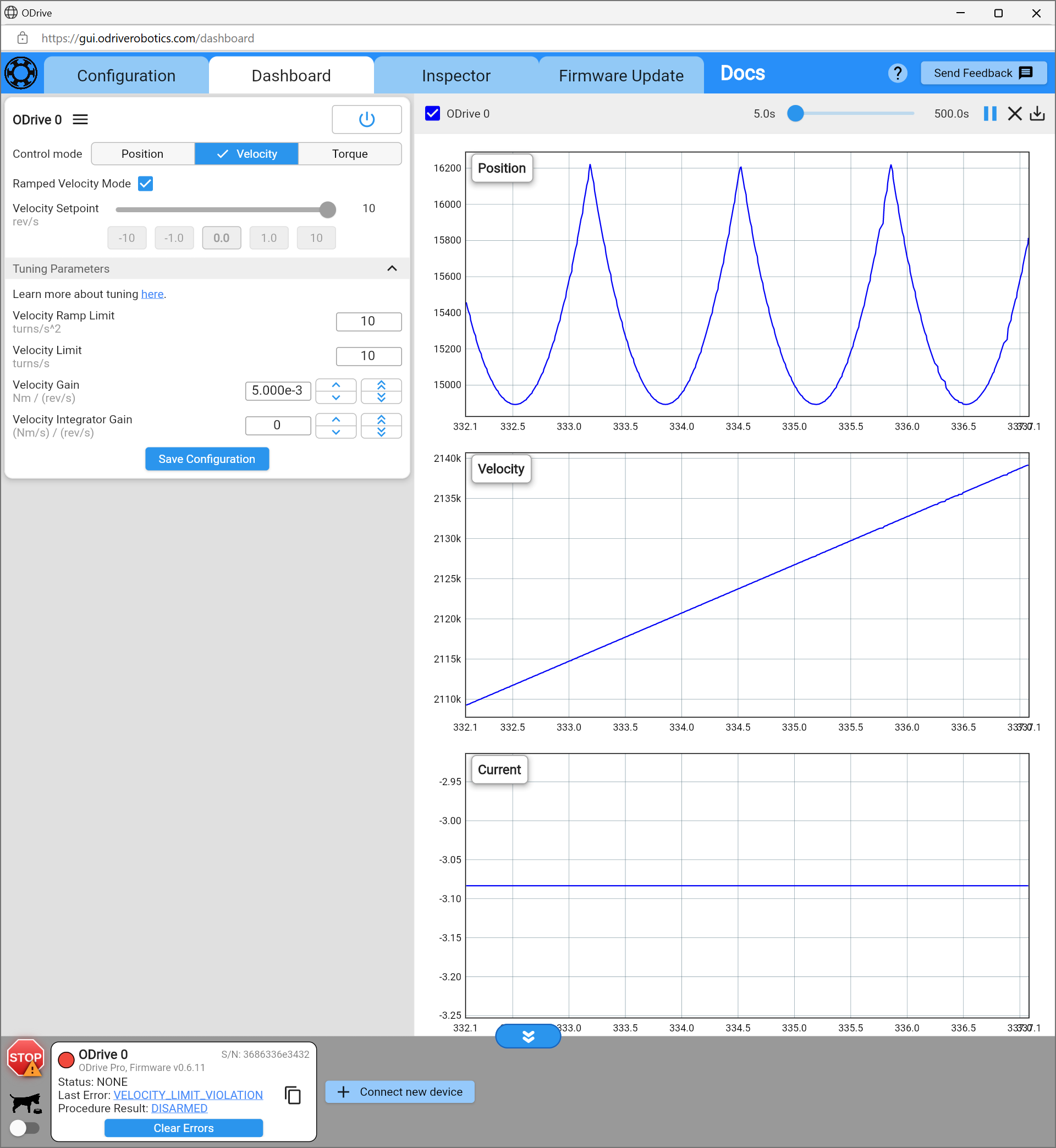

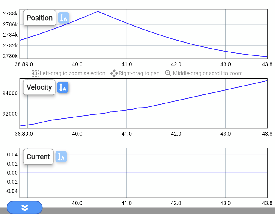

I’m trying to run a Portescap 35ECS80 10B 11 motor with my odrive pro, but whenever I try to control with velocity, it’ll move for a second and then error out and stop with the position oscillating and the velocity running away. Any idea what could be going on? I’ve tried playing around with the gains and setting no integrator gain and setting the velocity gain very low but nothing. It seems to calibrate just fine.

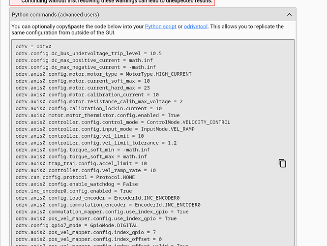

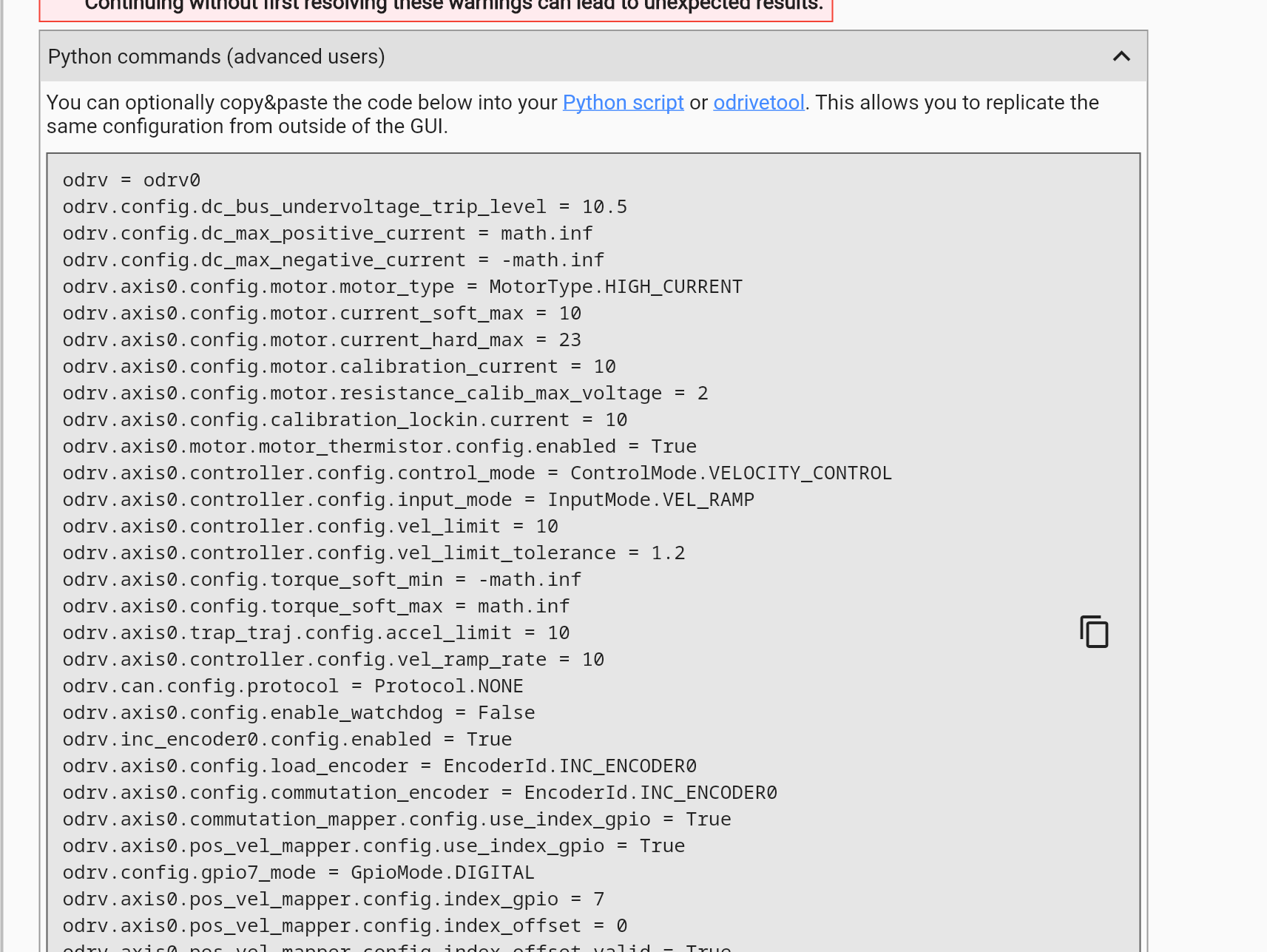

Interesting! Can you show your config, either via screenshots of each page in the config tab, or via the “python commands” page on the final config step?
here ya go!
it seems like something is going on with the velocity estimator
Yeah, I’m not sure why the velocity estimator thinks you’re going at 2000k rev/s, that’s a lot :slight_smile:

  2. When the ODrive is in idle, and you move the motor just by hand, does the vel_estimate seem reasonable? Or does it spike super high again like this?
  3. Does this issue only show up at very high speeds, or does it persist even at low speeds?
  4. Does the velocity estimate settle to zero when the motor’s not moving, or does it stay at those high speeds?

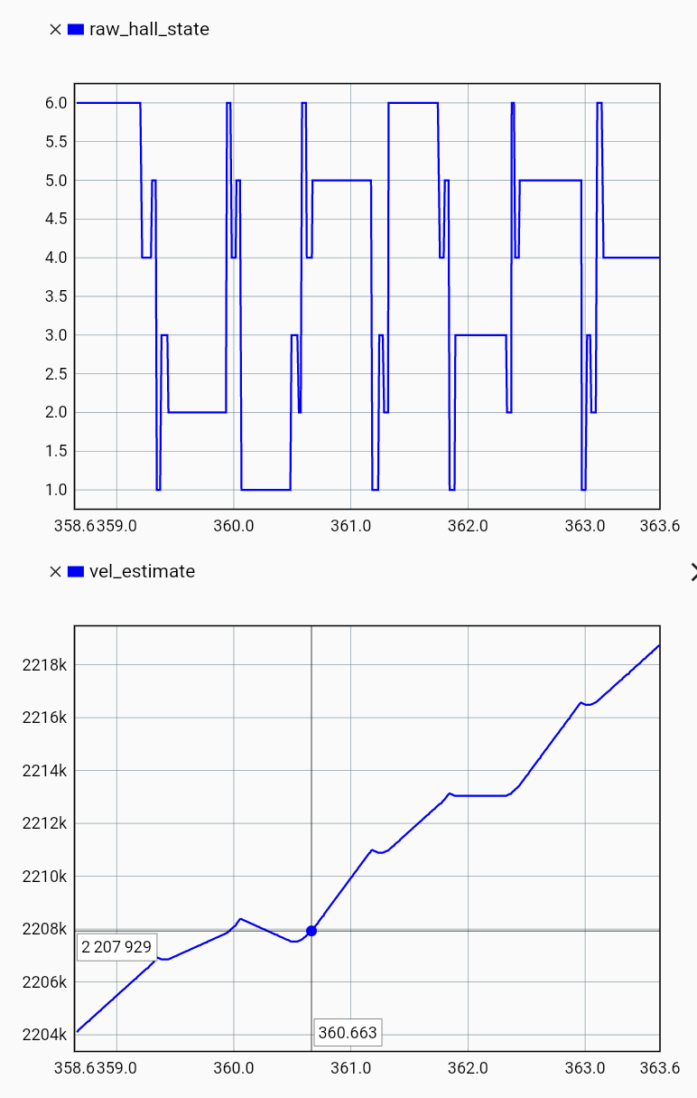

  2. When in idle, even it starts at 0 for everything, spinning the shaft manually causes the vel estimate to go crazy as shown.
  3. Happens at all speeds.
  4. Velocity estimate continues to climb as shown even after the odrive has errored out and the motor is not spinning. Sometimes when I unplug the odrive to reset the values, it’ll actually still think the velocity is increasing after I’ve plugged it back into my laptop.

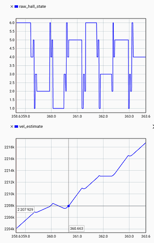

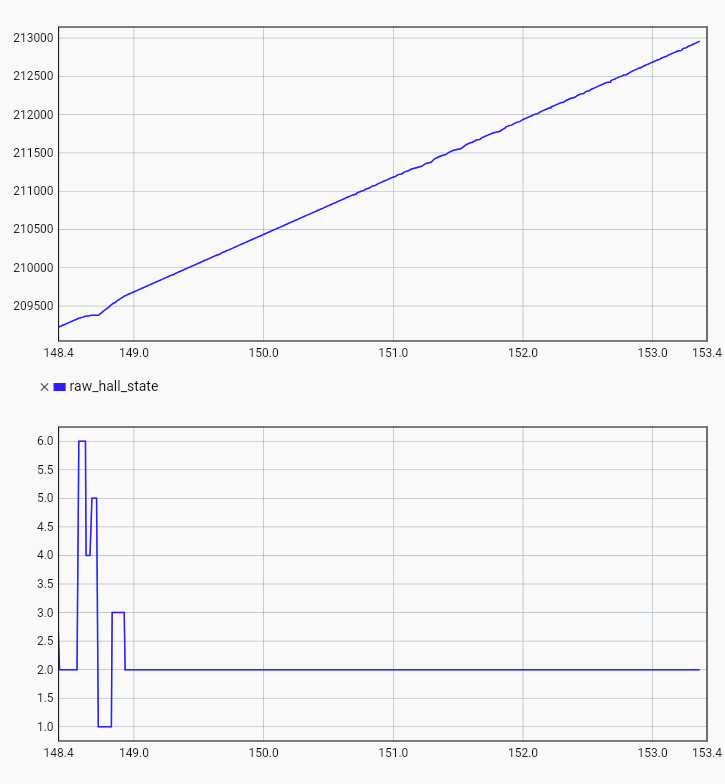

The image you showed of the hall states is also pretty weird. Was the image you showed with the motor not moving / ODrive in idle?
We had a hall-related bug but that was fixed in 0.6.11 (which it seems you’re running). Could you try downgrading to 0.6.10 and seeing if this issue persists? You’d likely run into the bug when actually running the motor, but if hall behavior seems reasonable at low speed / when turning the motor by hand, that could definitely indicate some sort of regression. Very weird though that this hasn’t shown up with any other customers.

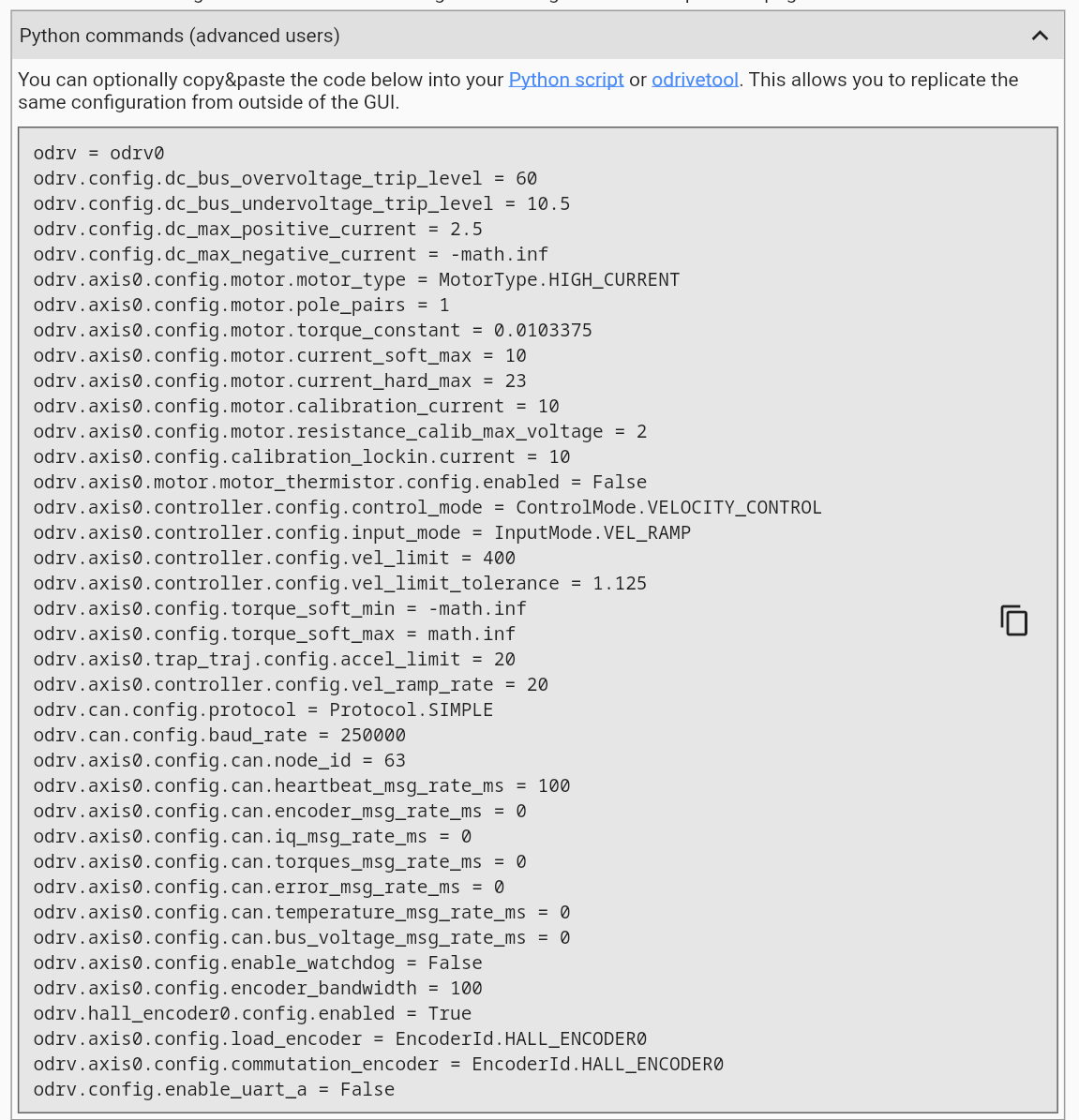

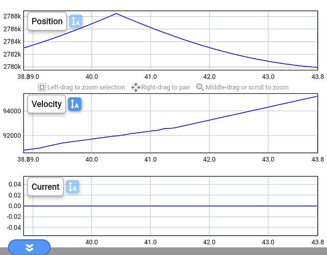

I have the same issue that you are describing. I’m also on 6.11.0.
Here are some plots:
Have you been able to resolve this by downgrading to 6.10.0?
edit: I downgraded to 6.10.0 and it seems to have resolved this issue.
Hi @dobFHR01 (and @awkeller ) – I think we found a temporary workaround for this bug, until we can implement and merge a full fix. Try increasing the stated number of pole pairs, e.g. by a factor of 10. Your position and velocity estimates will be 1/10th of actual, but it should resolve this bug.
sweet! that worked very well. getting clean control after playing with the gains a bit. thanks for helping out!
