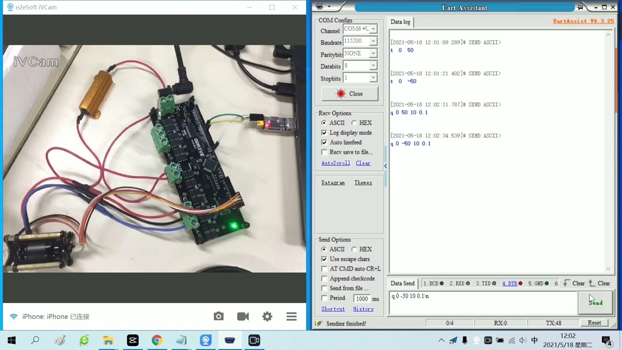

this one bro
I do the same way, the commands begin with t p q can work normally, other had no response, particularly I would need the velocity command to run the skateboard in normal mode and torque mode for brake.

There was a bugfix - you should run 0.5.6. Also - feel free to join the ODrive Discord, might be faster to communicate there: ODrive
I tried the t, p, q commands, they responsed well, but no response for the command begins with c, v, also f motor
still no idea yet, is there any thing to do with the firware version or type of motor?
my version was 0.5.1, 2 pair pole hall sensor motor.
