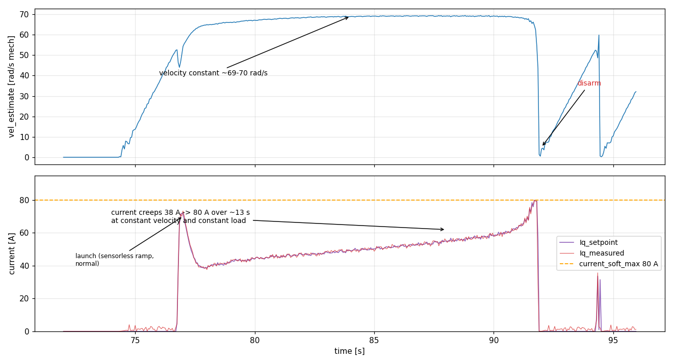

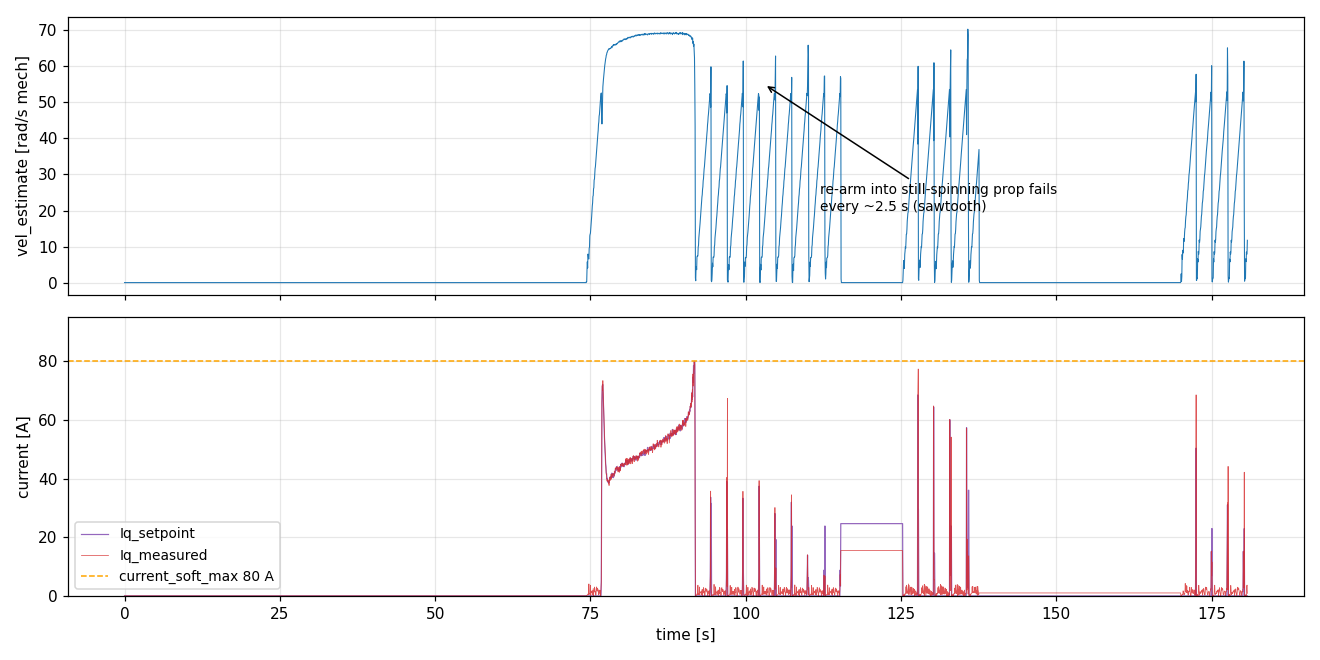

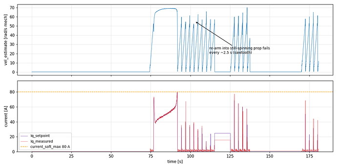

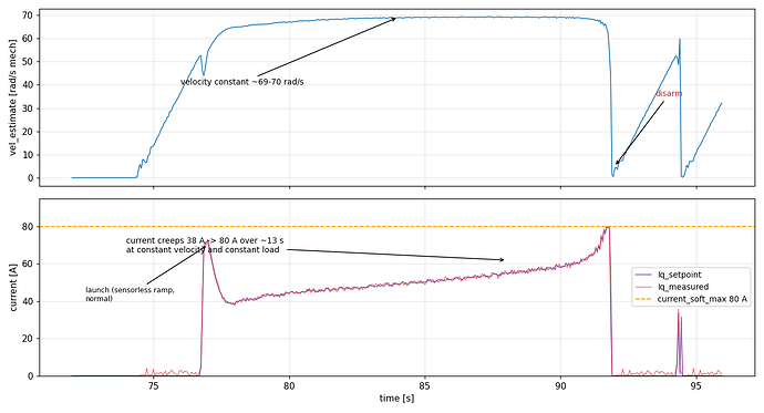

Motor current creep to current_soft_max at constant velocity under load, sensorless T500 (ODrive Pro 0.6.12)

Symptom Description:
Graph 1 → one sustained run: the sensorless ramp launch is normal, velocity settles at ~69-70 rad/s mech (~11 turns/s) and stays constant, but Iq_setpoint and Iq_measured creep together from ~38 A to current_soft_max (80 A) over ~13 s with no change in commanded velocity or load; on touching the clamp the axis disarms with DC_BUS_OVER_REGEN_CURRENT / CURRENT_LIMIT_VIOLATION.
Graph 2 → the full session: after each disarm, closed-loop requests issued while the propeller is still spinning down trip the same errors every ~2.5 s (the sawtooth), while a fresh ramp launch from standstill succeeds — and then the same creep repeats.
Steady-state load at this speed is the ~38-40 A seen right after launch, so the creep is not load growth.
