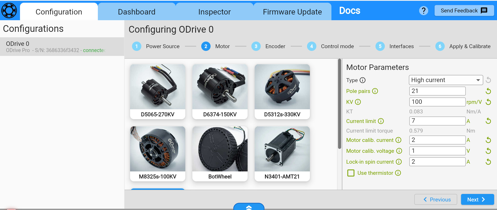

Hi everyone, I am using a 21 pole pairs motor. I am constantly getting an error saying: Procedure error POLE_PAIR_CPR_MISMATCH. It looks like Motor > Pole Pairs should be 22. Please consult your motor datasheet and update the configuration.
When I recalibrate the motor, it gives me error saying Procedure error POLE_PAIR_CPR_MISMATCH. It looks like Motor > Pole Pairs should be 20.
After recalibrating it couple of times, it works. Any idea regarding why does this keeps happening?
Thank you so much in advance!

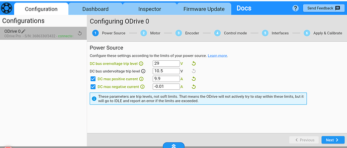

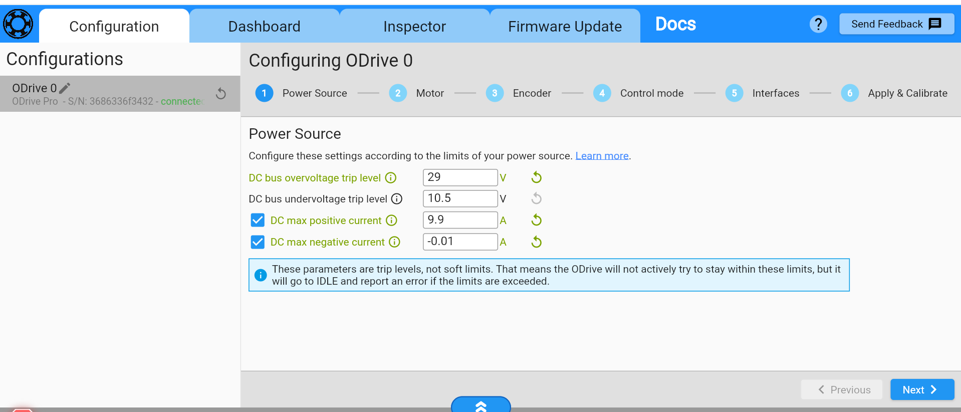

What motor and encoder are you using? Can you share your configuration in the GUI, specifically on the motor tab?
Yes, I am using Tmotor U8, and AS5047D encoder. Thank you so much!

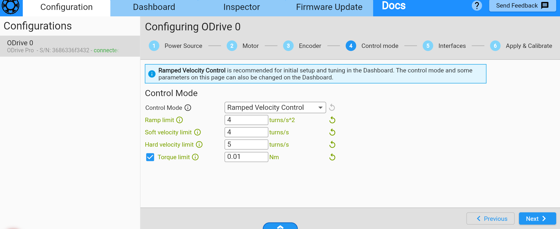

Your current limit and calibration current/voltage is very very very low, and your torque limit is miniscule (this will limit the motor to 0.12A). When lock-in spin current is low, the motor won’t be able to turn smoothly during calibration, leading to your error. I would use the following values:

You will additionally need to raise your torque limit, or disable it, in order to get good control in closed loop mode, otherwise the motor will be too weak. A torque limit of 2.481 Nm will correspond to the motor’s maximum current of about 30A.

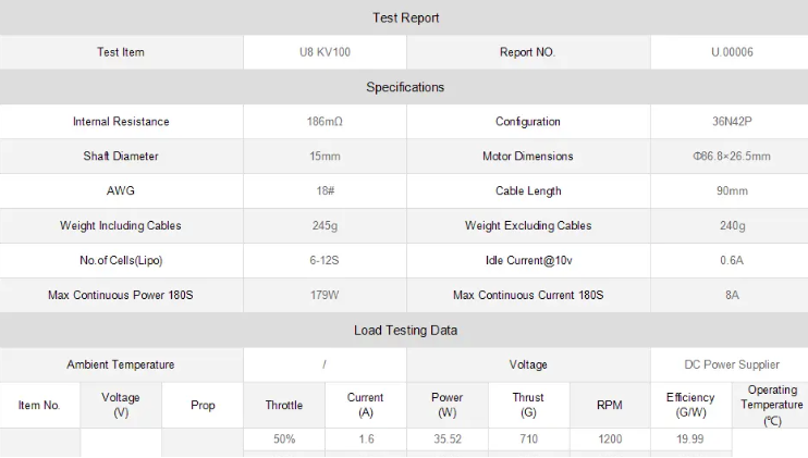

Hii, my motor’s max continuous current is 8A. I am using the Tmotor U8 100Kv, older version. I am bit confused, won’t it be an issue if I set the current limit higher than that?

Hi, I think they discontinued the model, I am unable to find the link from original website but the below link is from a different website:
I have attached a picture of specifications:
Ah - understood, so that’s a totally different motor. In that case, you can set the current limit to 8A, and also set calib current and lock-in spin current to 8A.

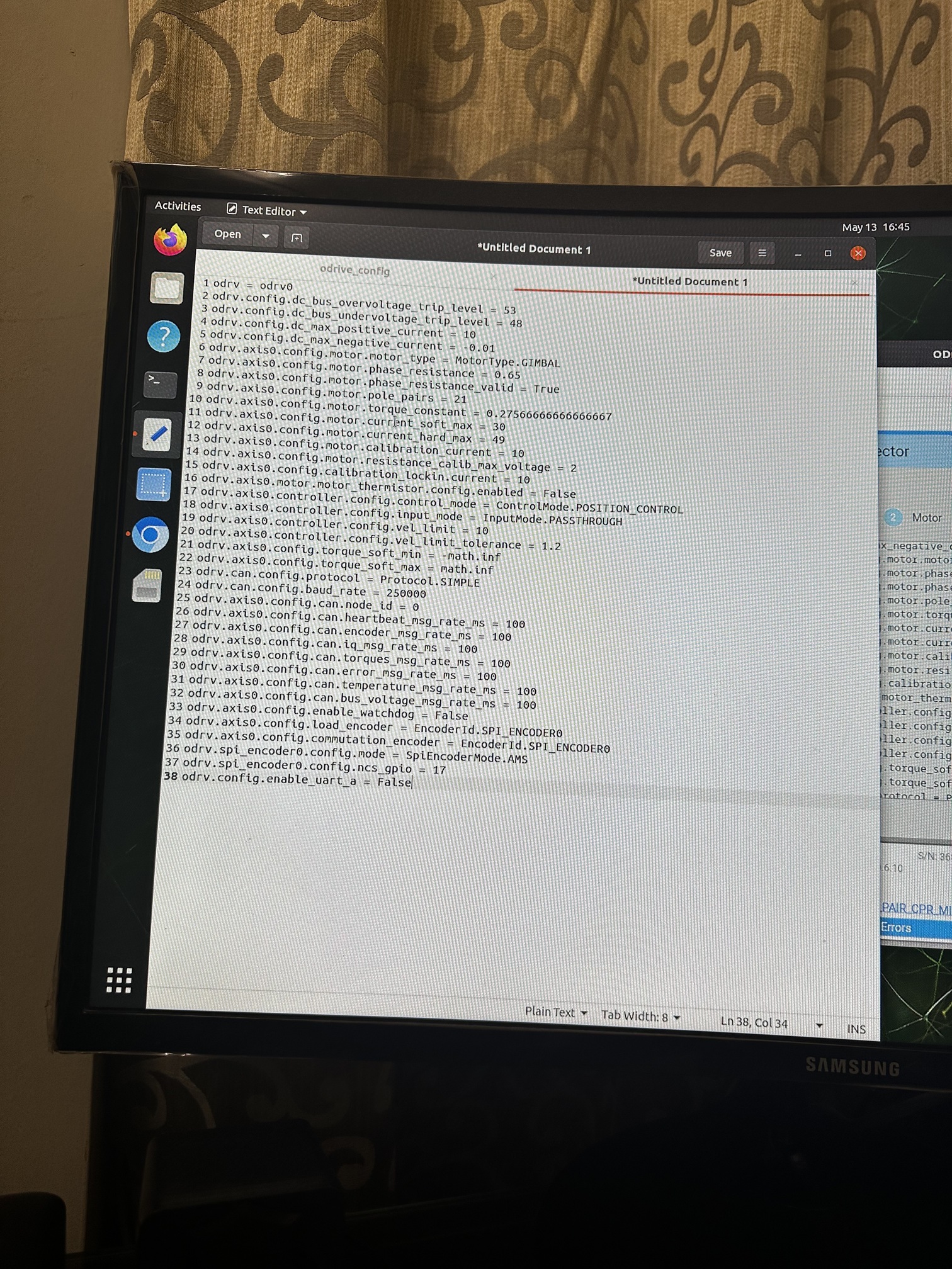

Below are the applied configuration details:
odrv0.config.dc_bus_overvoltage_trip_level = 50
odrv0.config.dc_bus_undervoltage_trip_level = 48
odrv0.config.dc_max_positive_current = 8
odrv0.config.dc_max_negative_current = -0.01
odrv0.axis0.config.motor.motor_type = MotorType.GIMBAL
odrv0.axis0.config.motor.phase_resistance = 0.65
odrv0.axis0.config.motor.phase_resistance_valid = True
odrv0.axis0.config.motor.pole_pairs = 21
odrv0.axis0.config.motor.torque_constant = 10 / 30
odrv0.axis0.config.motor.current_soft_max = 6
odrv0.axis0.config.motor.current_hard_max = 8
odrv0.axis0.config.motor.calibration_current = 6
odrv0.axis0.config.motor.resistance_calib_max_voltage = 8
odrv0.axis0.config.calibration_lockin.current = 6
odrv0.axis0.motor.motor_thermistor.config.enabled = False
odrv0.axis0.controller.config.control_mode = ControlMode.POSITION_CONTROL
odrv0.axis0.controller.config.input_mode = InputMode.POS_FILTER
odrv0.axis0.controller.config.vel_limit = 10
odrv0.axis0.controller.config.vel_limit_tolerance = 1.2
odrv0.axis0.config.torque_soft_min = float(‘-inf’)
odrv0.axis0.config.torque_soft_max = float(‘inf’)
odrv0.axis0.controller.config.input_filter_bandwidth = 20
odrv0.can.config.protocol = Protocol.SIMPLE
odrv0.can.config.baud_rate = 250000
odrv0.axis0.config.can.node_id = 1
odrv0.axis0.config.can.heartbeat_msg_rate_ms = 100
odrv0.axis0.config.can.encoder_msg_rate_ms = 100
odrv0.axis0.config.can.iq_msg_rate_ms = 100
odrv0.axis0.config.can.torques_msg_rate_ms = 100
odrv0.axis0.config.can.error_msg_rate_ms = 100
odrv0.axis0.config.can.temperature_msg_rate_ms = 100
odrv0.axis0.config.can.bus_voltage_msg_rate_ms = 100
odrv0.axis0.config.enable_watchdog = False
odrv0.axis0.config.load_encoder = EncoderId.SPI_ENCODER0
odrv0.axis0.config.commutation_encoder = EncoderId.SPI_ENCODER0
odrv0.spi_encoder0.config.mode = SpiEncoderMode.AMS
odrv0.spi_encoder0.config.ncs_gpio = 17
odrv0.config.enable_uart_a = False
odrv0.axis0.requested_state = AXIS_STATE_MOTOR_CALIBRATION
#SPI calibration
odrv0.axis0.requested_state = AXIS_STATE_ENCODER_OFFSET_CALIBRATION
Closed - loop
odrv0.axis0.requested_state = AXIS_STATE_CLOSED_LOOP_CONTROL
odrv0.save_configuration()
odrv0.reboot()
Using below for checking position change.
print(odrv0.axis0.pos_estimate)

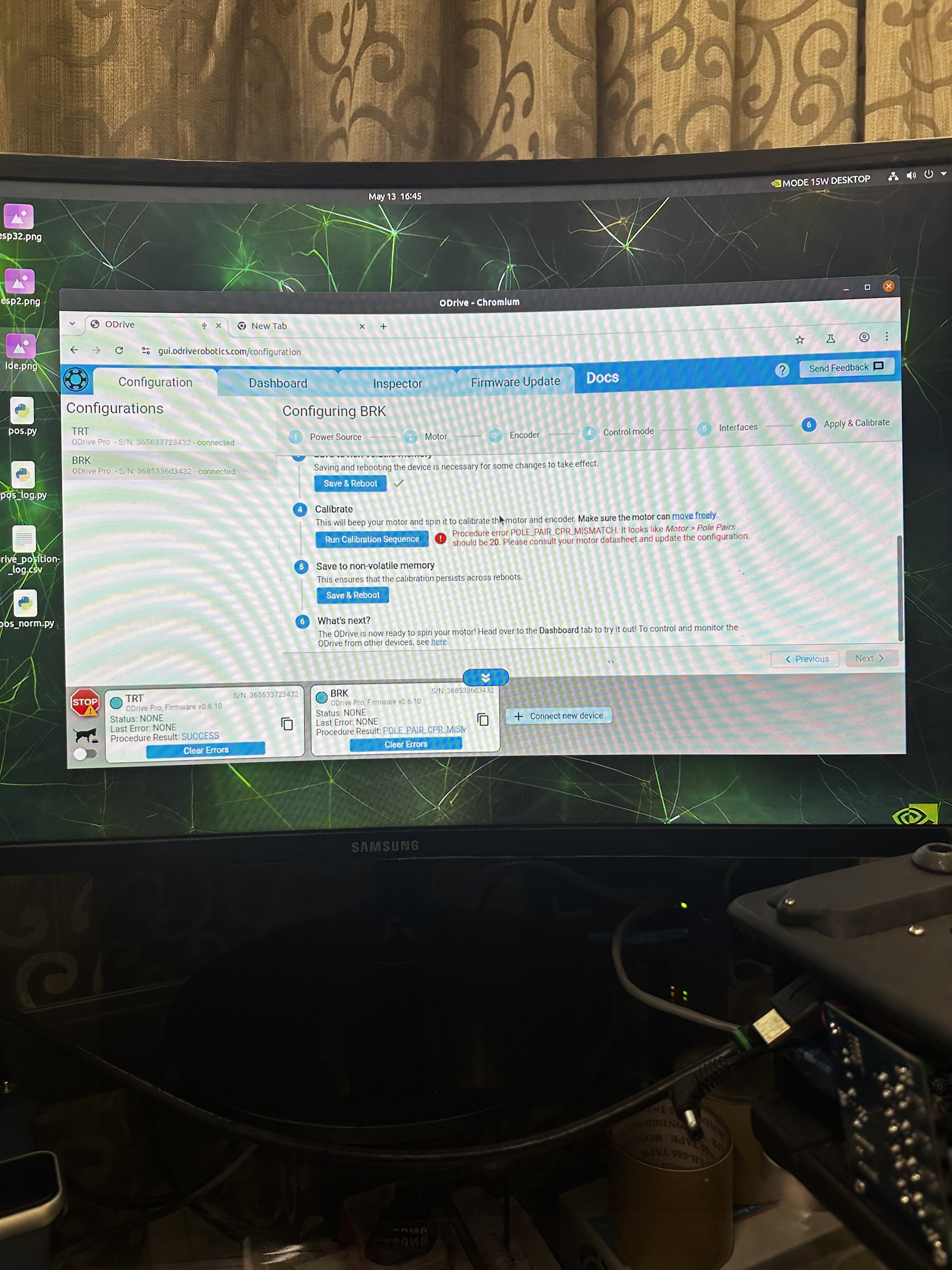

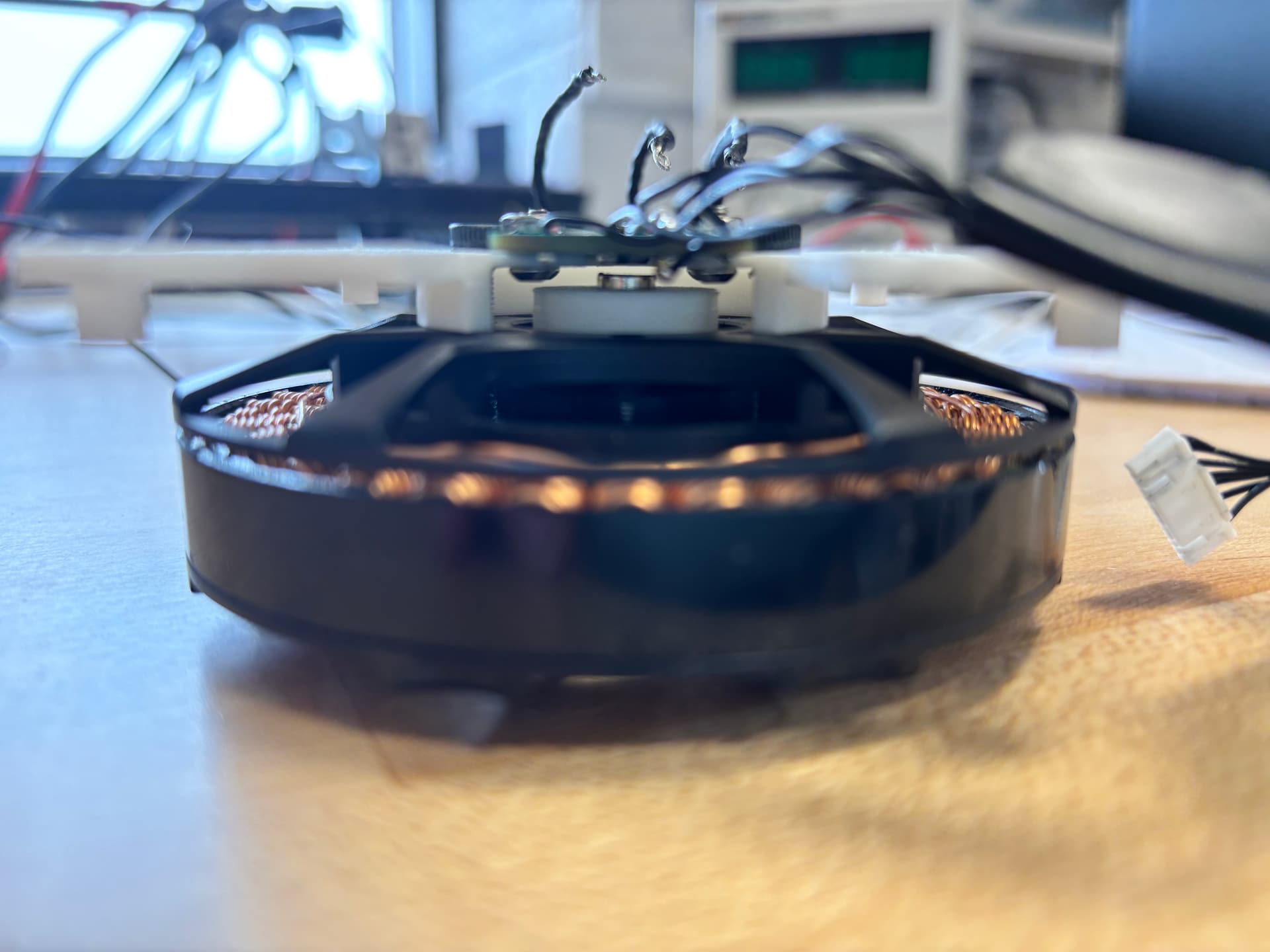

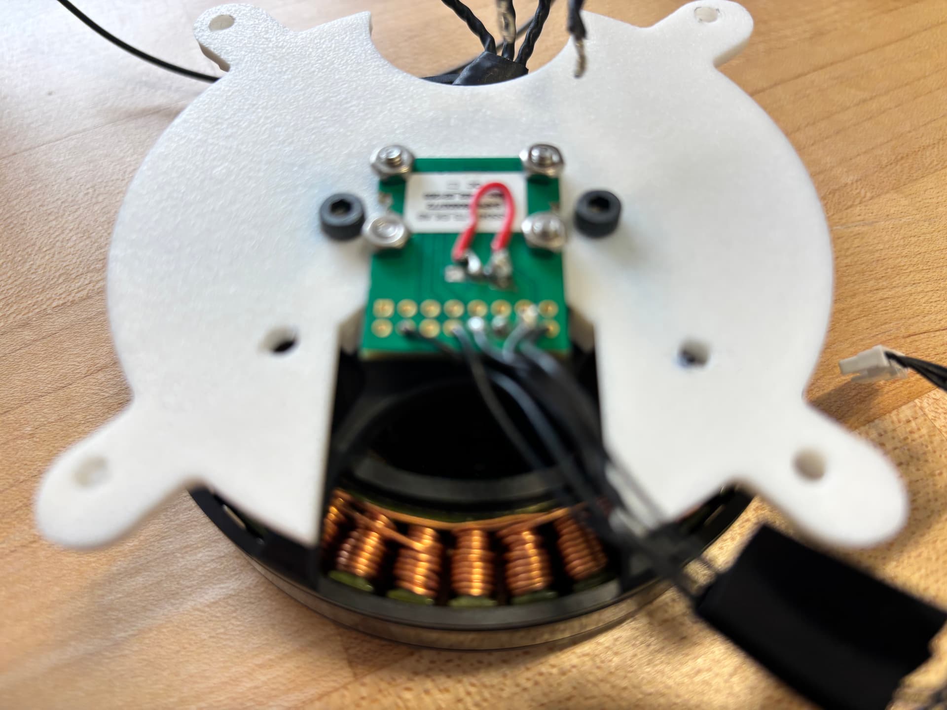

Hi, I am getting the same error again, It worked before when I increased the calib current and lock-in spin current. But now it shows the same error again, I am not sure why is this happening.
I would really appreciate the help. Thank you!

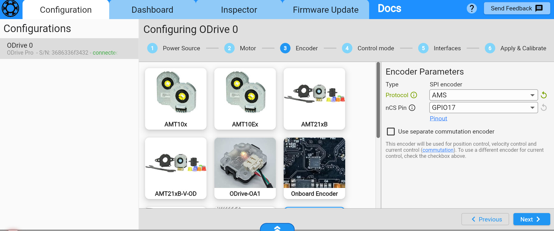

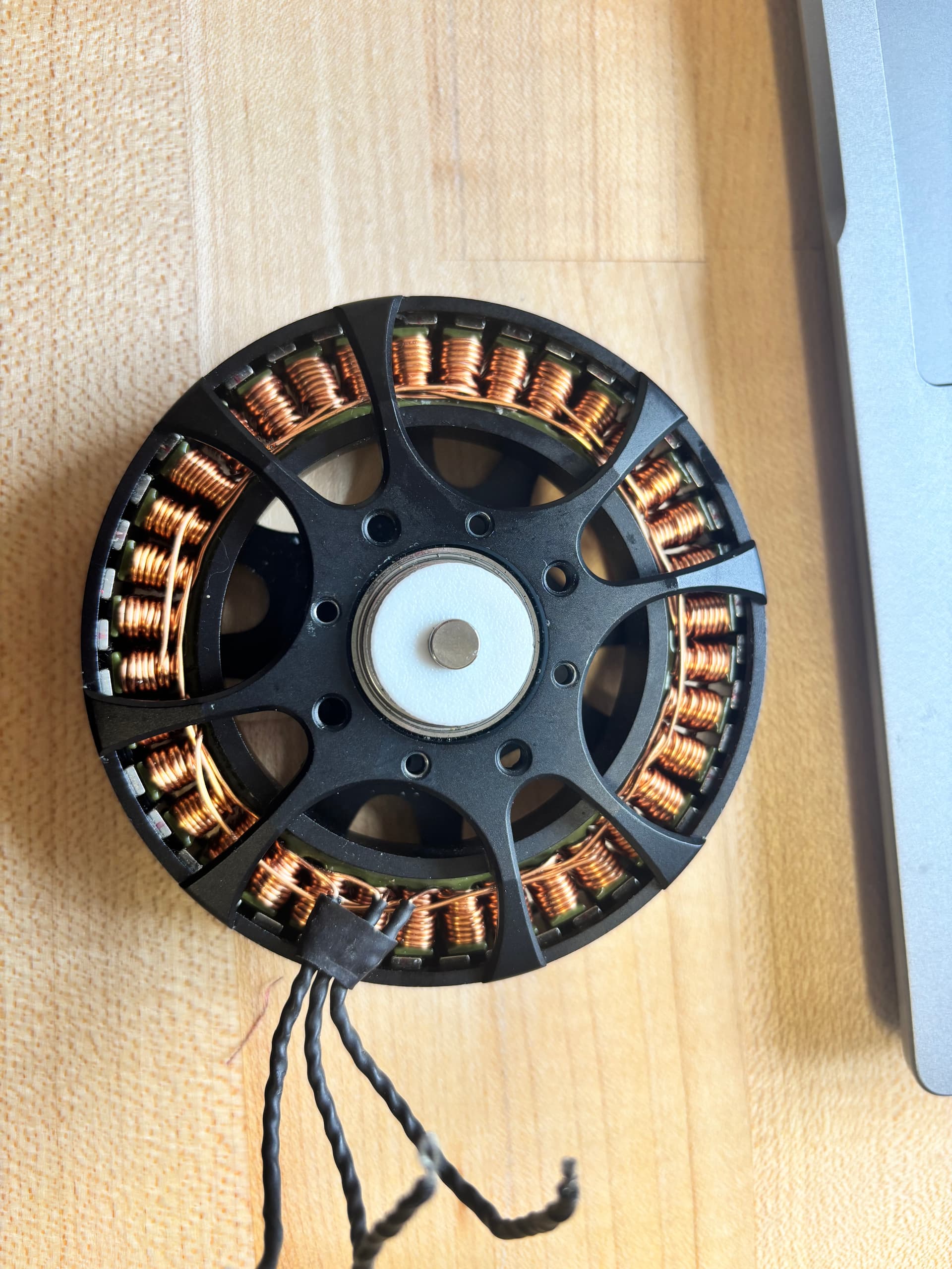

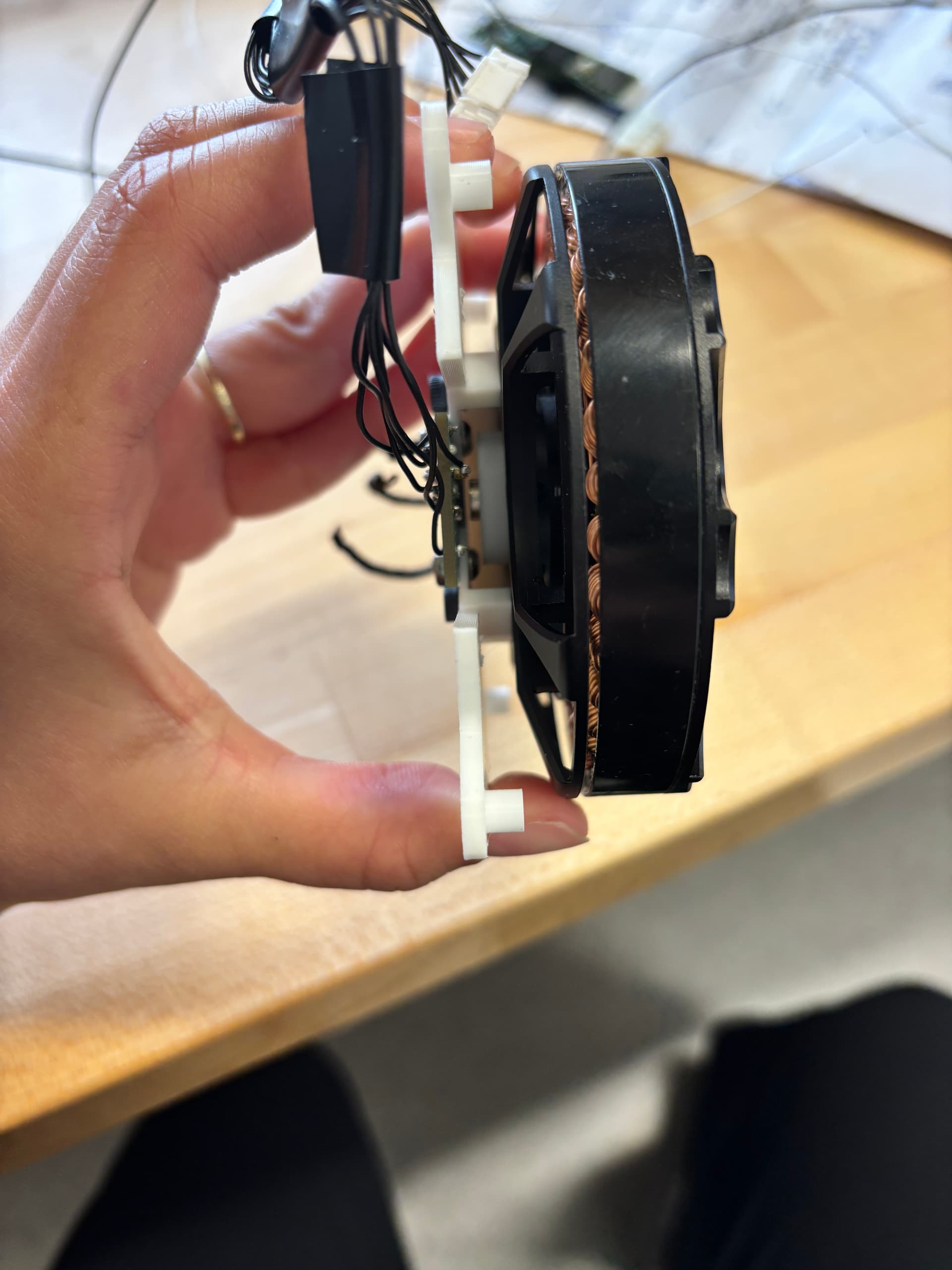

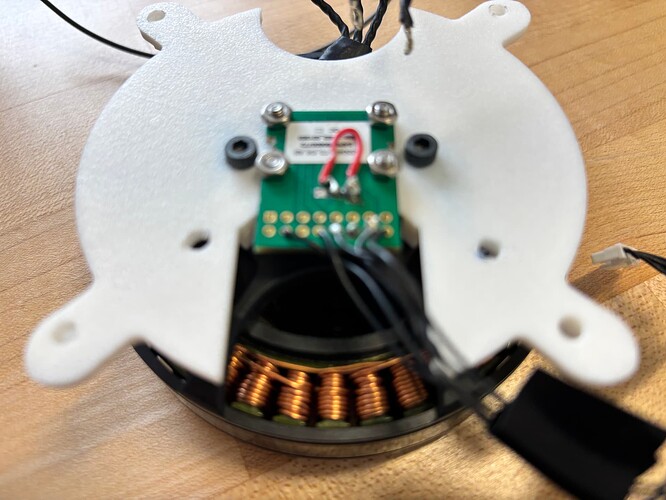

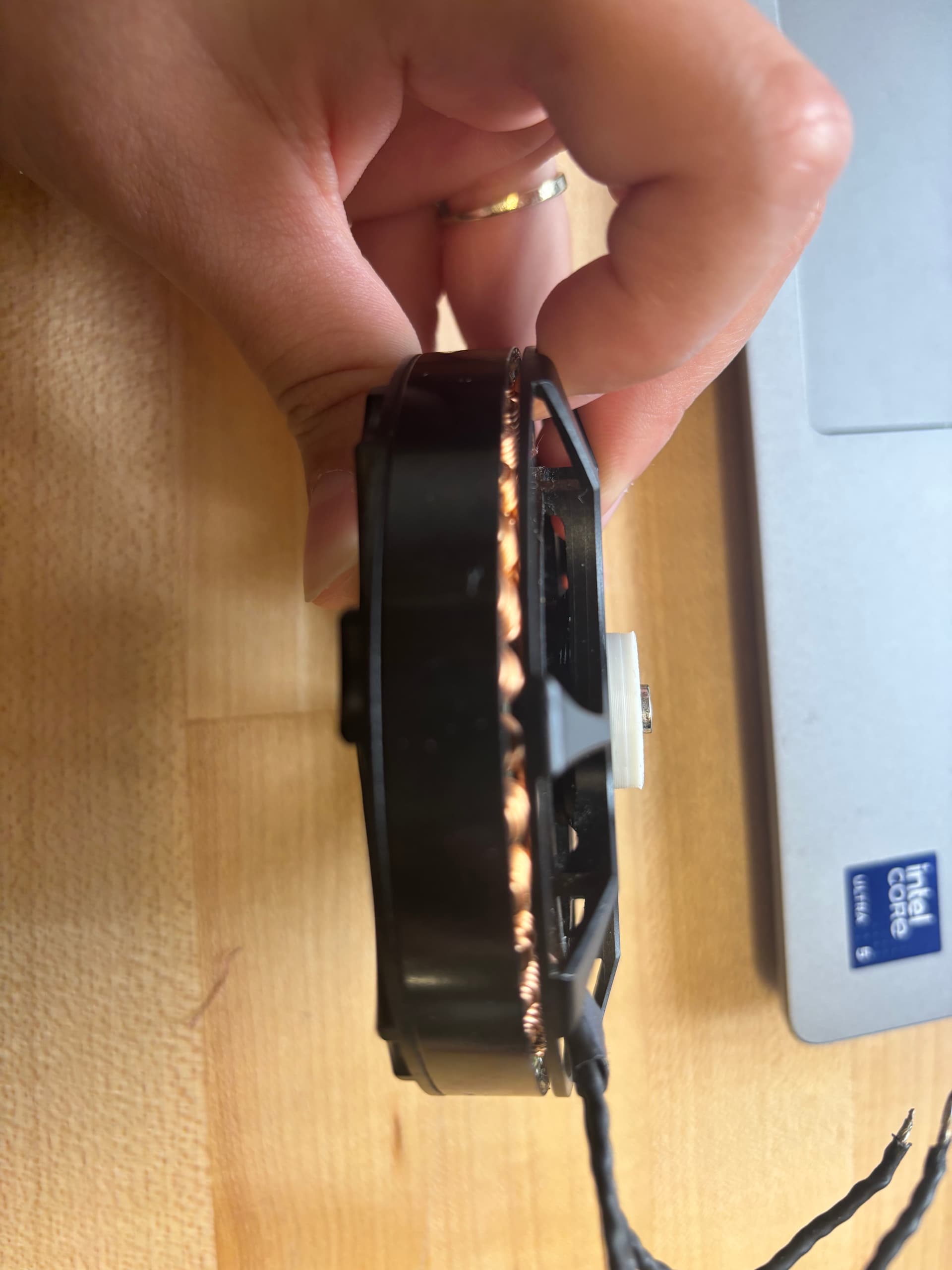

Good chance this is due to encoder magnet misalignment. Could you post a picture of how the encoder is mounted above the magnet, and how the magnet is mounted to the motor?
Hi, yes, I have attached the images below.
Thank you so much!
Ah – yeah $20 says this is an encoder mounting issue. Those magnetic encoders really need to be perfectly aligned to the magnet – usually I target +/- 0.5mm, see more here Designing for Magnetic Encoders — ODrive Documentation 0.6.11 documentation
Harmonic calibration is designed to help compensate for offsets, I don’t think we’ve tested it with AMS encoders but I’d expect it would work.
I would recommend, after running step 3 in the configuration flow (the “save to non-volatile memory”), go to the inspector tab, and manually run (by setting the requested_state parameter):
  • MOTOR_CALIBRATION
  • HARMONIC_CALIBRATION
  • ENCODER_OFFSET_CALIBRATION
Then (assuming everything worked) you can go back to the configuration tab and run step 5 (to save the calibration).
I’ll try reducing the distance between the encoder and the magnet and also calibrating it manually. Thank you so much!
No worries, please let me know how it goes!
